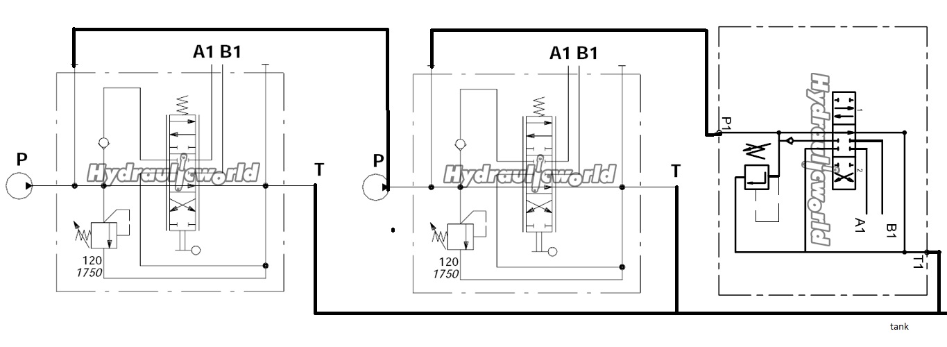

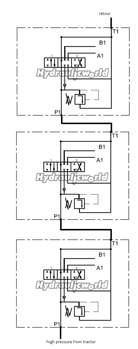

Hello,
I have a question about a hydraulic valve.
can i put more seperate valves together at this way you can see in the picture?
I hope you can help.
Wilco

/ question about hydraulic valves #2
You can, but you run the risk of damaging the valves. You should have a PB port on all valves except the last valve.
All tank ports should go to tank.

/ question about hydraulic valves #4
Some valves have a Power Beyond port (PB port). This is so that you can gang valves. The first valve has priority. If it does not need the flow, the fluid goes to the next valve. The valve needs to be designed to do this (needs to have a PB port).

/ question about hydraulic valves #5
WilcoKubota; said:
what do you mean by PB port?
Wilco.
PB means just that. Power Beyond to the next valve. In an open center hyd circuit, all valves are in series. This port with a PB adapter will send pump flow or Hyd power for the next valve. It has to be able to with stand full pressure, whereas the tank port only has about a 250 to 500 psi rating.
One of the reasons for the PB is to separate the pump flow from the cyl OUT flow.
In a multi valve situation, any valve can use all or part of the pump flow. Upstream valves have priority.
T or TANK means that this port should go to tank.
Look at the loader valve connection to the next valve, the PB from the loader valve is feeding the next valve, and the tank/return ports are tied together.
http://www.princehyd.com/Portals/0/products/valves/LvsInstS.pdf

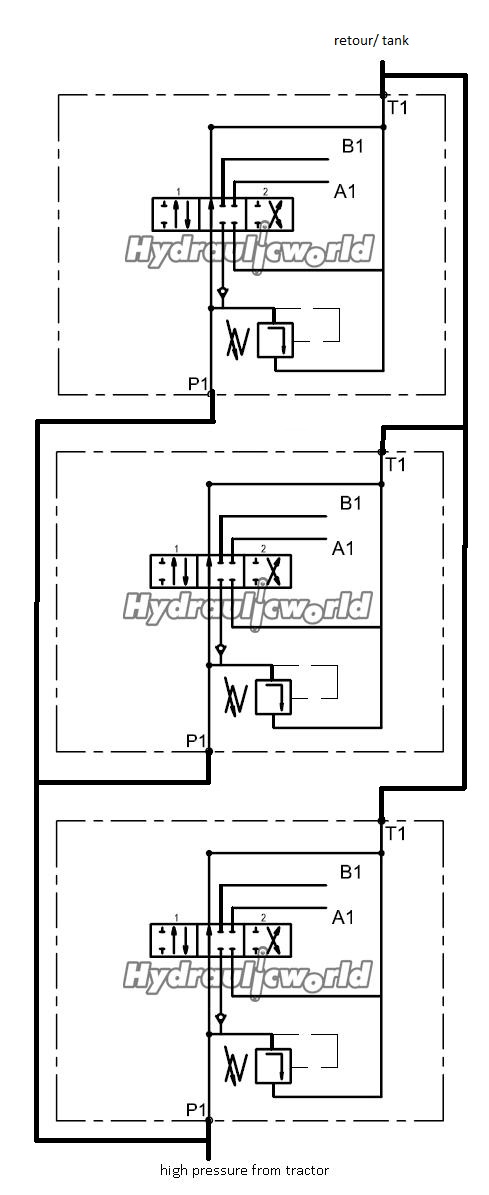

So, can I do it this way, with the same valve?
Wilco

/ question about hydraulic valves #7
Wilco
What kind of hyd circuit are you trying to accomplish, open center or closed center.
Open center valves are connected in series , and closed center valves are in parallel.
What are your design goals?
Is this for a tractor or some other hyd endeavor?
Certain valves can be used as open center, and open center with PB. with a PB sleeve, or a closed center plug can be used to make the valve a closed center hyd system.
This valve can be converted as an open center, PB, or closed center valve.
http://www.princehyd.com/Portals/0/products/valves/Series20InstS.pdf

Its for a FEL, so only if they have a PB port i can connect it like this:
Wilco.

/ question about hydraulic valves #11
Wilco.
Look at the schematic at the bottom. The flow has to go through the valve and then go to another valve IN port.
http://www.surpluscenter.com/Instruct/I9- 7863.pdf
Do you need float or regen?

/ question about hydraulic valves #13
That is fine, but if you have a 3pt on the tractor, you will need PB on that three spool valve.
If that is the only valve you will use, it does not have to be PB.
/ question about hydraulic valves #15
Yes, that is your supply for the 3pt valve and the 3pt dumps to tank. The OUT port of the FEL valve should go to tank.

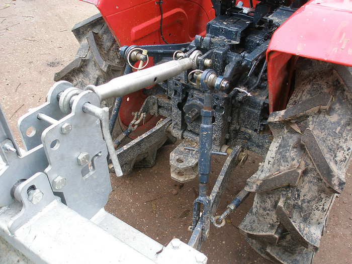

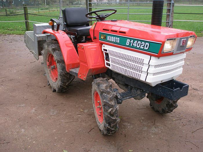

I already have one double action valve at the back. i think I've got a picture of it..
you can see it between the wheel and the top link, at the 1th picture.
I want to make the valve above the brake shield (I don't know the correct name.), at the 2nd picture.
Wilco

/ question about hydraulic valves #17

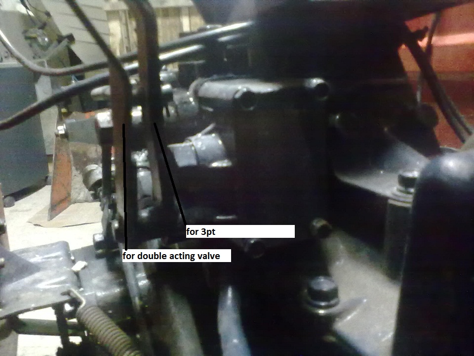

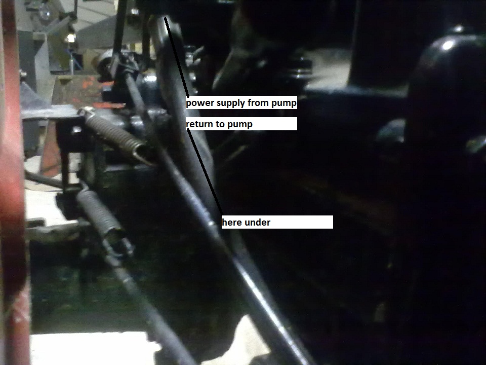

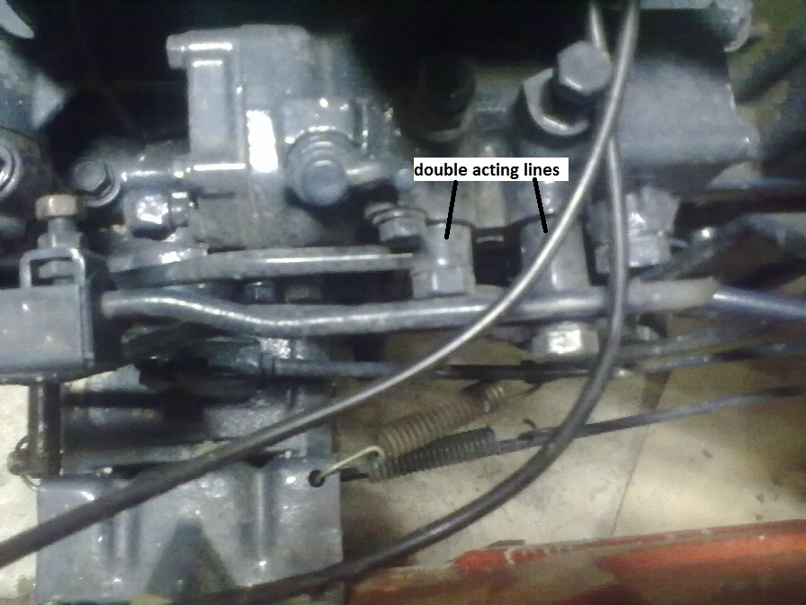

Can you provide a description of the hyd flow as it is now.
A basic tractor comes with a 3pt, so the pump flow only goes to the 3pt. It may do this through a hyd block at the middle of the tractor, or direct. You may also have a switch to switch the flow from 3pt to something else.
You said something about a valve. I only see two lines that are capped. Is there a valve for those lines?
I have a Kubota B9200 HST, and the pump flow goes through a hyd block and to the 3pt in one position of a switch, and if I switch the flow, it goes to a rear remote first and then to the 3pt. If I am not using the rear remote, I plug the two hoses together.

No, its a built in valve, the lines at the picture are to a quick male connector. I'ts an old picture because i have now female connectors on it.

I have it this way:
Wilco
