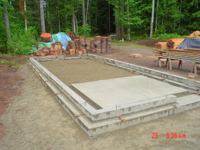

I am wanting to build a 20x40 concrete pad 4" with a metal roof only, no sides. What kind of foooting do I need around the peremiter? 12"X12", 18"x18"?
I am in east Texas so no frost/freeze. Does anyone here know?

What kind of soil? Compacted or loose?
   / Question about footings #3
The footing size would be determined by the loading.:D

It's a hard sand, not red sand the yellow sand. Loose sand will get very hard here after a good rain. So sand/clay.

With "no sides" on your structure all the weight will be bearing on your posts,right? If that be the case,you do not need a perimeter footer.

Posts in the ground or on the slab?

It should depend on the two above. I just poured a 12ft X 28ft foundation a couple of weeks ago and we went 18 inches wide based on the soil and building load.

Just curious, what is the slab inside the one end of the footing for?
