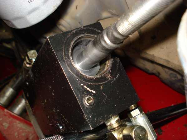

I'm fixing blown seals in my accumulator today and would normally call Terry about this one -- but it's Saturday and they're not around.
I've attached a photo of where I'm at -- I've removed the big spring and the seal fitting. What you're looking at is the piston. Which doesn't budge when I pull on it.
Hence my question for somebody who's pulled this unit apart. Should I just pull harder, or should I be relieving hydraulic pressure, or is there a retaining nut I should be removing, or... what?

I did not know that PT's had accumulators. It looks different than most accumulators that I have seen. What part of the circuit is it used? Accumulators store the hydraulis oil under pressure until it is needed. In some accumulators, there is a large spring, some have a diaphragm and in others, there is a nitrogen filled bladder. I would be very careful about taking that unit apart. It may have to be put in a jig, so when you release the bolts, the jig will allow the unit to seperate slowly. Let us know how this works out , and take pictures of the parts.
/ Question about disassembling the accumulator #3
I forgot to add that the fluid usually goes in one fitting, and comes out the same fitting. If that is just a plunger, I would think that you have to open the source of the fluid to relieve suction. If this is true, you will not be able to pull the plunger out, unless something is defective. About the only thing other than leaking that could go wrong on an accumulator is the nitrogen bladder burst, or the spring collapses .

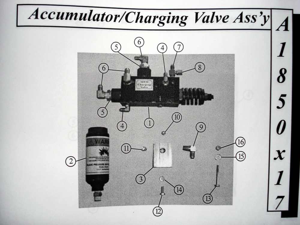

Yep, it's really an accumulator. Here's the next picture -- I shot a photo of a page out of the manual.

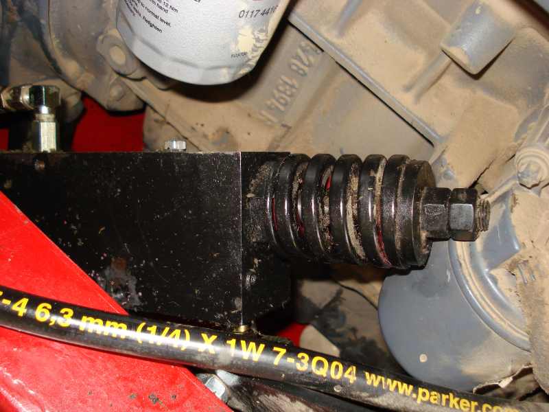

You're right, it's got a huge spring. Here's a picture of it before I've done anything (except unbolt it from the side of the PT).

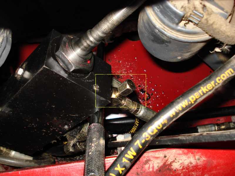

And here's the next picture. I've highlighted a little nipple fitting. It's a lot like the one that we use to bleed the air out of the hydraulic system after we've replaced the filter, but this one is on the bottom of the accumulator.
I'm starting to think that opening this up would release the suction in the accumulator and I could pull that piston out. Whatcha think?

What does your manual call item # 2 in the picture? Do you know what your accumulator is used for. Is it used to charge the tram pump, or to activate the hyd brakes?
That fitting that you discribe, sounds like the fitting used to test the pressure on the charge circuit.
They call #2 "Accumulator"... I'm not messing with that, I'm fooling around with the gizmo up at the top of the page, they call that the "Charging Valve".
Beats the heck out of me where this thing is in the circuit. The !@#$%^!!! manual is completely unhelpful -- just page after page like this one with terrible photos of components, with parts lists underneath. Don't get me started...

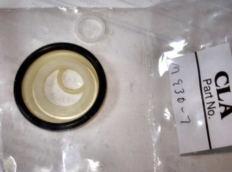

I'd put it in the middle of that "a little" to "a lot" spectrum. Introducing a new term, I'd call it "mop-able". I isolated the leak to the charging pump, talked to Terry about it, further isolated it to the pump itself rather than the little nipple fitting, and he sent me a rebuild kit for the valve assembly. The conversation went like this;
Terry; "the oil appears on the nipple?"
Mikey; "nope, it's showing up on the spring on the valve."
Terry; "Ah, you've blown the seals in valve, I'll get a rebuild kit to you on UPS."
So I think this happens with some regularity.
I've put a picture of the kit on this post as an attachment -- the two biggest circles (black, and white) are O-rings, the next biggest is a seal, and the little ones are all O-rings.
Terry described what to do. He cautioned me to measure where the spring-retention nuts were BEFORE I took them off, so I could get them back in the right place -- they control the pressure. I imagine the "right" way to do this is put some kinda pressure meter on that nipple fitting, but he said "just put the nuts back where they were, you'll get within 100 pounds." <grin> A guy after my own heart.

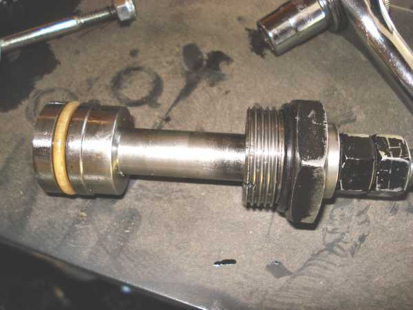

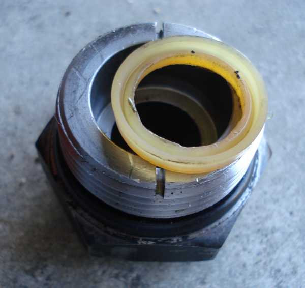

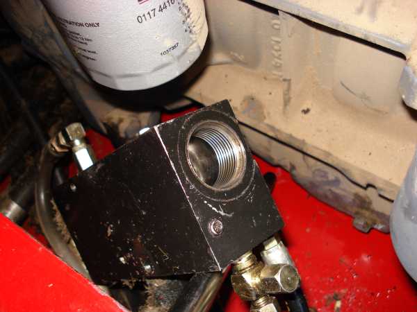

I talked to Terry on Monday -- "pulling harder" was indeed the answer. I wound up having to apply a fair amount of leverage, but evenutally it came out. The pictures of the valve and the piston show the two halves. I kinda reassembled the piston so's to get something (that big fitting on the right) to apply leverage to. See that white O-ring on the left side of the piston? That was a complete pain to replace -- getting the old one off wasn't bad, but putting the new one on was beyond me. I finally had to take the thing into Big Bruce the Mechanic at the implement store and have him pop it on with his Crusher Hands.
Third picture shows the seal that was probably the one that was actually leaking. Pretty amazing that it would fail, given that I've only got a couple hundred hours on the machine. But hey...
Put everything back together, fired it up, all good. Thanks for the suggestions gang -- sorry about the long delay in this followup post.

Mike , An old trick of mine is to put the o-ring in some warm hydraulic fluid for about 15 min, then you should be able to just roll the o-ring right on. A sandwich bag works good for this, as you don't get hydraulic fluid all over you hands.
#18
I've never had trouble with an O-ring before -- but that white one isn't stretchy rubber, it's more like plastic. Very little "give" at all. Does the warm hydraulic fluid soften it up?
