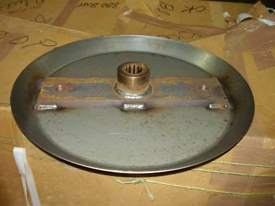

   / question about bush hogs #3
Here's one.
Some cutters don't have the circular pan, just the bar to mount the swinging blades.

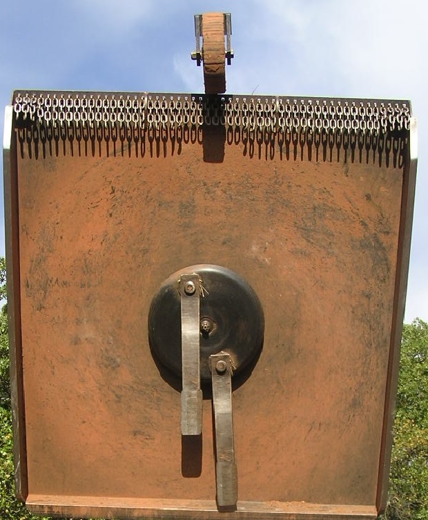

   / question about bush hogs #6
Here is the stump jumper on my 7' brush hog, with the sun shining on it:
