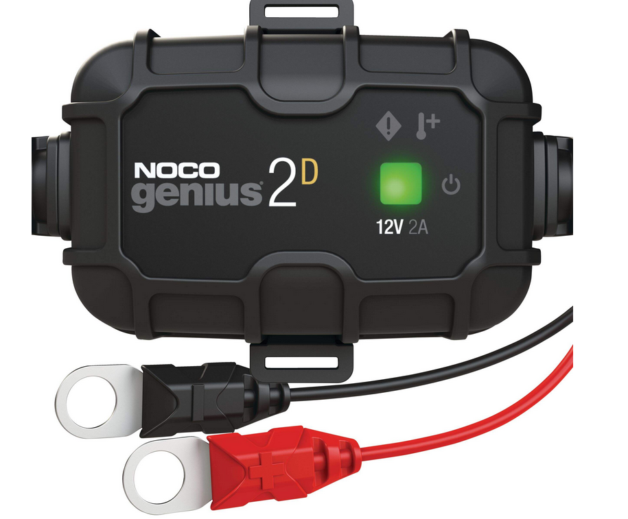

I've been buying NOCO Genius2D for onboard chargers, maintainer, desulfication as well.
They have many different sizes, some with multi banks, and on board ones come with eyelets vs clamps.
Well rated and haven't let me down yet. Oldest one have though is only about 2 years old?
Be careful with the high voltage desulfation maintainers. The high frequency ones can be used with the battery connected to late model computerized things and not hurt a thing.

A little on line research shows the NOCO Genius2D that we are using seem to put out pulses 6x / hr in the 13.2V to 14.9V range to desulfate the plates. Also says the charger doesn't float charge the battery but shuts off completely when voltage target reached.
Seems like this is safe range not near the 60v unsafe range.
Does this seem correct or should I get the boys to stop using them?
/ Quality on-board float charger? #10
As I recall I measured well over 20 volts when my NOCO spiked.
And I don't think that 13.3 to 14.9 volts would do anything to get rid of sulfation. If so, just driving my late model cars would automatically desulfate my batteries since that's normal charging voltages for them.

I've got a few of these Noco maintainers. I've never used the desulfator mode. I have no complaints and it looks like Nocos are not quite as much money.

The Noco 2d charger is also designed for on-board installation as a low amperage maintainer. Desulfates, temperature compensated, IP 65 rated (Dust tight, protection from water jets from any direction - so hosing it off is not a problem, but hitting it with a pressure washer - high pressure jet - is not good).
I have both, and have been happy with both models. I also have higher amperage chargers from both companies - all are excellent products.
