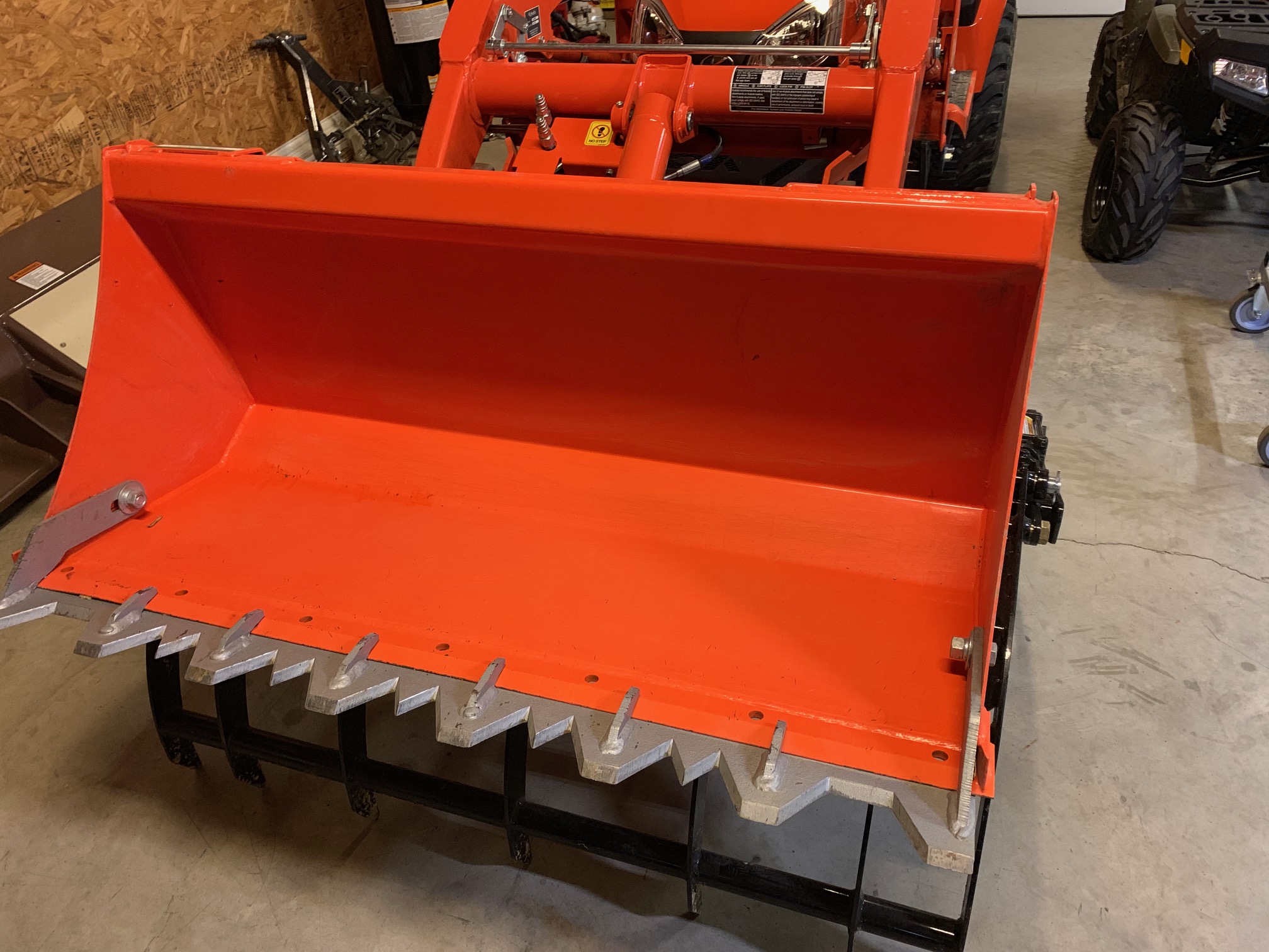

Just finished my job. TEN 80 lb bags (800 pounds) of Quickrete mixed up in the little BX bucket. Piece of cake. As soon as I finished the pour I drove over to my woods and dumped a tiny bit of leftover concrete out and drug the hose over, rinsed and not a singe grain of concrete in the bucket. Washes off super easy. No biggie at all, I highly recommend it.
Attached is a photo of the bucket sitting in my garage after I was finished. No evidence of 800 pounds of concrete being mixed in that bucket an hour earlier.
Not even a shovel scratch in that bucket!
Almost makes me feel bad for loading a pile of busted up concrete with mine today!
Ha ha....almost!
