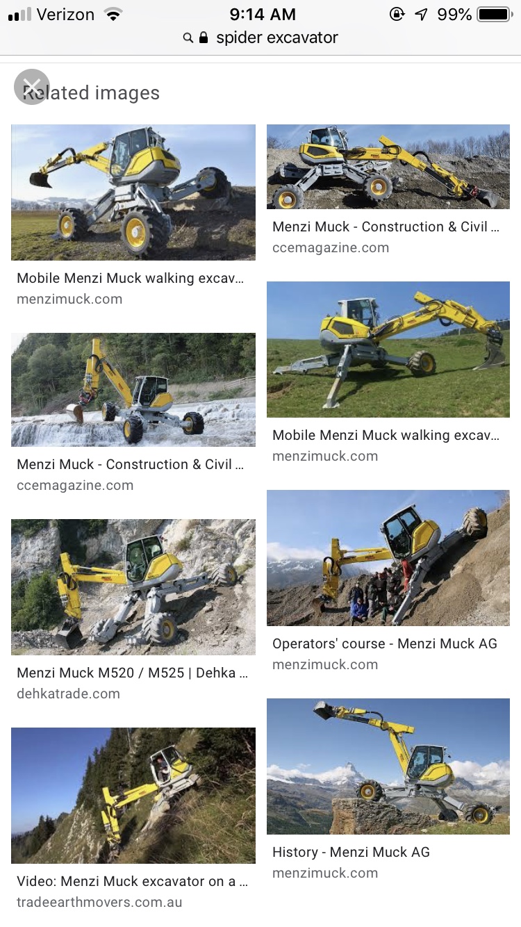

I’ve always been fascinated with the European firewood splitters. To be fair with the lower cost of other fuels firewood isn’t worth enough here to build stuff like that. The hill side excavator is really cool too. There’s nothing like that over here. View attachment 651577
The hillside excavator is 2 or 3 times the cost of a regular excavator that size

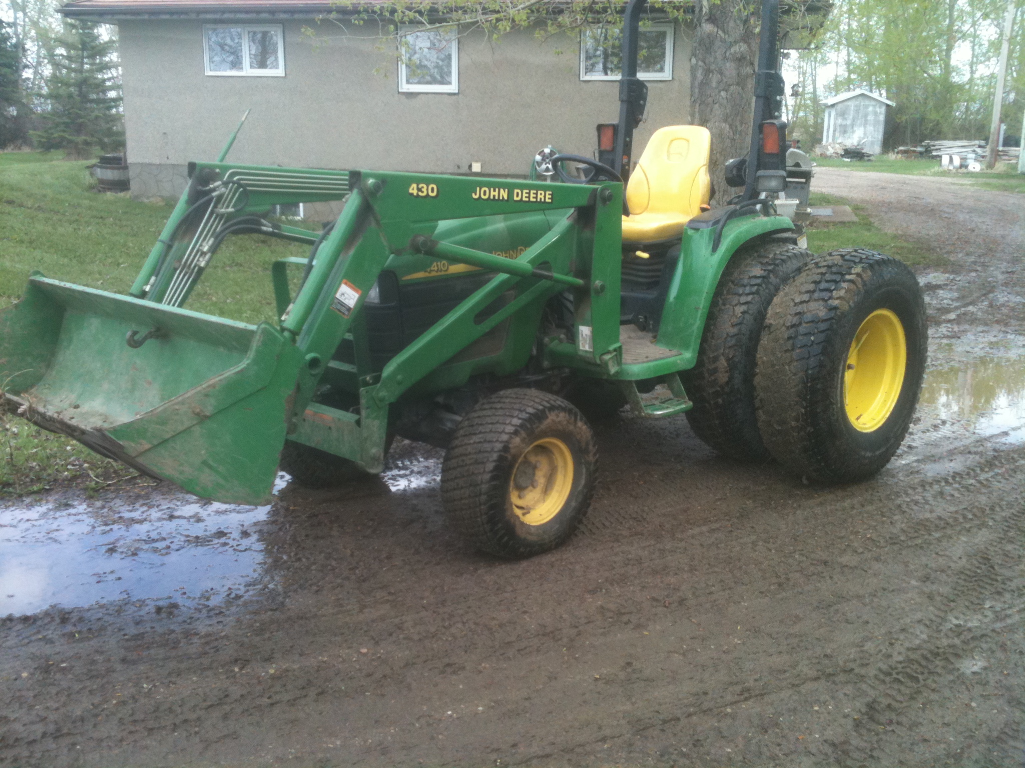

I was thinking of getting these but they only ship in three's! 20190312_103129.jpg
   / Putting the R1 vs R4 debate to rest? #69
Joe by 2 sets and put duals in the rear.:thumbsup::drink:
