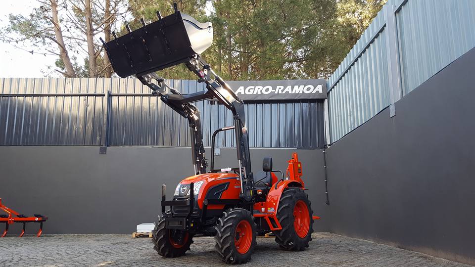

What about R1 radial tires? Better traction, better ride on and off road, wider tire also helping in stability.
About 90% of the tractors sold here, come with R1 Radials. From SCUTs to the big Ag boys.
And just make tractors looking very nice.

I have absolutely ZERO interest in appearance. I was hoping R4s would be less slick than turfs on my hills. They seem fine on dry ground or loose dirt. They're miserable on mud.
The purpose of them seems to be stiffness when lifting with the FEL or working the BH.

As I said, they provide a lot more than just appearance. Appearance is just a bonus.
Here, the tractors are used hard in ground engagement tasks. From plows, to cultivators, to discs, to rippers. All kinds of stuff. So traction is a must and that's why R1 Radials are used so much. Another benefit is the ride on hard surfaces as we do road our tractors a lot.
