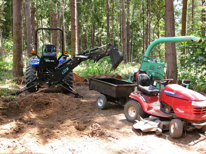

Loading up the trailer with the backhoe.

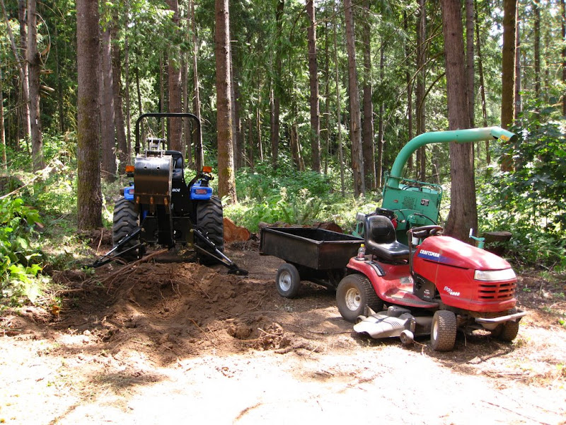

Another loading pic

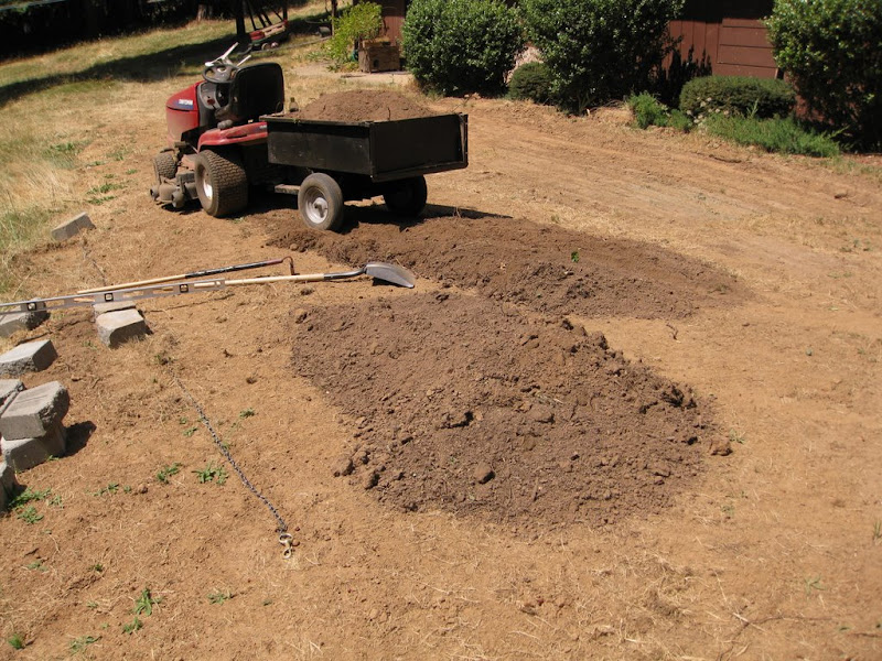

Getting ready to dump the third load.
Dumping the third load.
I did a total of 6 loads, with each load being a little more than 10 cubic feet. If I do my math right, that's about 7 yards, give or take.

Nice work! Looks like a good weekend project,not too big or too small. However, 60 cubic feet divided by 27 cubic feet/cubic yard is about 2 cubic yards in my book. I think you forgot the third dimension;):D

Yeah, I was thinking it didn't add up properly. lol. Too tired still, I guess. The hardest part was clearing out the forest where I got the dirt. I had it logged three years ago and it was covered in branches / tops. I probably spent a good 10 hours chipping, cutting, splitting, and stacking.
So, a little over two yards of dirt.... Let me see if my math is still bad:
18' long at 4" height, 15' away is zero height, 18' long. For easier math, make it 16' feet away. So, average is 4" at 8' x 18'. Or 1/3'x8'x18' = 47.5 cu ft. Bringing in 60 cu ft, I should have enough with some to spare, right?

Good start on this. Let us know how it works out. Hopefully you got it all hard packed down. I hope you watered it down a little every 4 inch of rise you did unless soil is really damp already. It helps to pack down better with no air pockets so wieght from water in pool won't make surface uneven. (dont make mud but wet it down so it can pack better)

That little cheap trailer with lawn mower has hauled close to 25 cords of wood. Before I got the bigger tractor, it's all I had to haul with. I'd stack it up high, and it took ~7 loads to get a cord in. I don't know what it's rated for, but green wood is fairly heavy, and I'm sure I exceeded its weight rating quite a few times.

I thought about using the loader to haul the dirt, but there are several problems with that idea not evident from the pictures. Where I was getting the dirt, it was solid and full of roots, and the loader couldn't dig it very well. So, the backhoe was required there just to loosen it up. With not much room to maneuver in the woods, I'd be doing a lot of forward and back just to turn around, and there are a few places I have to raise the bucket all the way up. With the ground so uneven, I really didn't want a full load in the FEL with it 8' off the ground. Also, the little trailer holds a little more than the bucket on the FEL. I'm hauling the dirt about 1/3 of a mile, so fewer trips is better. Finally, I got the wife to run the lawn tractor....
