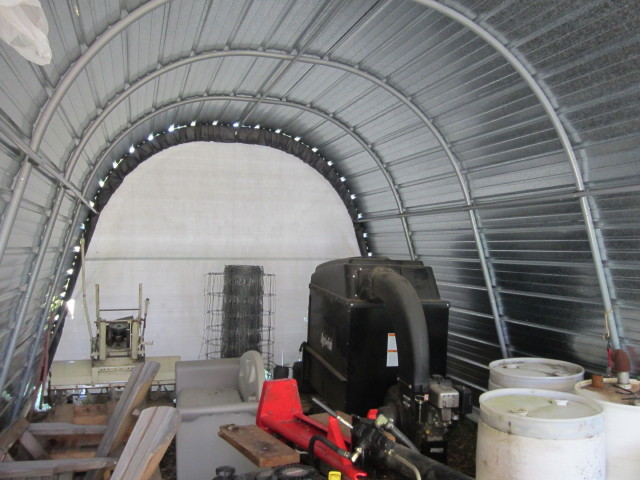

I have a larger version of that building and the fabric split down the middle after a few years. Install metal length wise and it makes the structure much stiffer and never had a issue.

I actually mentioned doing that, talking to the wife today, as an option if/when the fabric deteriorates. We actually have a fair amount of long roof panels (dark brown) left over from a roofing job on the rental. It would only take a few more panels to have enough to do the job.

Yeah, I know. Our small 10x10 has lasted a very long time but, the big one didn't. It almost looked like a flaw in the fabric. One chunk of it is now covering a pile of firewood...ha!

You will need to tighten the roof more, then snow will slide right off. You should slao anchor better than the SL screw in anchors you have. I anchored the first one to 4x4 posts driven into the ground 4'. The second one is anchored to a platform 12x20 2x8s cross ways on top of 4x4s run longitudinally.
