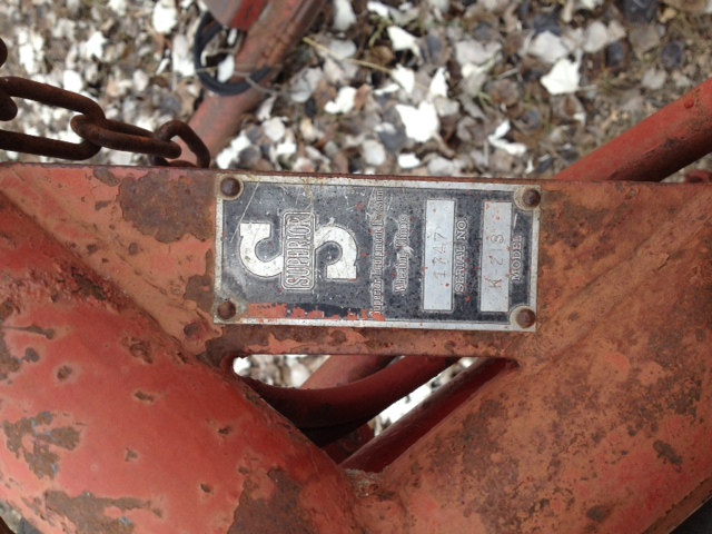

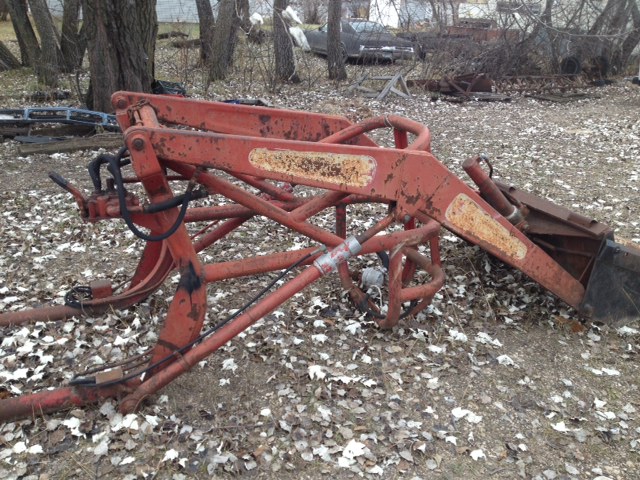

Well, here is an update if anybody is following. I went and looked at the loader, and it is in remarkable shape with the exception of the bucket which somebody has hacked the sides off of so its only about three feet wide. It is a model 218, and only has one hydraulic cylinder on the bucket. The pump is with it, but he doesnt think he has any other hardware. I took some measuerments, and it seems as if it MAY fit the major. It looks more like it fits the Jubilee or NAA better. It would take a little bit of modification to fit the New major, but looks like it might work. Price is $600.00. needs some work, but not alot. If anybody has any specific information about this model, or ideas where to find replacement drive parts I would appreciate the help. Whirly, which model is yours? is that your tractor in the pictures you posted? That model looks like it fits the major quite a bit better.
