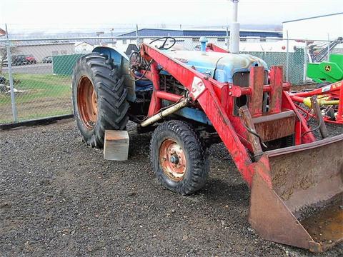

Hi all, Sorry for the Threadjack, but this seems most relevant to what I am dealing with. Any Help or direction would be greatly appreciated. I am looking at a superior loader for my 53 fordson new major. I could run a PTO pump but would rather run it off the front if possible so it would be "live." Any thoughts, proven setups or pictures? I have the hand crank starter shaft on the front of that tractor now.

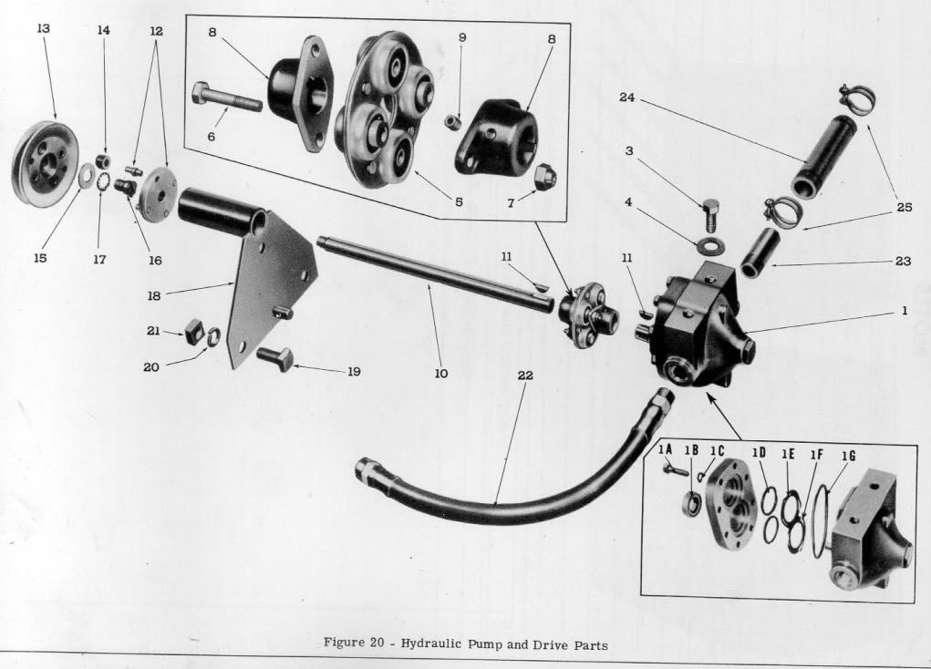

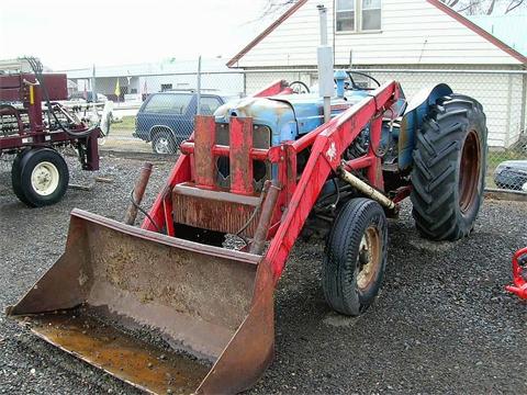

The Superior Loader came with a front mount/crank powered pump. You need to make sure you get ALL of the parts necessary to mount and run the loader. That would include the front brush guard which is the mounting point for the pump. The brush guard is an integral part of the frame as it keeps the front rails from torquing. You should also get the crank drive hardware.
The Superior is a great loader for your Fordson. I love mine:thumbsup:
hydraulic pump and drive par-2.jpg Superior Loader 01.jpg Superior Loader 02.jpg

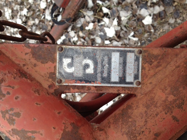

Well, here is an update if anybody is following. I went and looked at the loader, and it is in remarkable shape with the exception of the bucket which somebody has hacked the sides off of so its only about three feet wide. It is a model 218, and only has one hydraulic cylinder on the bucket. The pump is with it, but he doesnt think he has any other hardware. I took some measuerments, and it seems as if it MAY fit the major. It looks more like it fits the Jubilee or NAA better. It would take a little bit of modification to fit the New major, but looks like it might work. Price is $600.00. needs some work, but not alot. If anybody has any specific information about this model, or ideas where to find replacement drive parts I would appreciate the help. Whirly, which model is yours? is that your tractor in the pictures you posted? That model looks like it fits the major quite a bit better.

This is a "Utility" Loader. Check the attached list of applicable tractors. You will see that the correct loader for the Major line is the Heavy Duty Loader. You may have a lot of difficulty adapting it as it is most likely too narrow.
Page 4 - list of applicable tractors.jpg Page 5 - Utility and Heavy Duty loaders.jpg
