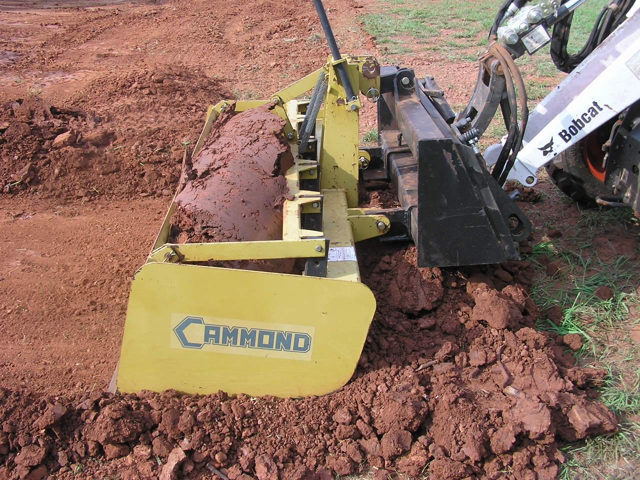

Not a back blade, but a box blade, pictures to give you design ideas for an adapter.
I bought a SSQA to 3 point adapter with extra rollback angle built in.
