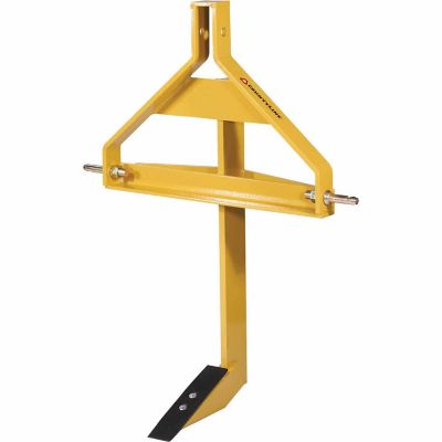

We recently got a single tooth ripper/subsoiler which does good of ripping out tree stumps.
It had no problems with 4" stumps (or 2" roots on larger stumps) when pulled behind our L3830.
CountyLine Subsoiler at Tractor Supply Co.
We did have to replace the lower link pins as the sleeves slid up and were sloppy.
