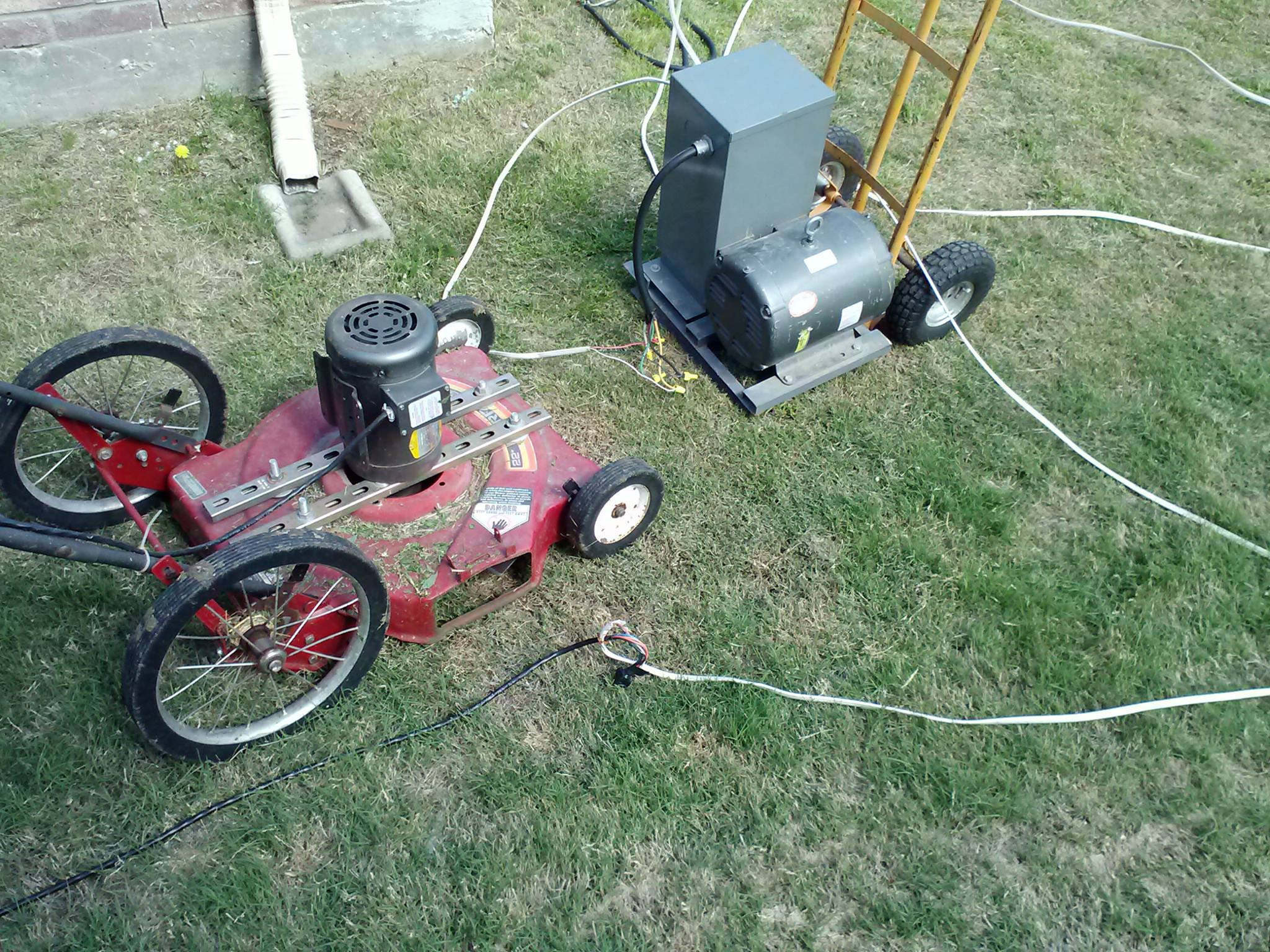

I recommend Electric . . . with Cord.
8 years, still going, left outside most of the time.

You "hand truck" a heavy transformer around to power an electric lawnmower? Sorry, that's over the line for me. :LOL:
It is a Single Phase to 3 Phase converter. The motor on the old mower deck is a 3-Phase industrial motor. All Rather Olde Skool. ;)
It is a Face-Mount motor, held on the deck with Unistrut, and the mower blade just mounts on the motor shaft.
Most of the time the converter just sits in the garage near the Electric Panel. I had just rolled it out for the picture.
But the whole rig is about 10 years old now . . . (had to add up the kids' ages to figure that out) . . . so I guess I am getting older, too. ;)
With about 100 feet of cord, it reaches to the corners of the yard.
Now days we would do the whole thing with a Variable Frequency Drive, as they can convert from DC or Single Phase into Variable Speed AC.
