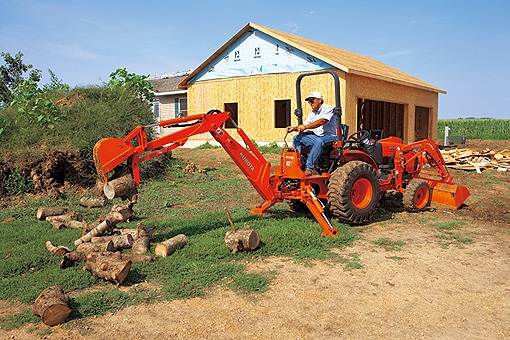

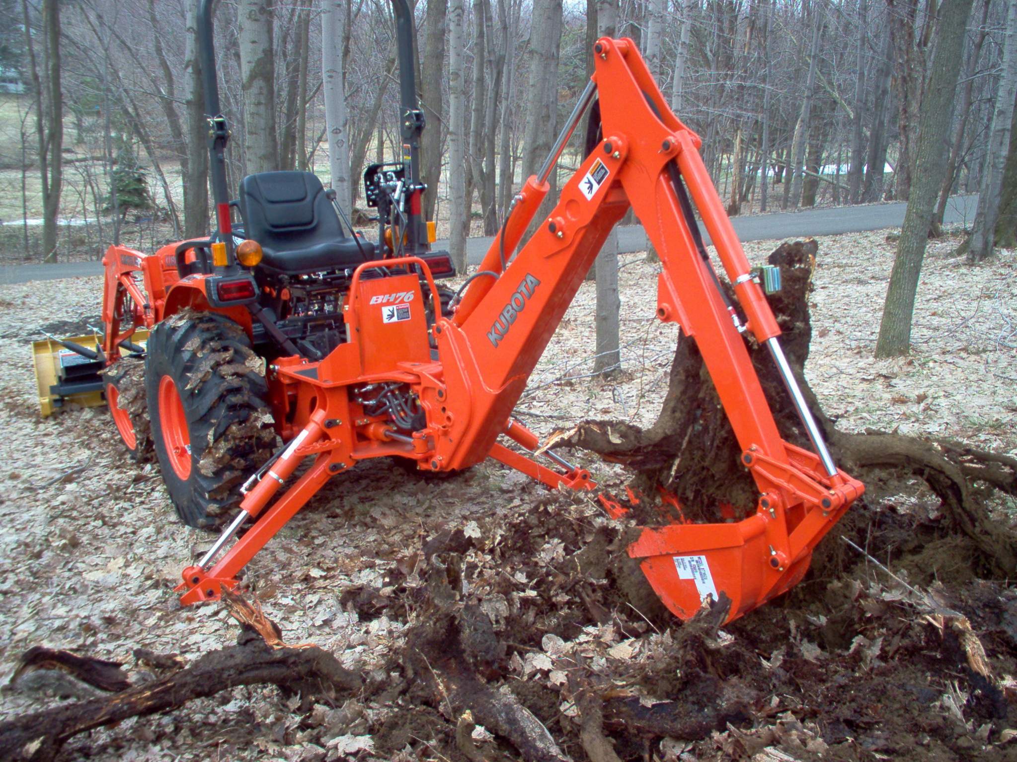

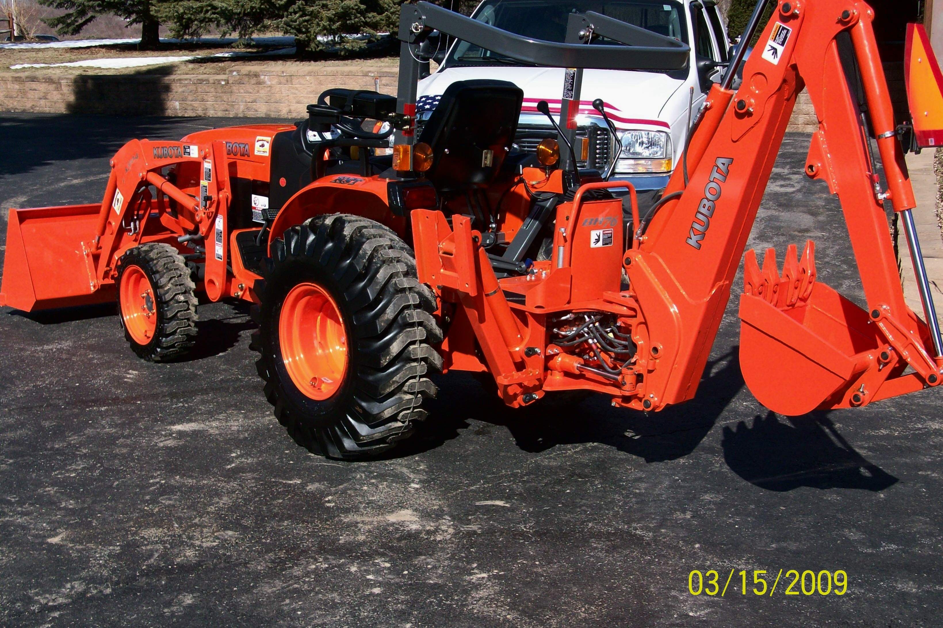

Let's see what I have stashed away:
These are photos from both Kubota, and other members, and I only use them to answer your questions........ The credit for them goes to others.
