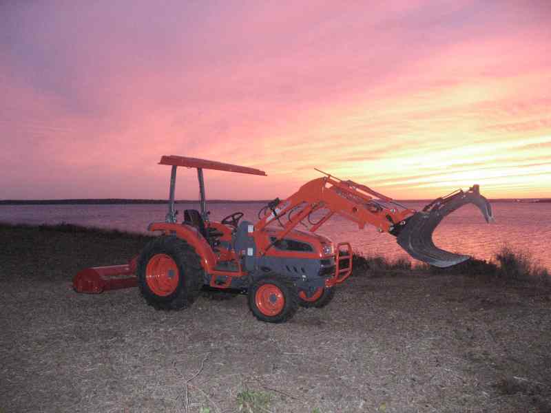

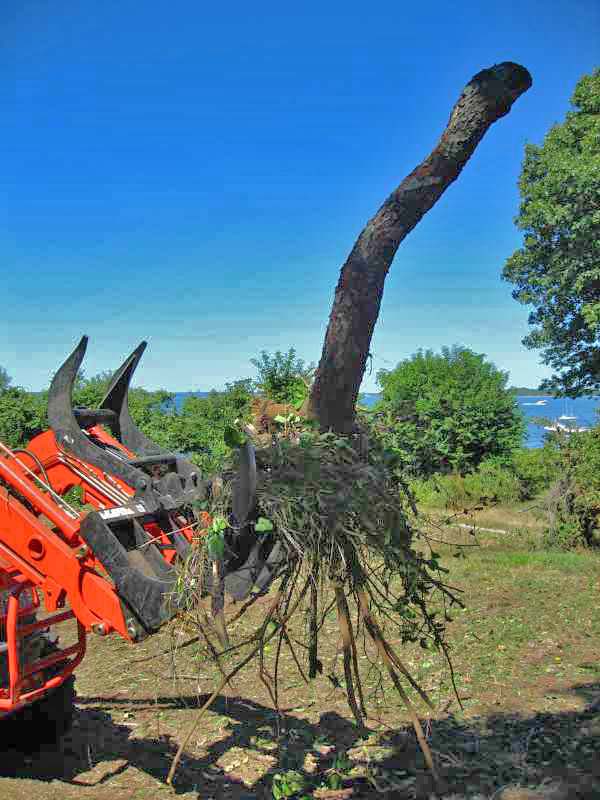

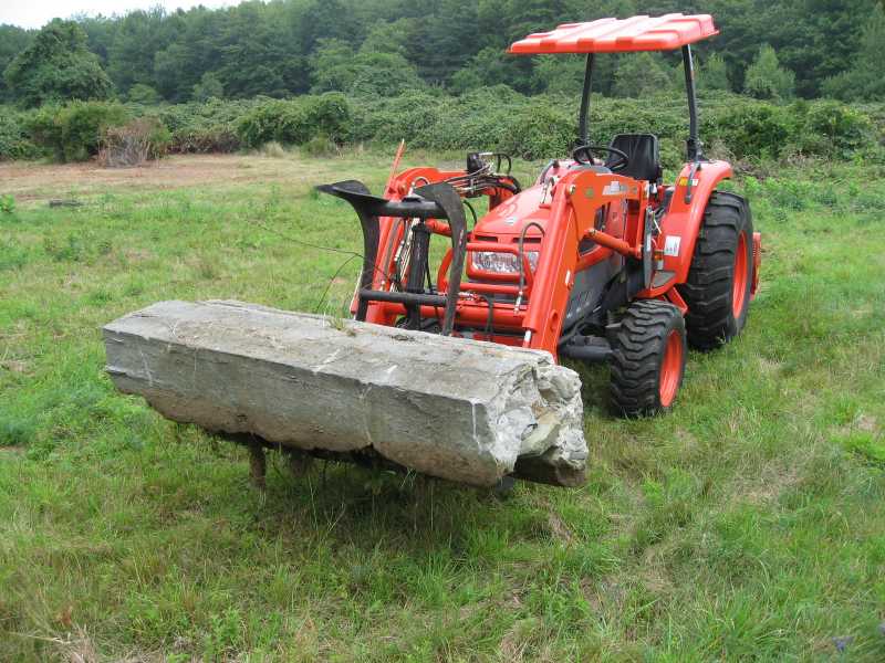

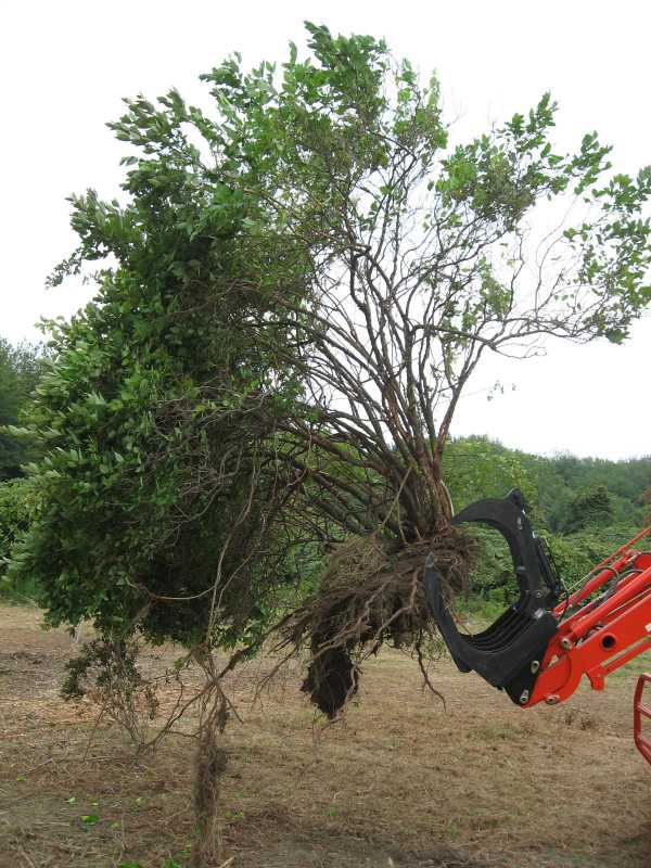

If you've read my past posts you know that I use a 48" Millonzi on my 41hp Kioti DK 40se which has the a bit more lift capacity than your JD loader (2700lbs to full height at pivot points). I find it works just fine and have no concerns about damaging the "light duty" grapple so long as I use it as designed. I'm sure the new lower cost WR Long is also excellent based simply on their reputation.
I routinely pop out roots or just whole small trees (why take the extra step of making a mess with a bush hog?). Pop'em out and put them in a burn or compost pile.

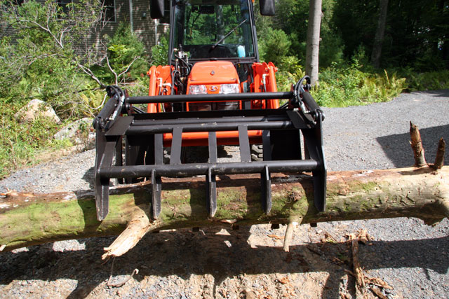

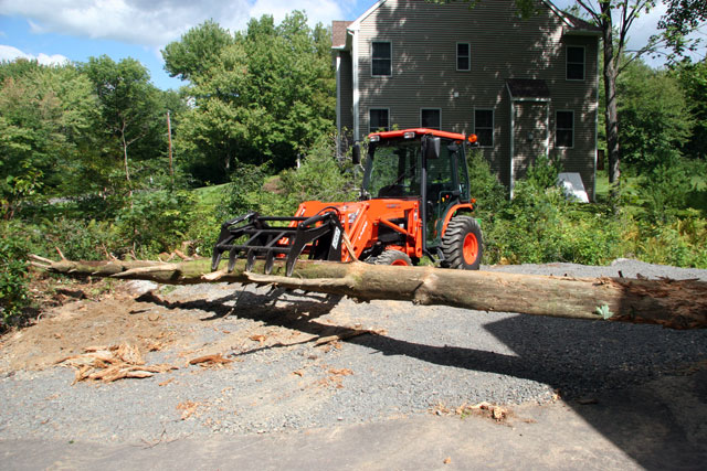

I also have a WR Long grapple on my B3030. I have the 48" RBG2-48 model. It is a root type grapple as the other poster stated and works great on roots and brush. I liked the WR Long clamshell design better than the Millionzi grapple design but the Millonzi runs around $1000 were the WR Long cost me almost $1700 :rolleyes:.
WR Long
RBG
Millonzi
