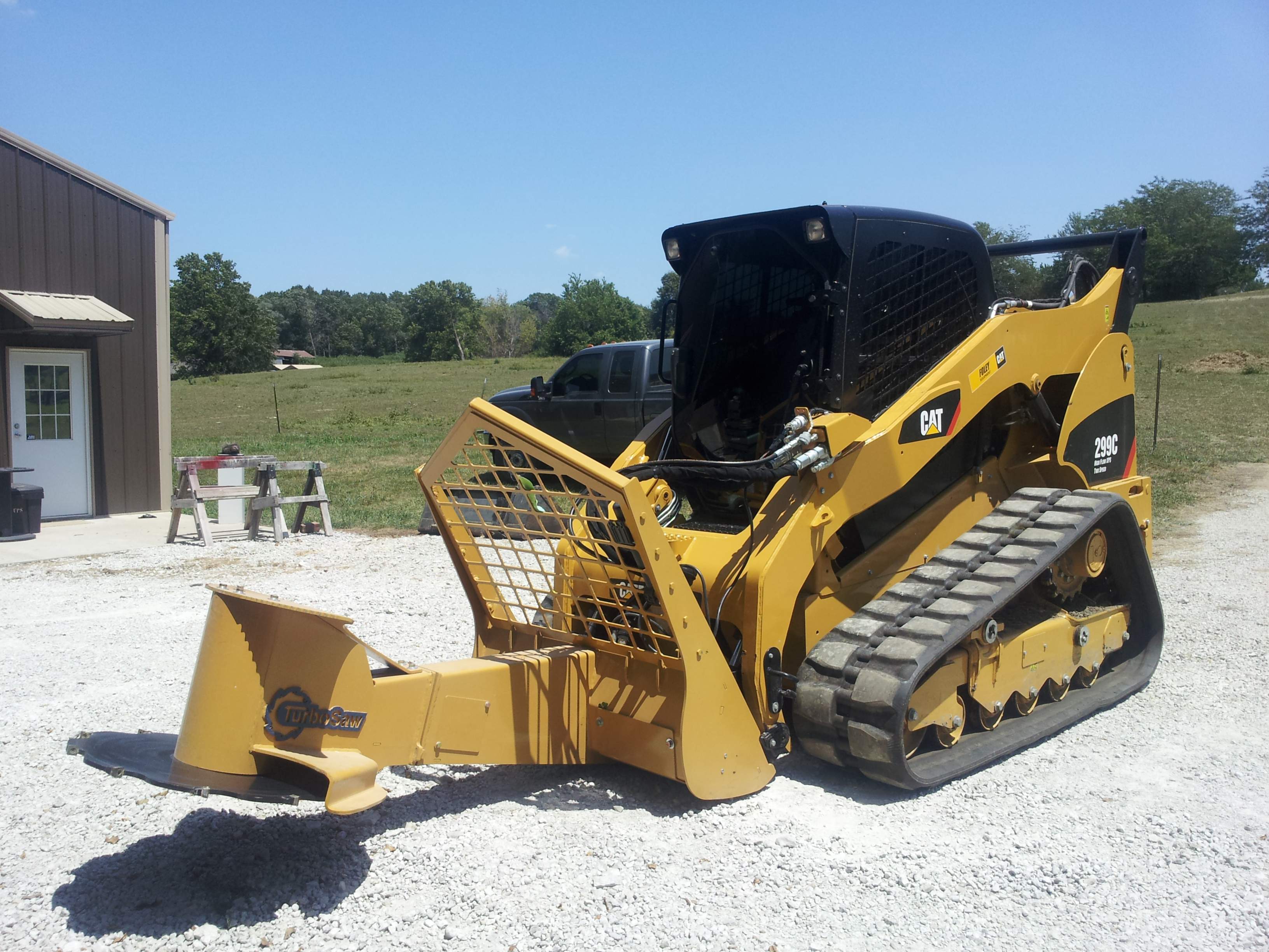

<img src="http://www.tractorbynet.com/forums/files/attachments/379928-purchased-dougherty-turbo-saw-3-a-dsc_0152-jpg"/> I purchased a turbosaw about 2 years ago and have used it on a 30 HP pto John Deere 3038e. It is a load for the tractor and strains the tractor getting the saw up to speed. It cuts trees up to telephone pole size easily. I do not have rear hydro so I cannot use the grapple. If a larger tree leans towards the tractor it will bind the blade and stall the tractor. I have cut about 500+ eastern red cedar. Sizes from 1/2" to about 20" stumps. On level ground you can cut the tree at or slightly below ground level. I have not rotated the teeth yet, but about 1/2 of them are chipped by hitting I believe metal in fence lines. (a couple of electric fence posts, imbedded barb wire and woven wire, and a couple pieces of scrap metal.) I get hit by wood chips when cutting trees, and the ROP has saved me from a couple of trees that fell on the tractor. I found it safer to cut larger trees with a chainsaw at 1-2' above ground and cut the stump with the turbo saw.
That's impressive that your tractor handles the saw pretty well! Oh, and that picture is pretty impressive! Do you guys have any pics of the saw in action? I sure would love to see some more pictures of it and I'm sure others would as well.

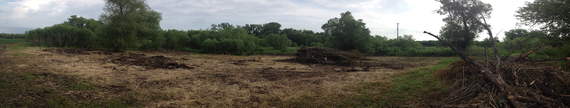

Above is a photo of an area just cleared of dense willows using a hand held (with harness) brush cutter.
Lots of these areas on my property and the Turbo Saw might make this task a pleasure.

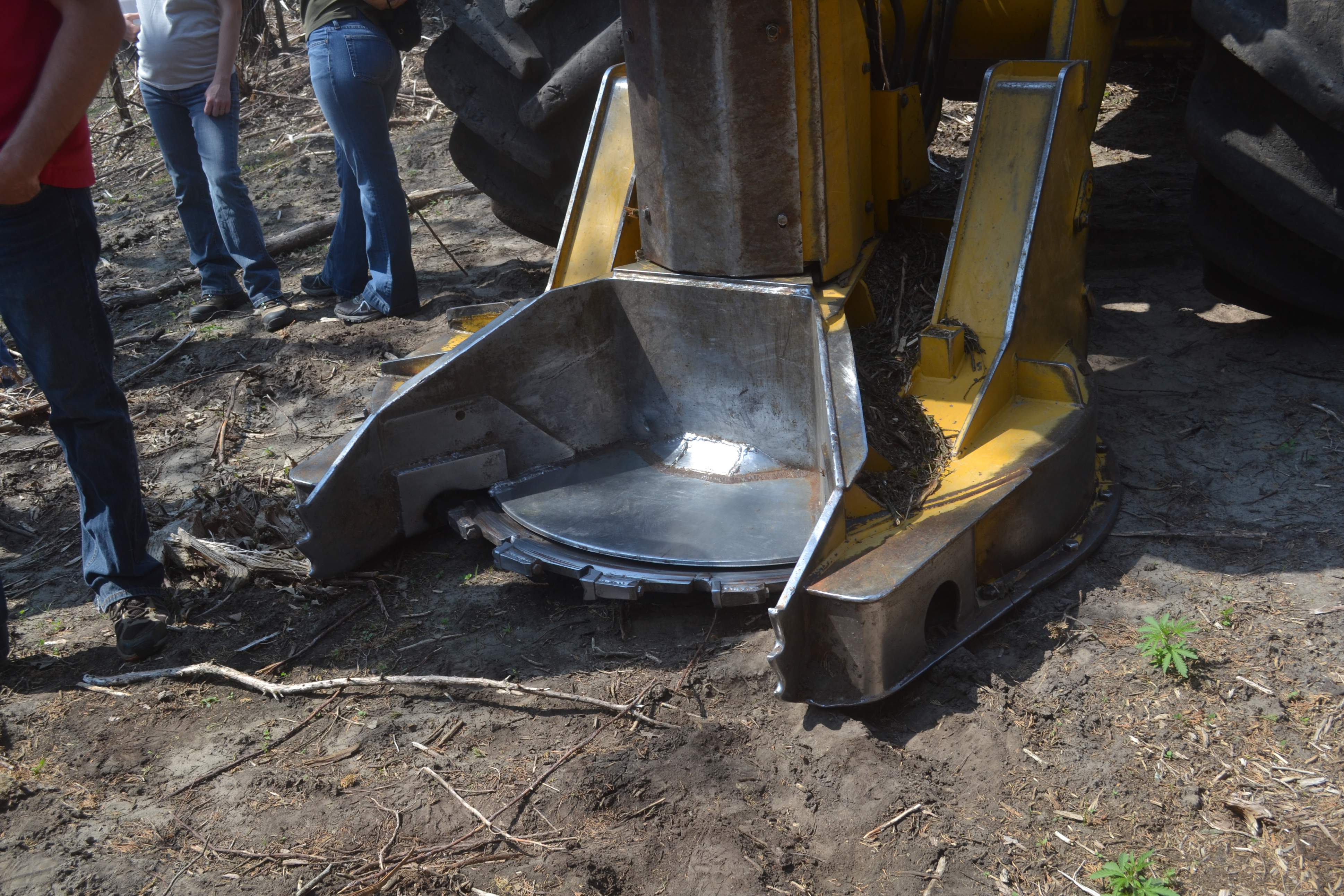

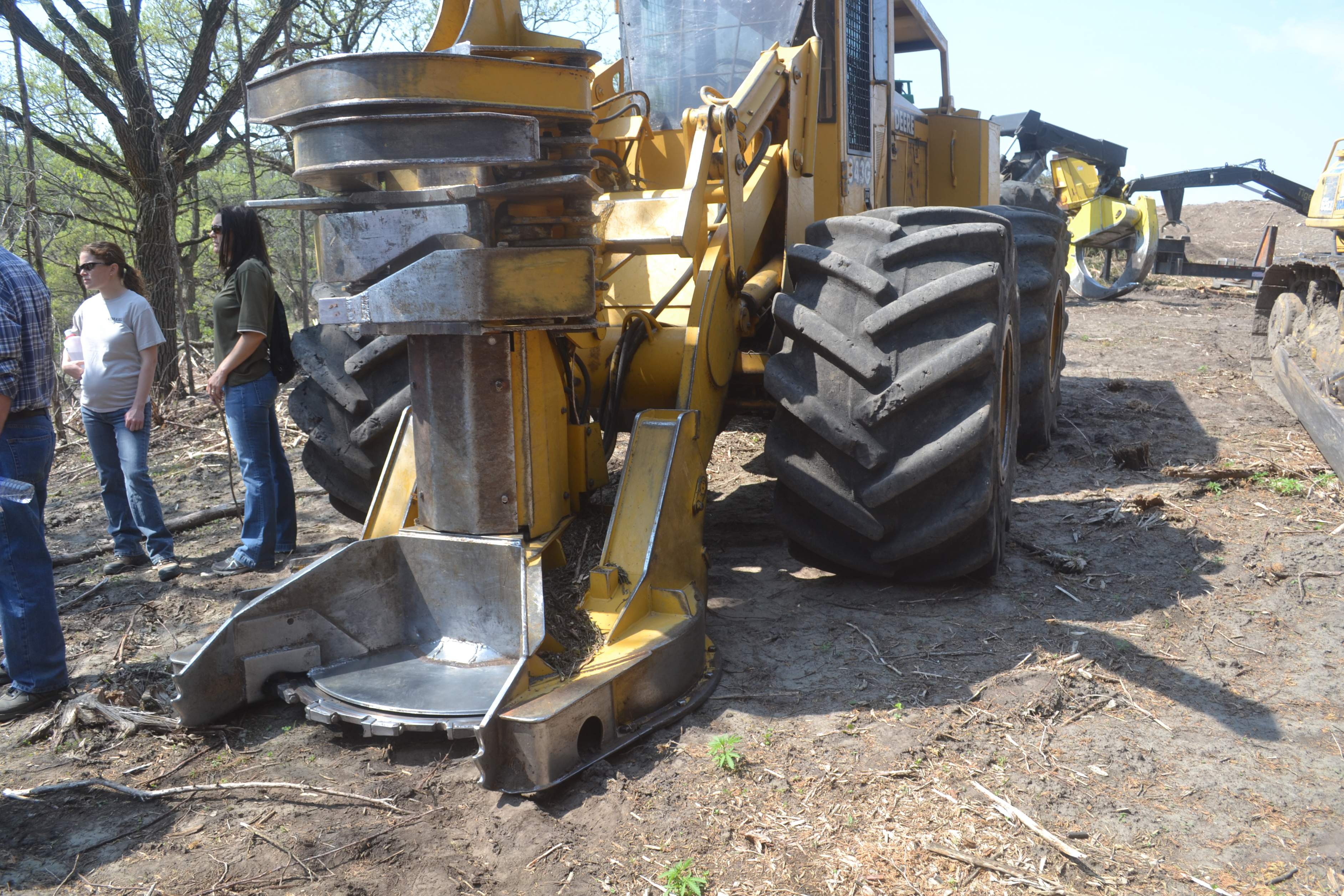

Same concept on a serious level
