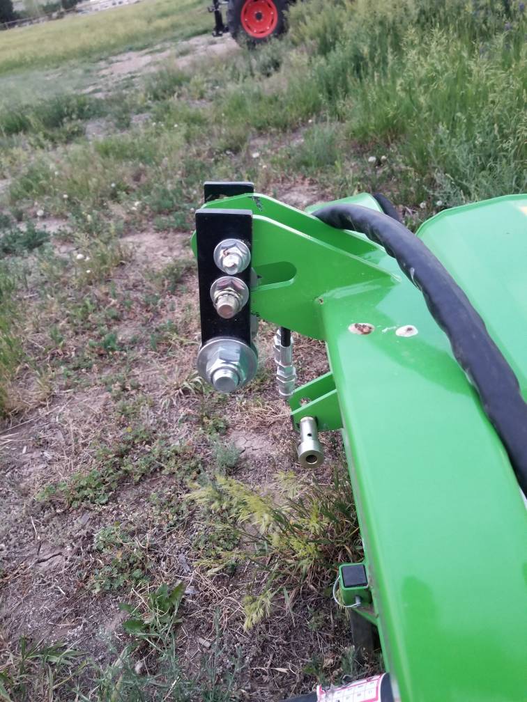

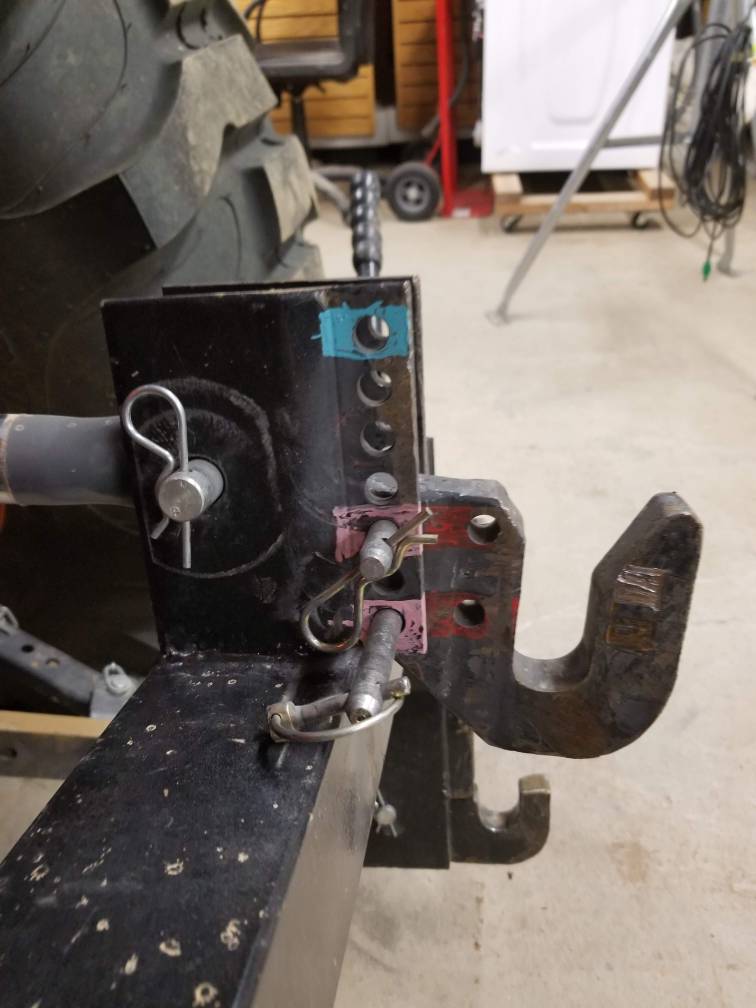

When I talk about an extended toplink you can see what I'm talking about in the photo below. I've seen those other links called flex links or flex adapter.
You can see the OEM holes visible, then the pins going through the extension I welded on the back. The holes I drilled weren't quite straight vs the originals so it sags a bit.
Without the extension a few impliments rubbed up against the rest of the frame where the pins are.
I replaced the original bolts with pins for easier adjustment. There is no side load & I'm sure those pins are harder than the bolts.
The red marks are QH standard. The green mark is for my Peruzo flail before I fabbed up a proper length adapter & my Gannon box blade I haven't gotten to modifying yet.
The black OEM Peruzzo flail toplink adapter was expensive, poorly made & way to short for CAT1 (might have been CAT2). Really just 2 bars with 3 poorly drilled (crookedly & jaggedly torched actually it looks like). The adapter is tightened solid instead of using the slot it covers up. No big loss to me as I always mow with my hydraulic toplink in float for both my flails & my old rotary cutter. Im not sure if it can be run loose to flex. I replaced it with properly long bars with better holes drilled. I sheared cheap 1/2" bolts on the adapter before upgrading to 3/4" grade 8 bolts. Others probably need the flex link adapters. 20180712_174244.jpeg20180609_203109.jpeg

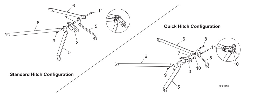

I don't see any flex in your arrangement.
Try this.
Bruce
The pic Bruce posted is the correct method.
When using a QH the triangulated hitch points on the attaxhment should be fixed. This prevents accidental unhitching. The flexibilty for movement should be in the attachment bracing.
By modifying the top hook with free swinging brackets the whole purpose of the QH is defeated.
I may have to give this a try. Should work on my finish mower.
My brush cutter has the slots for the top pin to float in instead of the pivoting arrangement.
This seemed like a good idea at the time but would not work on either of my mowers. I will just stick with what I have been doing on those. The extender is simple to connect on my finish mower and removing the hook to get it to float on my Howse brush cutter still takes far less time than removing the QH and connecting it straight.

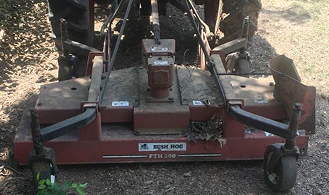

I can defiantly see this being better on my shredder, but it still won't work for the finish mower.
I am thinking of making some type of L bracket for the finish mower that would still use the original swing bracket on the mower. If the L bracket was somehow fixed(i.e. welded) at the correct angle and was the proper length, then as the hitch came up I believe it would have to stay in the hook.
Does this make sense?

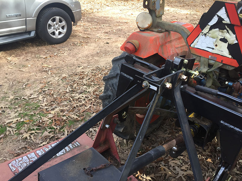

Ok, I need some more help from my smart friends on TBN!
So I rearranged the hitch on the shredder and it gives more float if it remains in this position.
But, if you raise the 3pt it will go past center.
Then when you lower back down it binds.
It will do the same thing when I go down a steep enough grade like the bar ditch.
How would you correct this issue?
/ Purchased 3pt quick hitch. #70
Weld a bar or rod across the back of the U section of the floating link, so the pins won't line up and jam.
Bruce

Nailed it again Bruce!!! :)
#72
Thanks guys for the great advice! I will get that done.
