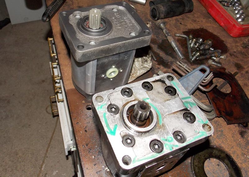

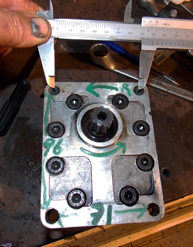

There are different shafts; splines of various types, cones with key, or straight with key. Different flanges with different centering collars / bolt holes. And there are right and left turning options too.
As yours is belt driven, you have options if you can fabricate a bracket and fit the pulley.
For instance;

I just put the rexroth number into google, and an ebay ad popped up.
It was unused old stock, and I got it for $100 incl. shipping.
There are various flanges, shafts (straight, cone, spline), centering ring size, and most importantly rotation direction.
My tractor had 2 different pump sizes, the US version had 19cc, the EU version (mine) just 14cc. I found one with 22cc that bolted on.
