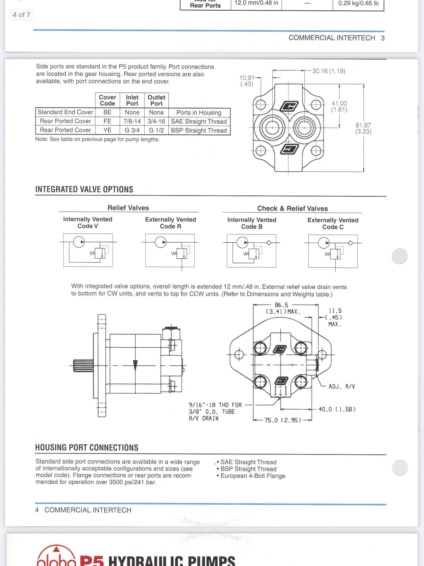

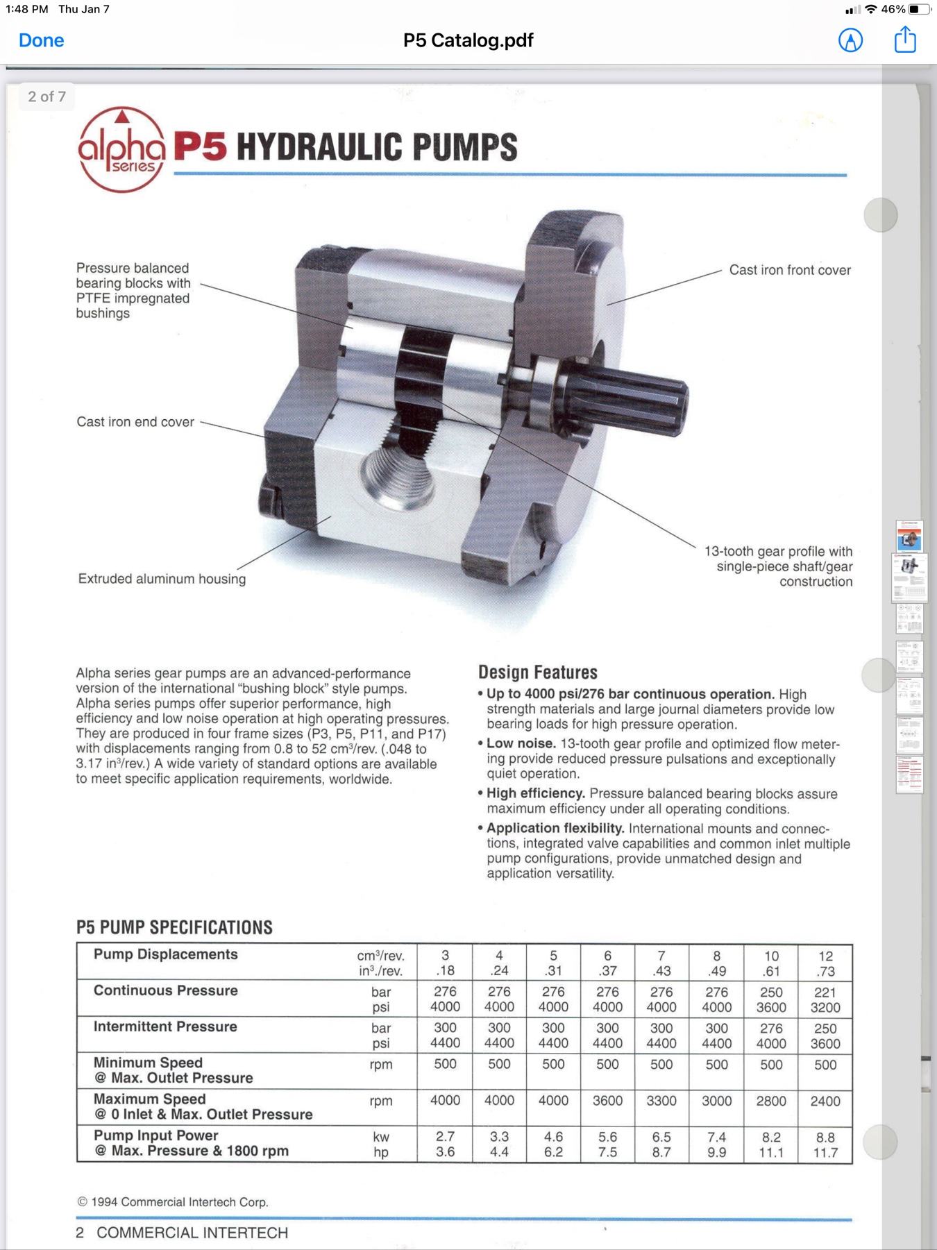

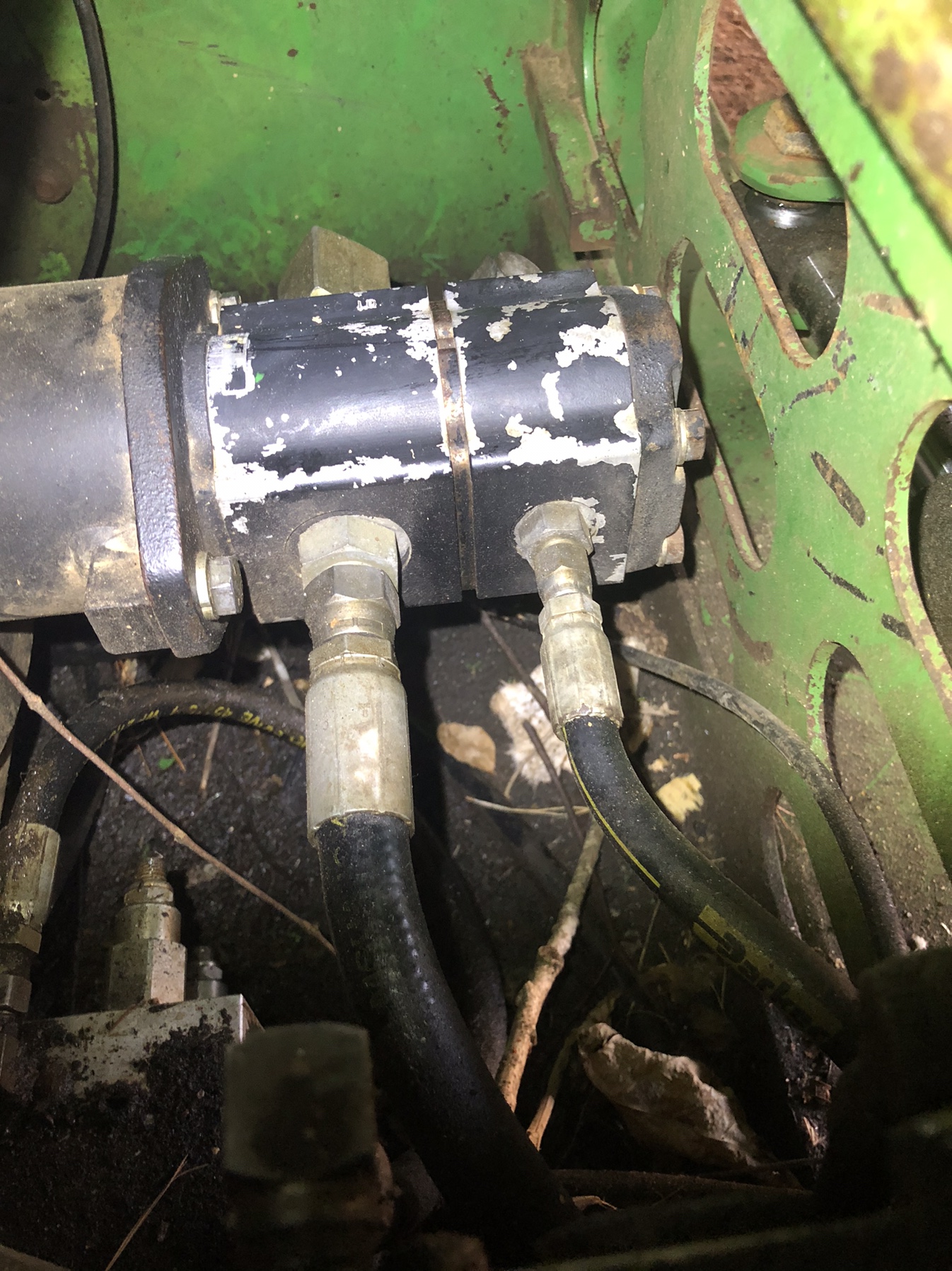

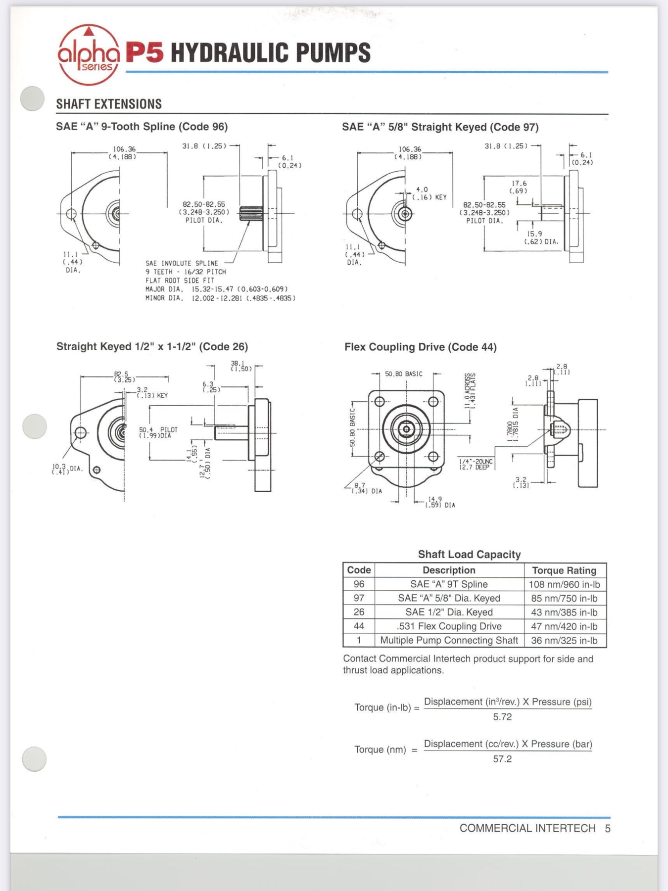

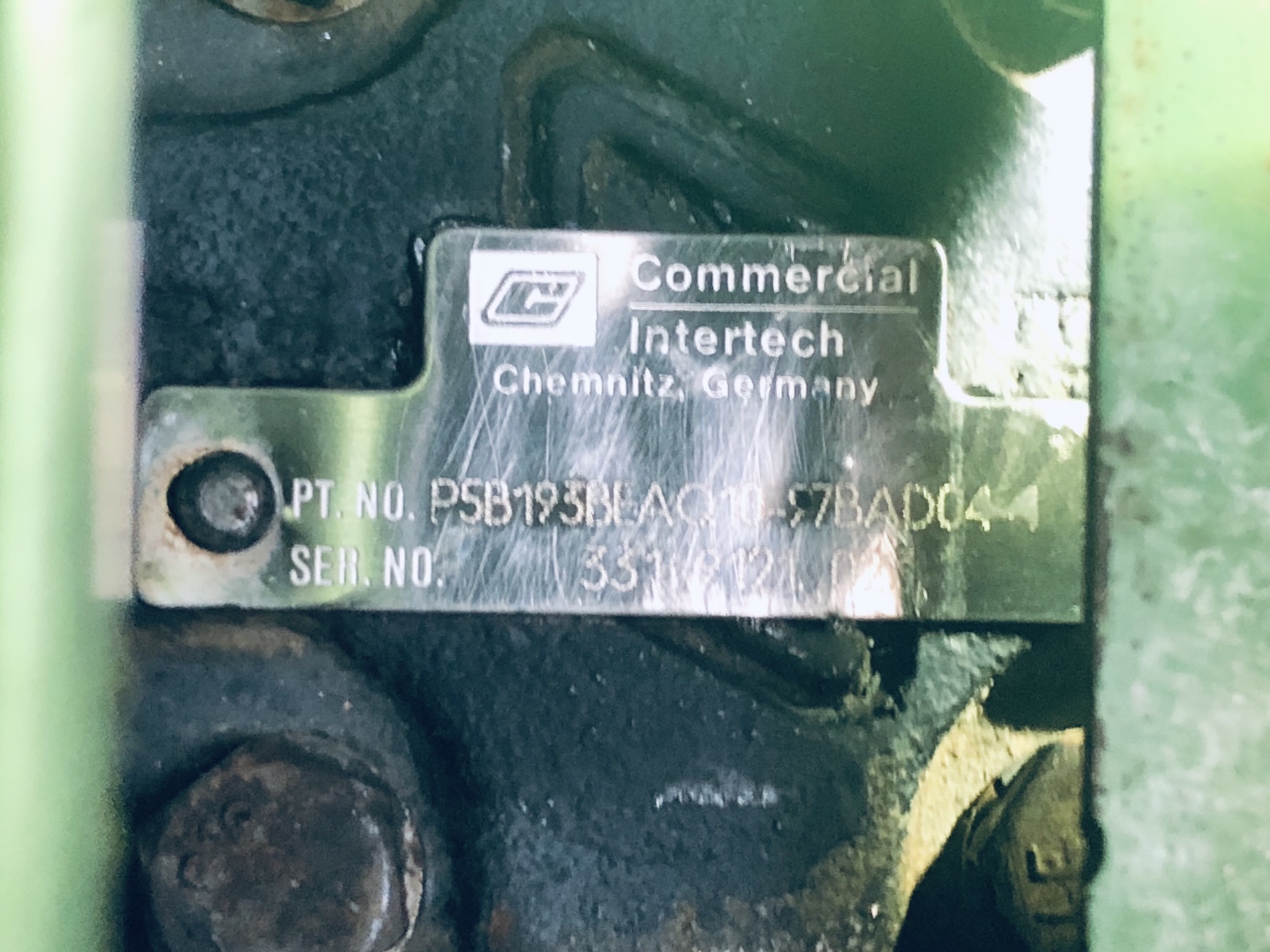

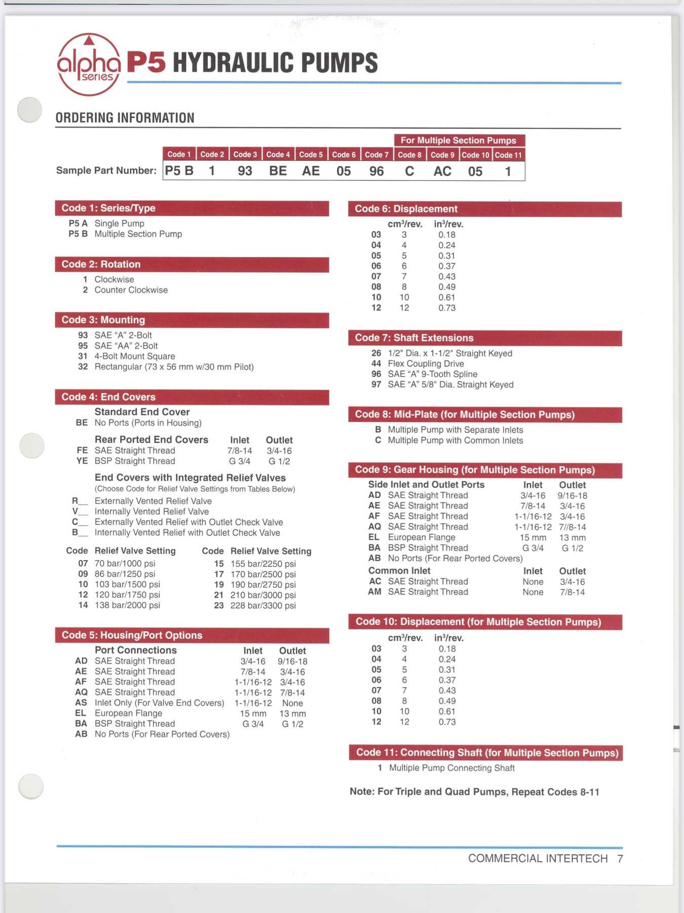

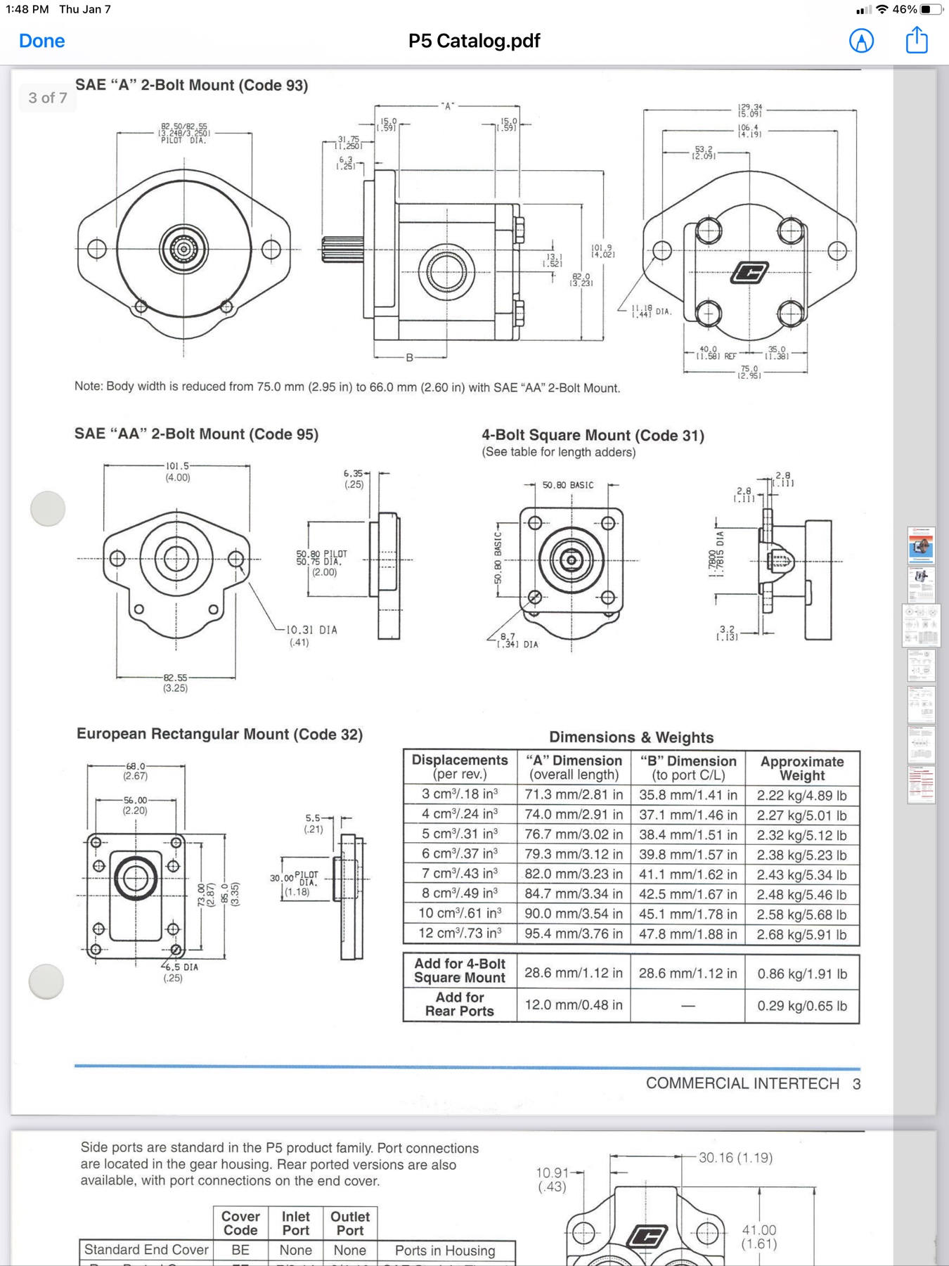

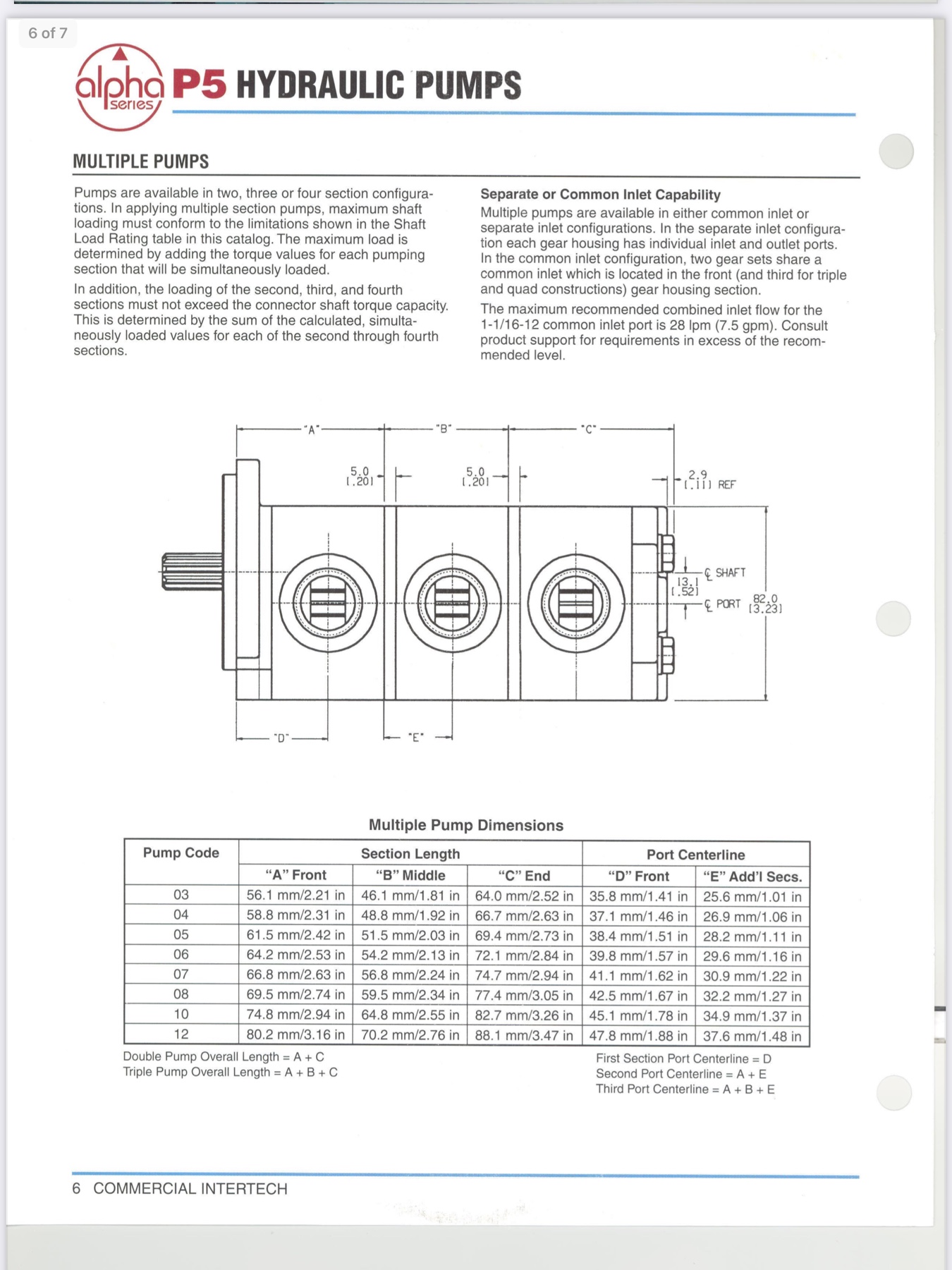

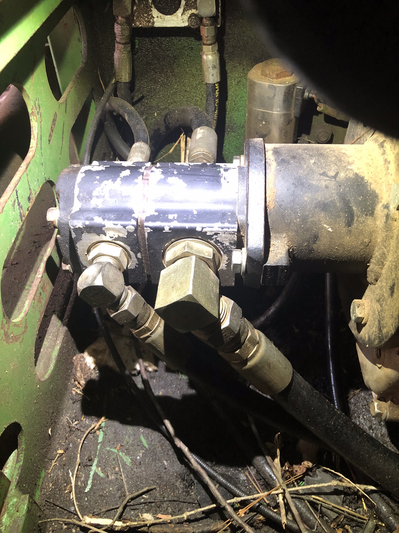

Here is some info I have found in my search for a pump replacement it is the information for the pump on my 2422 -aux - PTO Pump. Hope this helps some others out there. You can use the breakdown on the last page to find out the exact specs on the pump you have if it’s a Intertech, which is owned by Parker now IMG_5941.JPGIMG_5943.JPG. IMG_0595.JPGIMG_0596.JPGIMG_0597.JPGIMG_0598.JPGIMG_0599.JPGIMG_0600.JPGIMG_0601.JPGIMG_5948.JPG
