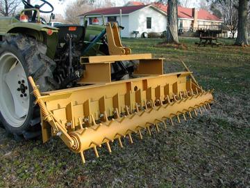

Here's one I got from a site about homebuilding attachments.

I like the looks of those spikes,they look a little longer than what I've seen.Wonder who makes that?

It was homemade, if I'd made it you wouldn't ask, it would be apparent. /forums/images/graemlins/tongue.gif
