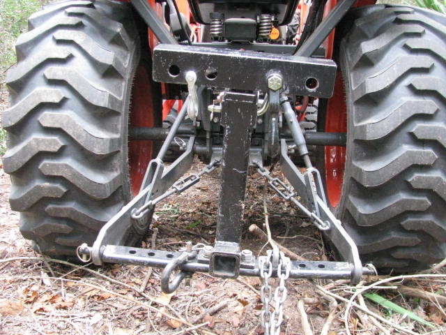

When doing tasks such as skidding a log or pulling a tree or moving dollied trailers, etc., I use the 3pt. I use the 3pt for everything except long term ground engagement equipment use.
The 3pt multiplies the ability of a tractor to pull heavy loads by several times. As my Dad would say, if you don't have the front tires off the ground you have not reached the tractor's abilities.

Pulled many logs with the 3ph using 8N. Steer with the brakes.
/ Pulling with Three Point HItch #25
Back in '66 I pulled logs from the woods to the loading site using a Ford Workmaster. The log tongs were attached to the drawbar on the 3 point. There were many a log pulled where the front wheels never touched the ground on the way out. I knew the route I was taking and my foot rested on the clutch just in case. No ROPS then. Also tried to hook the log so that if the tractor tried to come too far back the drawbar would rest on the log itself to prevent roll over. That old gas Workmaster would walk and talk when I got hold of a big one.

No help at all there until you hit the ["fragile"] top stop. The lift arms need to be fixed downward to get a real safety benefit.
,,,larry

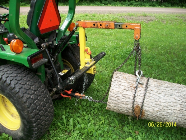

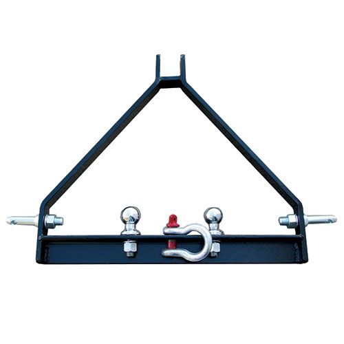

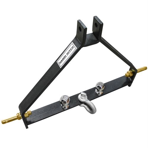

Yep, pulling logs or stumps or anything else from a 3PH drawbar "CAN" be dangerous.
Big difference with implements like a blade or plow, other than pulling from a lower position, is since the implement is rigidly attached, it kinda acts as a wheelie bar. A 3PH drawbar or one of them "handi-hitch" things just dont extend reward far enough to do any good. Thus there is nothing keeping the tractor from going on over.
