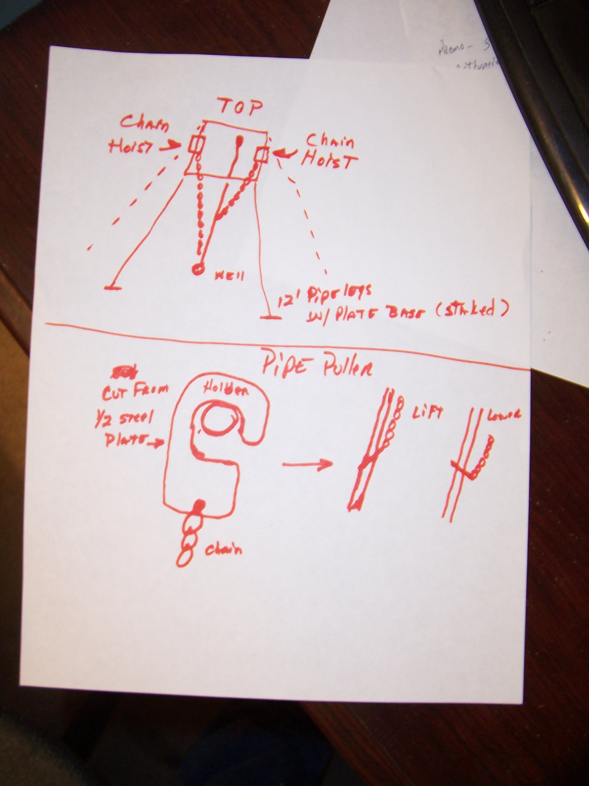

Poor drawing of a puller my friend and I built to pull hi 400+' well.
Took maybe 2 hours to pull with this. Breaking some of the couplings loose was the bigger PITA.
The square in the top held the pipe upright as it came up, the 2 chain hoist worked great. Pull half with the 1st chain then pull the rest with the second hoist. When we got the coupling a foot or so out of the well head we put both the "pipe grabbers" we made below the coupling to hold it while we broke the upper joint free, then we just pulled in down and away from the platform.
We used 2-3/8ths" pipe for the legs and pinned them to the ground with metal stakes through the base plates.
The pullers we made from 1/2 steel plate and unlike my drawing they only had around a 3/8" clearance from the pipe, so we could get a good "bite" angle. Also had an "offset" cut out opening, so they wouldn't fall off, (1st ones we made fell off:thumbsup:
I wasn't there to help him put it back in, but he said it was a "snap" with his grandson. He did use some kind of anti-seize on the threads.
He built a deer feeder out of it when he was done:D
