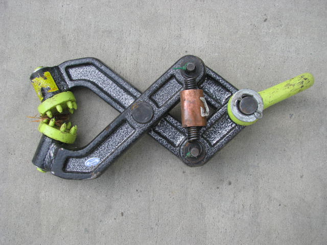

#1 This is a made-in-China "Brush Grubber" also known as a pallet puller. Available on eBay and Amazon. This is the Heavy Duty model. As BG's get larger spring tension increases. Heavy Duty model is all I can manage at age 65. Grips small trees much better than chain. On larger trees and grape vines it grips; chain too often tears through. As pulling force from chain increases, gripping force of BG toothed jaws increases.
TBN posts comment that springs come off regularly. I have spring ends secured with green zip ties plus a piece of copper tubing over the spring. My spring has not come off...but I bought spares from the spring bin at local Ace Hardware.

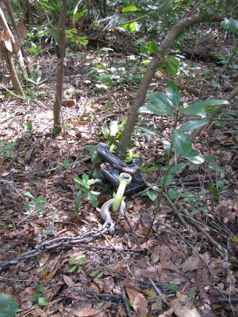

#2 Brush Grubber on tree, 1/4" grade 43 slip hook on Brush Grubber bale, 1/4" grade 43 chain on slip hook.

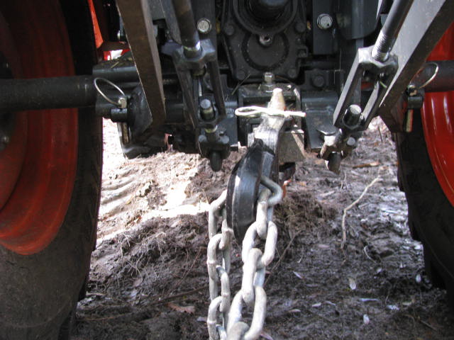

#3 Wheel rim close to tree, chain over wheel rim.
#4 +#5 Chain to Speeco Drawbar Grab Hook mounted on (Kubota optional) tractor draw bar, Kubota B3300SU / 33-hp / 1,800 pounds. Tires NOT loaded.
(Remember to remove the Speeco drawbar grab hook at the end of the day. Otherwise grab hook will bend the eye bolts on your limit chains when you raise the 3-point.hitch. Kubota metric eye bolts are $35 each.)

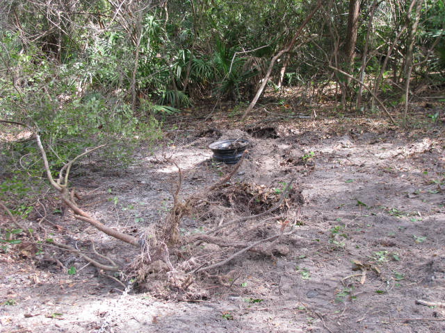

#6 Proceed in HST - LOW, 4-WD engaged ---> ----> EUREKA!! Tree is out roots and all.
The initial vertical pull, until the rim topples over, is what make the tree come out with its roots intact.

The Brush Grubber will pull trees without the wheel rim, but usually more of the tree roots stay in the ground....then sometimes the roots sprout into new top growth. Without wheel rim the ground usually is more disrupted so I have to go back with the FEL or a hand rake to complete the job.
Tire traction improves when using the wheel rim. Larger saplings will come out using the wheel rim that would likely not depart soil with pulling force applied horizontally, without the wheel rim against the tree. If you have a heavy, powerful tractor wheel rim would not be an issue. With compact and sub-compact tractors the wheel rim will sometimes make the difference between success and failure in sapling removal.
As my first post relates I was sceptical whether adding the wheel rim would provide enough improvement to justify carrying it around. IT DOES.
