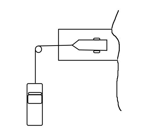

Use almost anything powered and braked for your level movements, and up and down the ramp with a medium speed winch.
Or:
Get fancy and build a marine railway that carries the trailer and boat down the ramp sideways.
