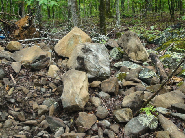

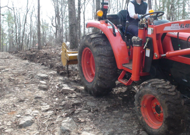

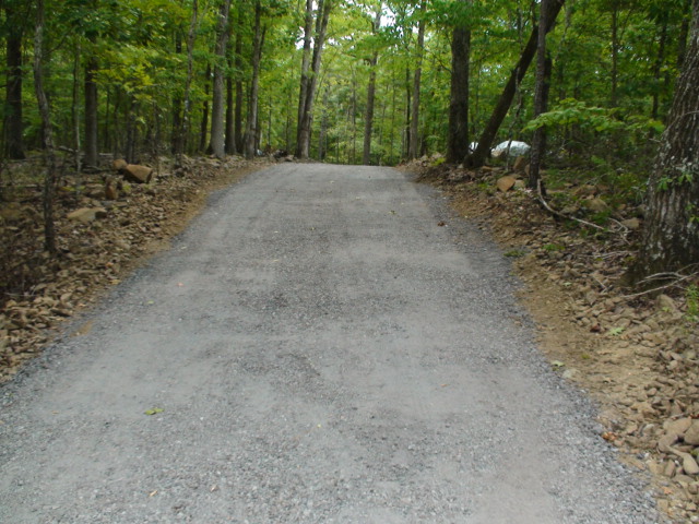

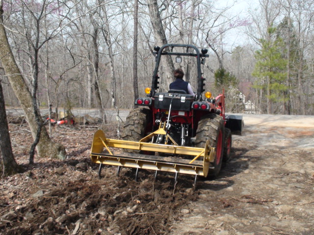

Recently I built a driveway on very rocky, heavy clay soil. While grading the surface, each pass of the rollover box blade (ROBB) with the shanks down brought up more rocks, some very large in the range of baseball sized to hundreds of pounds each, or larger. Even once I filled the large holes back in with smaller rocks and soil, I still had humps and valleys mostly caused by my grading.
The method I finally used to make the graded surface smooth was to go over the entire driveway several times with the ROBB until the shanks had stirred up a consistent 6" or more of soil. I then smoothed/leveled it all out with a couple passes of a landscape rake with attached gauge wheels. My first tries with the rake and no gauge wheels only provide mixed results as I do not have enough experience to use the rake alone. Adding the gauge wheels made the finishing task easy. Actually, the ROBB and the rake made this final part of grading easy. My stiffly sprung Jeep can now drive over this finished surface with the effect almost like driving over an asphalt surface, it is so smooth.
