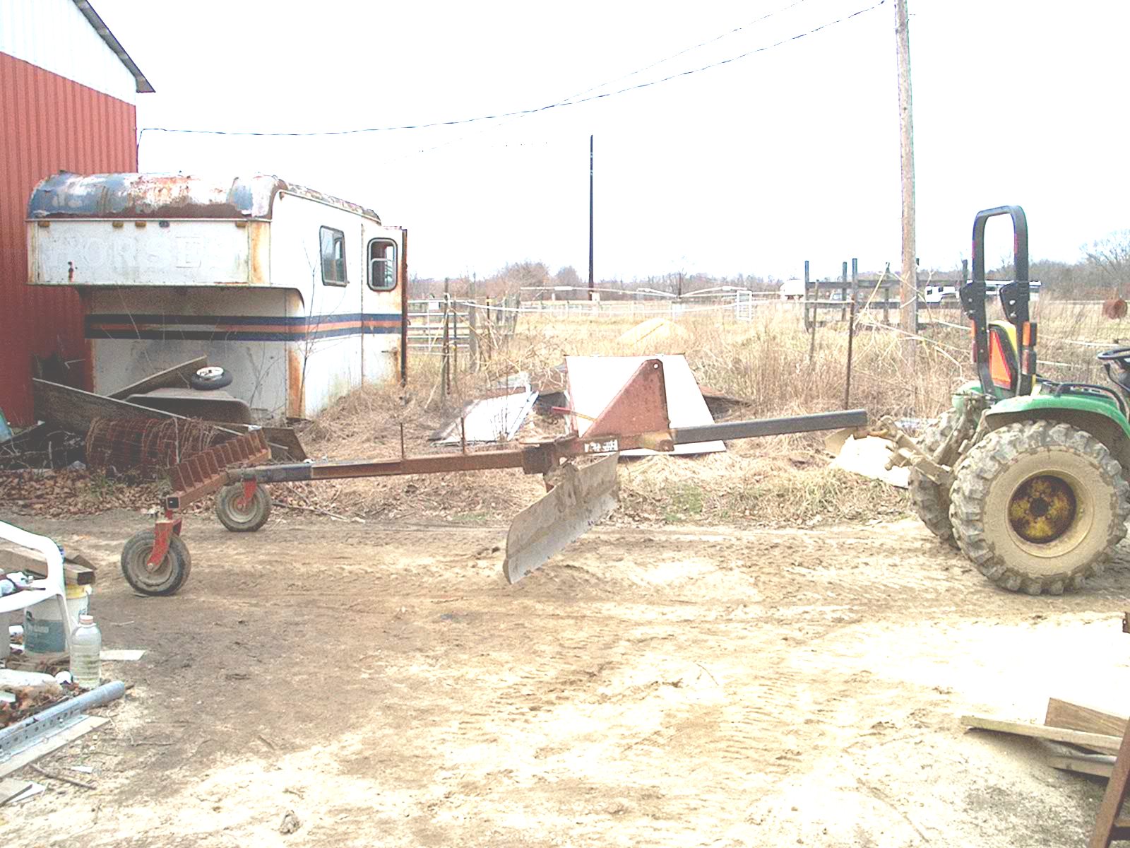

here's a cheap version that works well

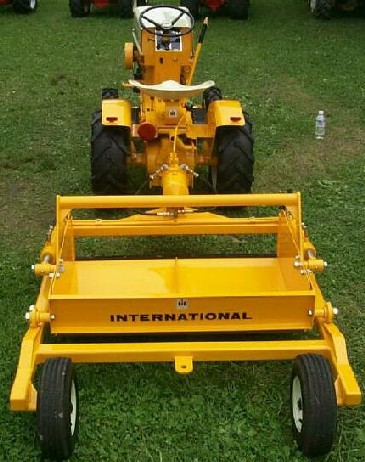

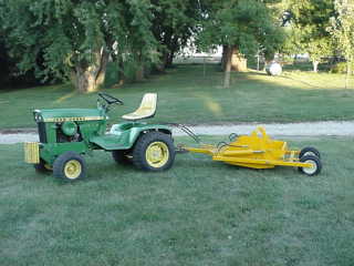

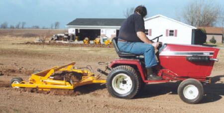

My Father-in-law had a 4 cu yard pull scraper that he pulled with a 2 wheel drive JD 2320. It had wide diamond tread orange grove tires and it pulled the scraper very well. Sure you could stop it, but when you had room to take thinner slices and you kept momentum you could pull it and move tons of sand in FL. I personally drove it. It was wider than 4 feet--more like 5 or 6 I would say.
I personally believe that you could use profitably the 4 footer with 20 hp. I have seen pictures of people using this kind of scraper with a lawn tractor!!:eek: [I am fully aware that it is not as big as the Hoelscher] On the other end, I have driven Terex 16 yard and 24 yard machines (2 engines front and rear) and the grand daddy of all the CAT 651B (34 yard). These machines are not designed to self load, but rather they are pushed.
The beauty of the scrapers is that the scraper itself adds not only drag, but weight to the tractor. If you are careful, have room to take thin slices and try to maintain momentum you will be able to move a bunch of dirt with only 20 hp.
I will include a couple of pics that I have seen of these machines to illustrate what I am saying.
