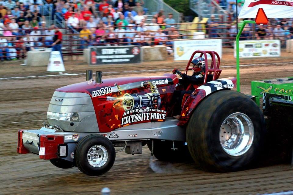

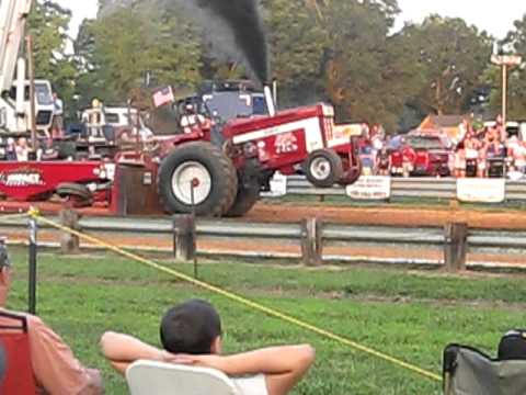

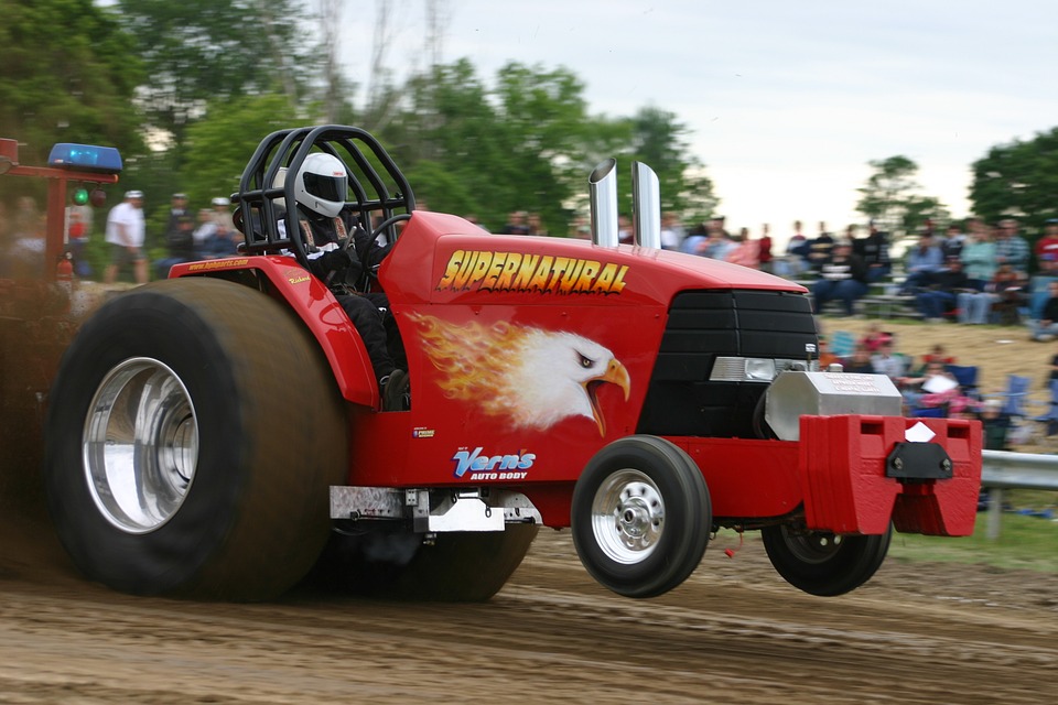

As CalG says there is no actual 'climbing a ring gear'. (post #152) The term is folklore and figurative, as if whether the wheels wouldn't spin when a tractor would/did flip over backward by 'climbing'. Still, I wonder about tire slippage 'or not' ...
So looking at these pictures .. is it just me, or ...
Is there a clear view behind any of their the rear tires, or perhaps a visible hint that there could be at least some slippage? (even mere single digit %s)
Are the hookups to sled/load more or less considered to be a) connected below the axle centerline b) of common or 'class' length and .. 20"/20" height/distance?
btw, Can we, or not, see our vector analyses demonstrated here? Are all/any we mentioned clearly illustrated? :scratchchin:

Basic physics - even known when I got my engineering degree and available through every states dept of agriculture. Modify your tractor so the coefficient of traction approaches infinity and it’s going to flip backward. The diagram I posted is from a basic tractor engineering book. Pivot point is bottom of rear tires. Multiply force times lever arm to get the opposing moments. Pull times pull height is opposed by mass at CG times lever arm. If the traction is poor the pull cannot reach the point where the front end will lift. If the traction is high the front end will lift, just like shown in all these tractor pull pictures. Same thing in the picture I’m sure everyone has seen of the driver who chained logs to his wheel. Every time a log hit the ground the tractor front raised.
