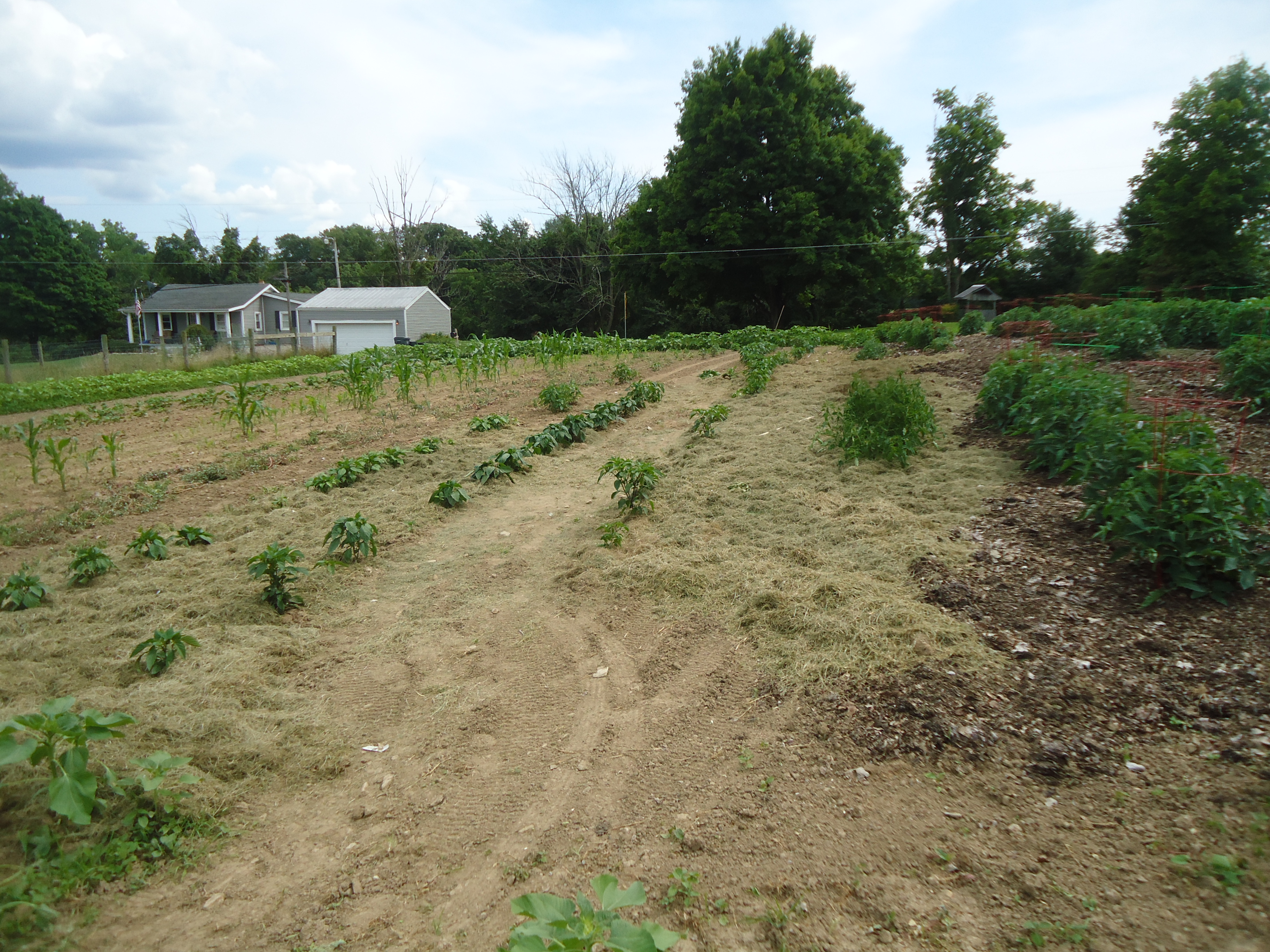

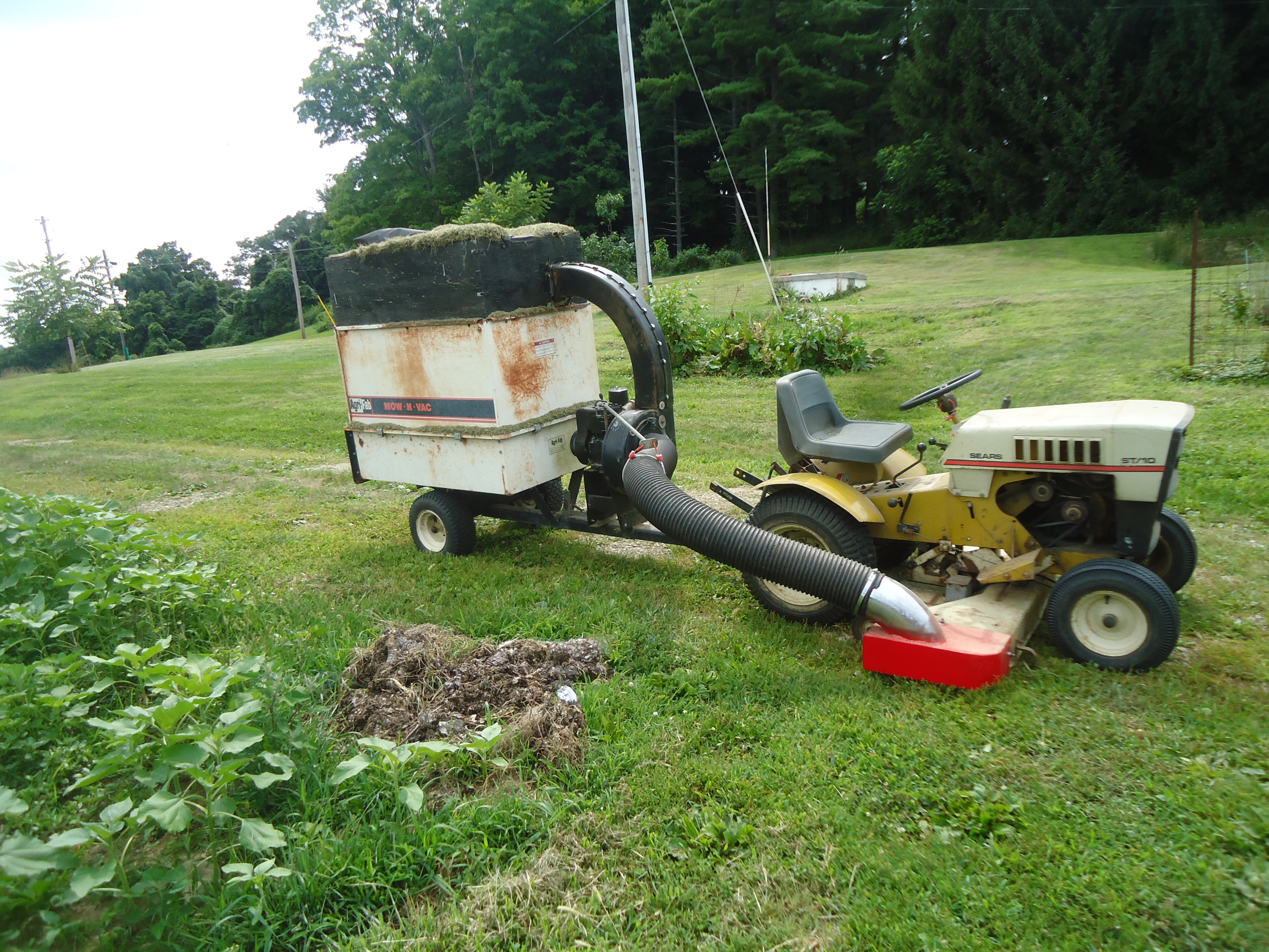

I bought a used Agri-Fab last summer, for $200.00. The PO had screwed the gas cap on, and got it cross threaded. He put a pair of pliers on the cap to remove, and broke the neck loose in the gas tank. It started on the 3rd pull, with 3 year old gas in it. It is a bit weathered from setting outside, but still in pretty good mechanical shape, so I bought it. I repaired the fuel tank by removing, cutting the cap off, filling tank with water, and spot welding the neck in the tank. I happened to have a gas cap like it in my spare parts. I buffed the flywheel magnets, and cleaned up the pickup, and installed a new plug, and fresh gas. It now starts on the first pull. I made my own boot for the discharge chute on the mower. Just some sheet metal, and of all things, apiece of used 6" exhaust pipe from a buddy's semi that had gotten damaged, and was in the junk pile. The elbow in the pipe, made a perfect, no restriction elbow for the boot.
It works better than I ever imagined. I use it to vac up grass clippings in the yard, to mulch around my plants in the garden. I use it weekly, and have enough grass to get 3 trailer loads. I normally use leaves, brought to me by a neighbor, who has a lawn service, who also provides leaf pickup in the Fall. I didn't have enough last year, so started looking for a lawn vac, so as to use grass clippings, and found this one.
Another neighbor brings me his leaves,and just rakes, then hauls them in his lawn trailer. It takes him forever, as the man has to haul nearly 50 loads. To make it easier for him, I bought the hand wand to pick them up. He just mows the leaves in big windrows,and I vacuumed them up. We were both surprised at how many that little trailer holds. I guesstimated 8-10 loads of his loose leaves, in one trailer load.
The only reason I didn't use the tractor in the picture to vac them up, is the deck sets too low, as compared to my Wheel Horse at normal cutting height, and his new Sears. That plus the fact I put a new Kevlar pto belt on the ST-10, and with the adjustment set loose enough I can pinch the belt together with 2 fingers, it is that loose, it still drives the mower. I'll put it on another tractor this Spring, with a higher lifting deck, as I use the ST-10, and 3 pt. attachments in the garden.
The only complaint I have with it, is, the 6" hose is extremely stiff, and I find it best to only make left hand turns, or, very wide right hand turns. They now use a more flexible hose, a somewhat clear vinyl type, like is used for the hand wands.
If you have a place to stack/store your leaves, I might suggest using them for mulching also. I put them down about 6" thick, but after a couple rains, it compacts them down to an approx. 3" layer. Suppresses weeds very well to the point, I have to look for a few type of weeds that may poke through occasionally. Sure saves a lot of work, and can't help but think it adds a bit of compost tea, every time it rains. By Spring, the leaves break down into very fine compost that I plow down. It seems to be to the point, where they will not rob the soil of nitrogen, to break on down. It has definitely made a difference in the structure of the soil, in the part that had a lot of yellow clay. Last year was the 5th year I had been doing this, and the soil is much more friable, and has a darker color to it, from all of the organic matter added.
Just some food for thought...
