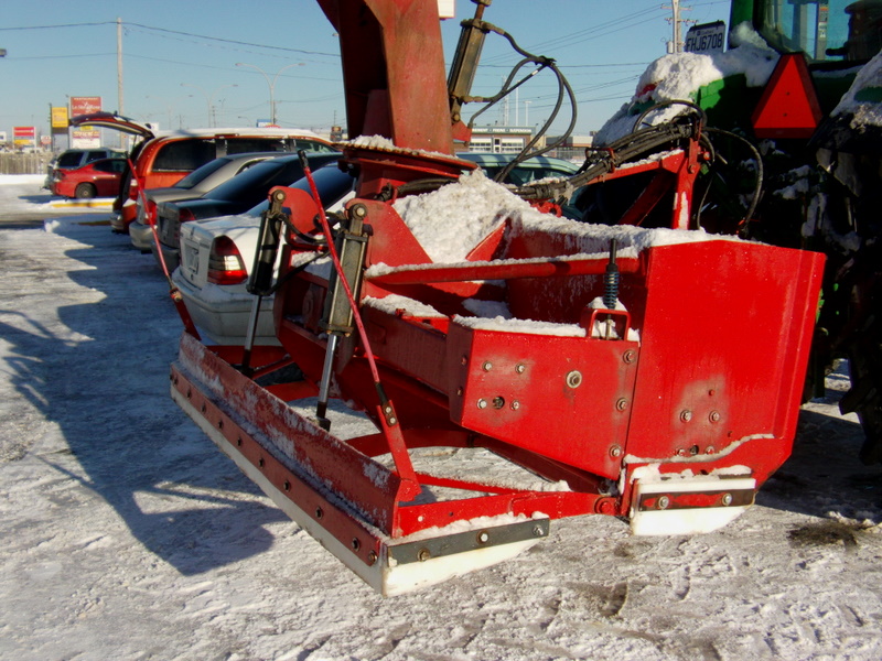

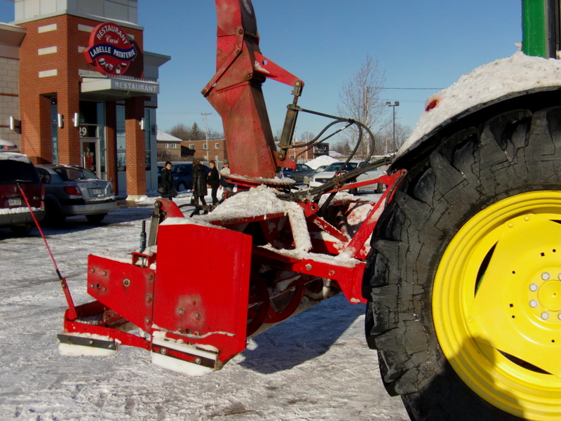

Just for ideas, I saw several of these pull behind 2 stage blowers in Montreal last week. Although one was clearing the parking lane on one street, I assume they're meant for driveway clearing where you back up to the garage, drop the little blade, pull ahead far enough to get the blower behind it and have at it.

I don't see why it couldn't be used as you suggest,just as long frame doesn't get snag or worse
   / pull behind 2 stage blowers #3
That is the only type I have seen being used in Ottawa as well, huge ones & smaller ones on sidewalks. Most of them have a bit of a blade on the back of the auger housing & they can push snow as well

I don't see any advantage besides the obvious, not haveing to operate in reverse.
But driving over and packing the snow before you try to blow it, seems like not the most efficient way to do it??? especially in heavy deep snow.
I have zero experience with 3 pt blowers though, so I may be missing something.
JB
   / pull behind 2 stage blowers #6
They work great. Dad had one for over 30 years, and packing what you drive on was/is a non issue! When it is time for a new blower, going pull type again. Lucknow, MK Martin are two of a few that make them.
Cleared two 1/4 + mile long driveways with it, never had a problem in the deep snow.

They are only available for the bigger CUT up for obvious reasons...ground clearance

I think they make a lot of sense, especially on farm and rural roads where cleaning down to pavement isn't too important.
Definitely cheaper and more versatile then a front blower...

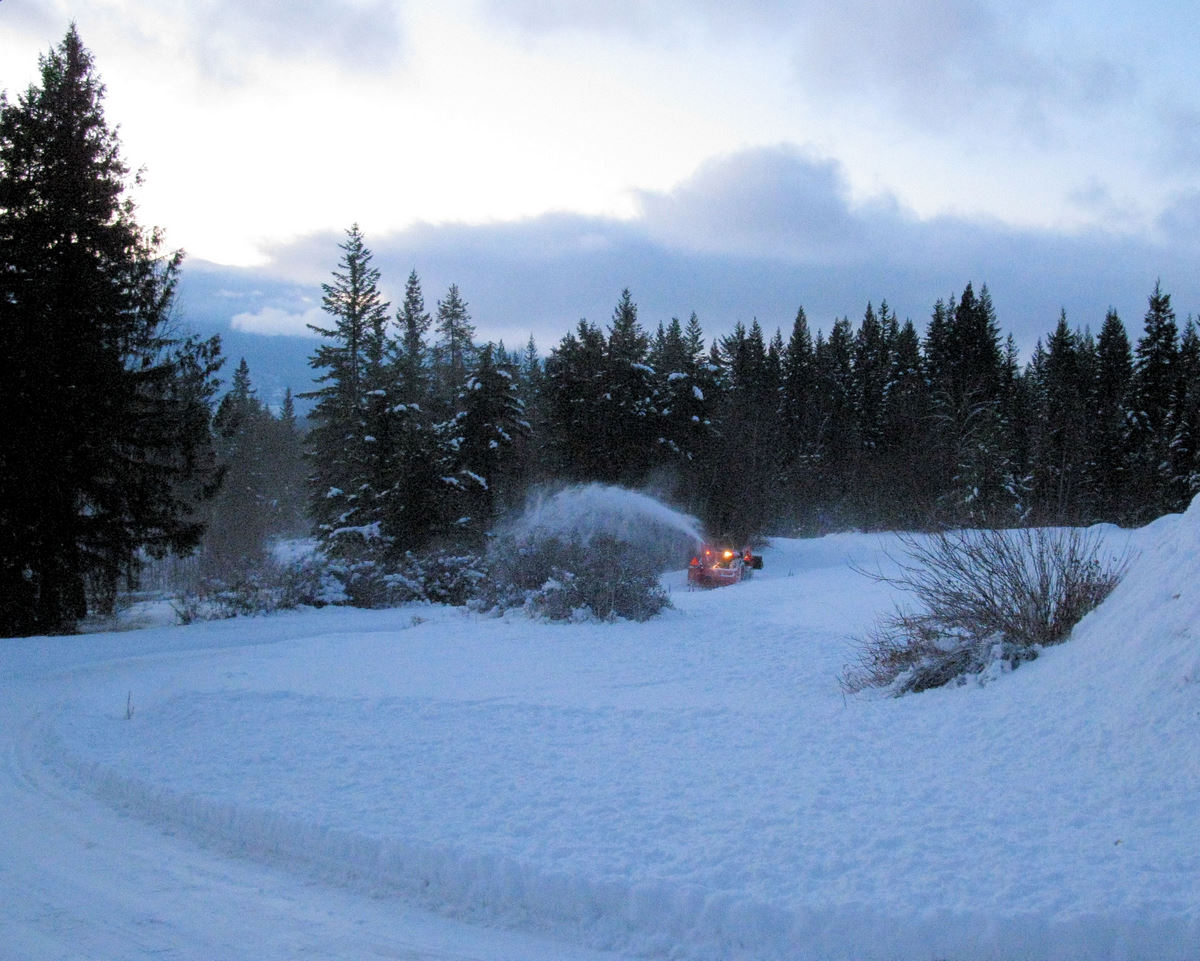

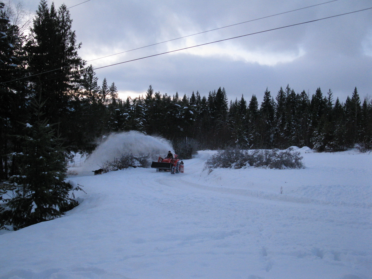

   / pull behind 2 stage blowers #11
I got a Meteor 75" for my DK35 this year. But I'm unfortunately waiting for most of the snow I ordered with it.:(
We have only had one decent (8"?) snowfalls and a few minor ones. But as RoyJackson mentions, for rural roads, it is amazing. What would have taken over an hour took me 15 minutes. And no looking back, except when adjusting the direction of the chute.
I used to clear a neighbour's driveway after heavy snows but quit because using my blade in reverse got too hard on my back. I'm now able to do that driveway again. Another neighbour clears it with a quad for light snows. But it gets too plugged up with a heavy snow or multiple moderate snows.
