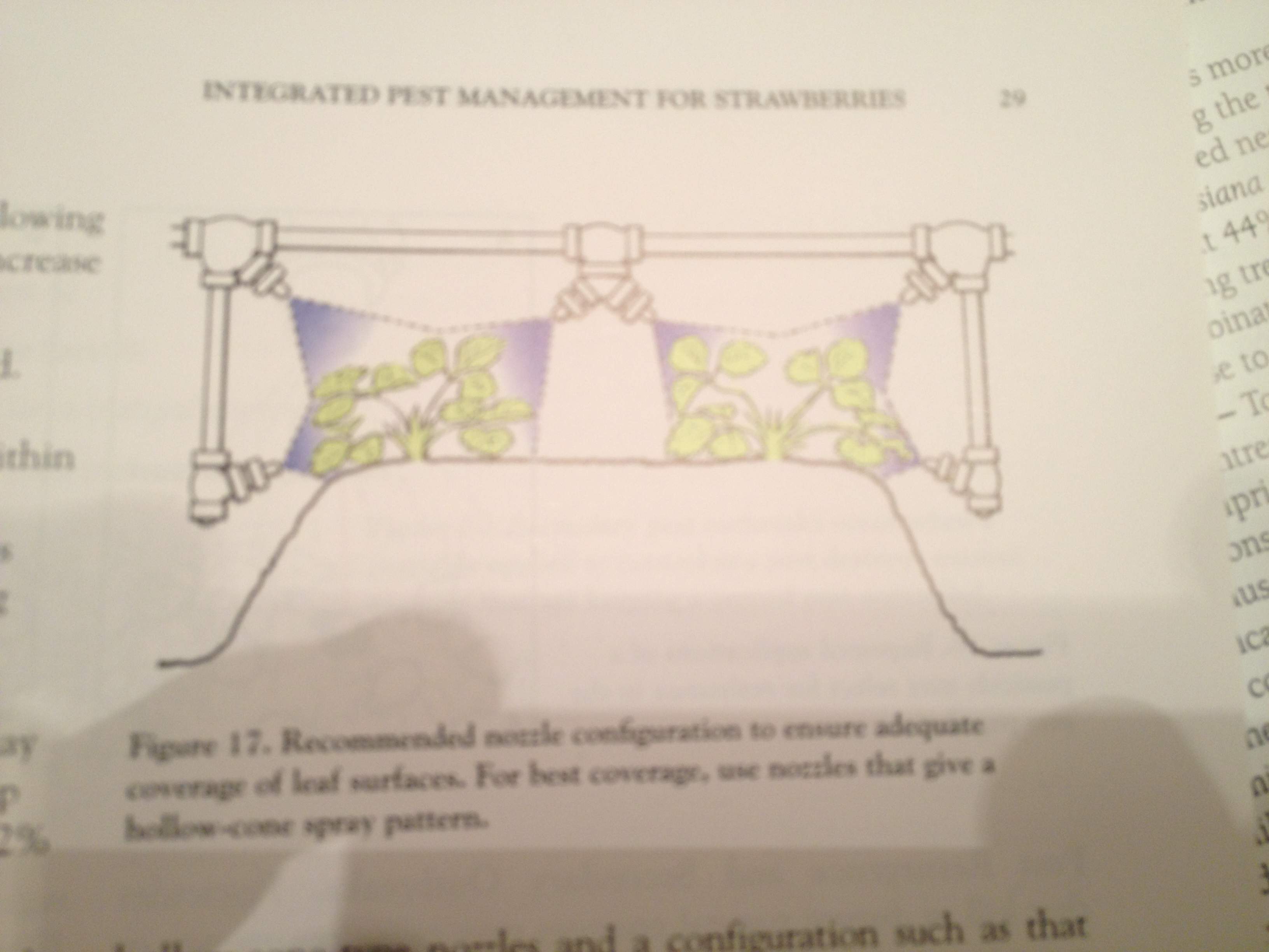

ROYCE: You can get a diaphragm pump for the pto they are just pricier and for what you seem to want to do it would be fine using a roller pump.
Reyer Farms: Look at the picture I have attached. I found this in the UC IPM manual for strawberries, happen to do consulting with berries. But you may want to get the book lots of good information on related pests and management. I would do a setup similar to that and use hollow cone nozzles. It will do some good coverage at recommended pressures for the tips. I would do a medium droplet size when looking up tips and their related operating pressure & related flow rate.
Also have you heard of strawberry bug vacuums? look them up if you haven't, there is good research supporting that they keeping pest populations from growing but don't count on them doing a knockdown to zero. Definitely something to implement into your integrated pest management scheme.
As for doing other crops what would be cool is having quick connect couplings between your supply line and different booms that you could attach for different crops. So basically have a three point basic sprayer setup ie: tank, pump, valving and then have a quick means to put on/off different configured hardline booms.
And you can never go wrong with hoods but it will ultimately come down to what you want to spend.
