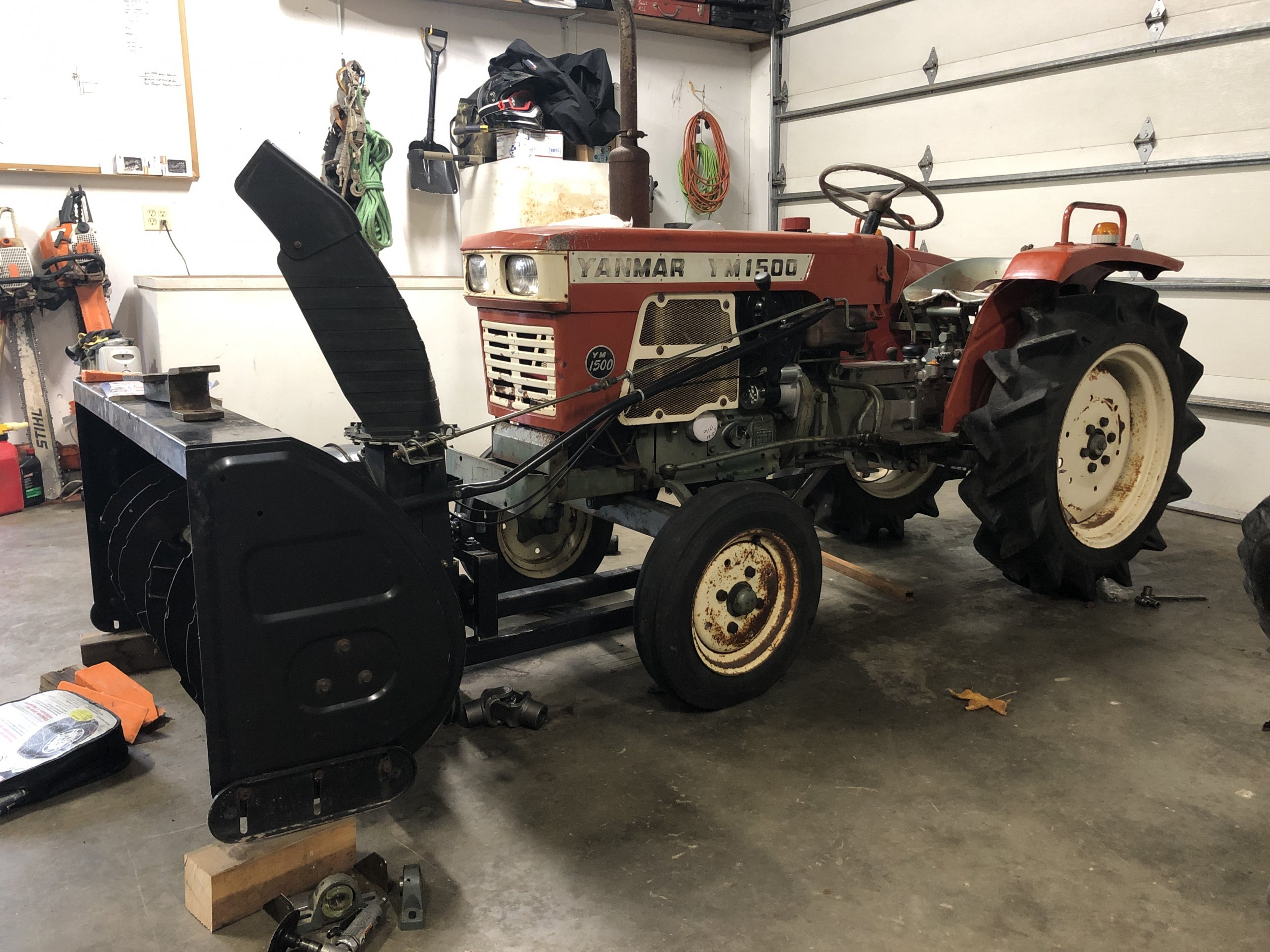

Hi all.
Been lurking for a while but finally signed up to start getting my feelers out for some snow removal equipment.
The quick specs. Roughly 3/8 mile driveway, slight down hill grade into the property, lots of parking spaces/turn arounds to keep after. Choice of a Yanmar 1500 19hp, or a Yanmar 2000D 4x 24hp, obviously the bigger tractor is the choice.
This is a vacation property so we wont be there all the time, that means possibly over a foot per visit of sitting snow.
The Woodmaxx 48” or 60” are my top picks as they look like real nice units.
My only real concern is looking back for over 6/8 of a mile (two passes), anyone using big mirrors to save the neck on those long straight stretches?
I also have a 5’ blade, whats a realistic depth of snow a guy could knock off the road with one of these?
Thanks!
Charlie.
If the tractors are HST you can run whatever you want for a blower. More PTO power means you can clear snow faster. Generally speaking, blading snow off, when possible, is way faster than blowing snow. You can see the speed difference in nearly any of my snow clearing videos. You'll want chains for your tractor as well. Front chains are often good enough for steering and remaining "unstuck."

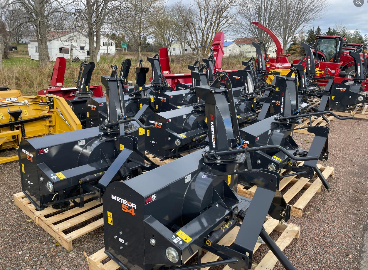

No, and I don't see any from a high quality blower mfg. either...
SR
I have one, it's well built, not low quality. Had zero issues with it, used it several winters now.
Pretty well every farm dealer here sells them whether blue, red, orange, green.
The Meteor line is more personal/farm use as opposed to the industrial/commercial models they also sell if you need something "extra"

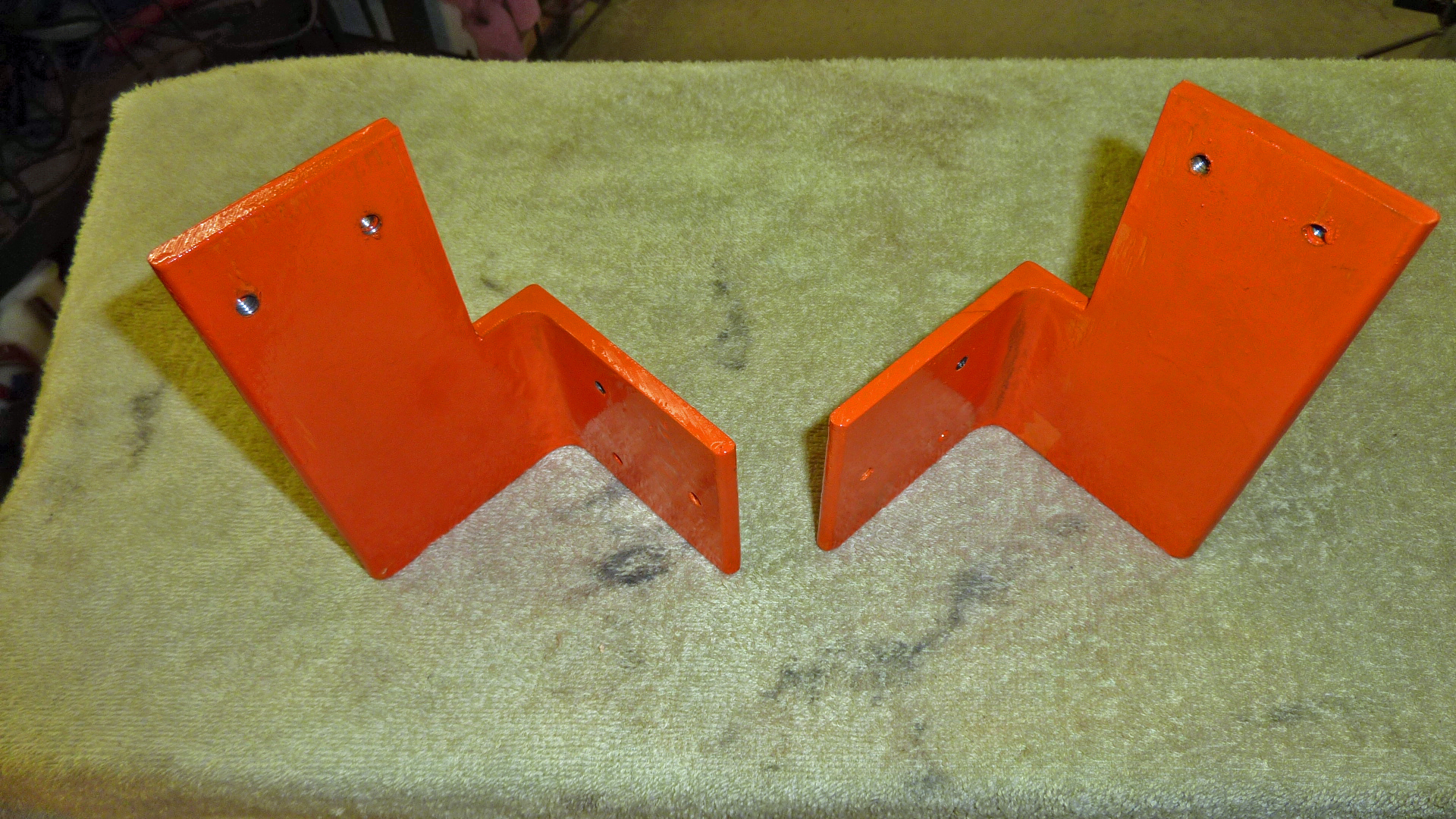

To relieve a sore neck from using my rear mount blower, I added these cheap $25 Jeep Wrangler mirrors. I made brackets to mount them on the the FEL towers of my L3010, L3430 & MX5800:
They work well and I can face forward 90% of the time while blowing in reverse. The come off with the FEL but that's something I rarely do in Winter.
