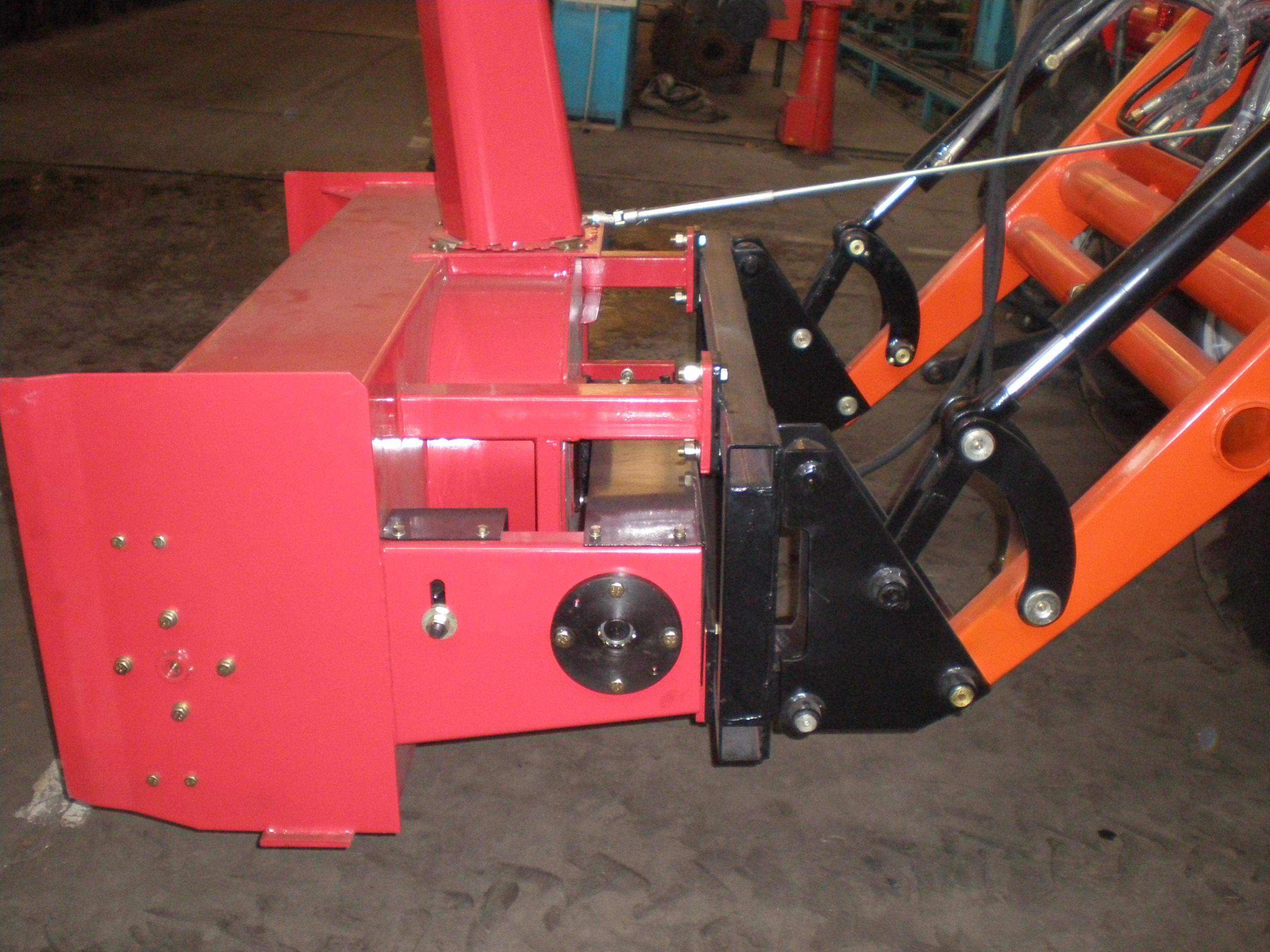

/ PTO snowblower
#9
Thanks for the suggestions. I think I will go with the scraper blade. I appreciate this discussion board and I am sure I will be following it in the future.:)
/ PTO snowblower #10
/ PTO snowblower #11

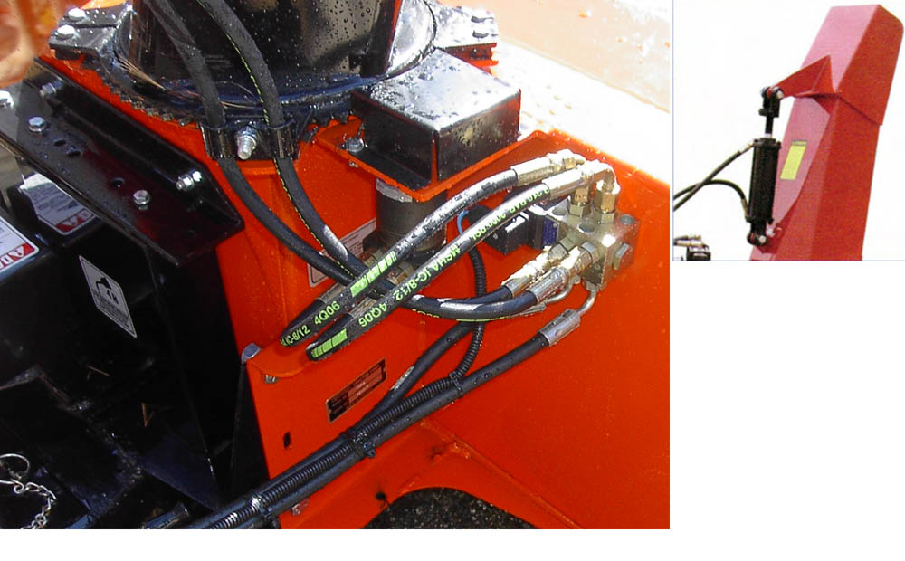

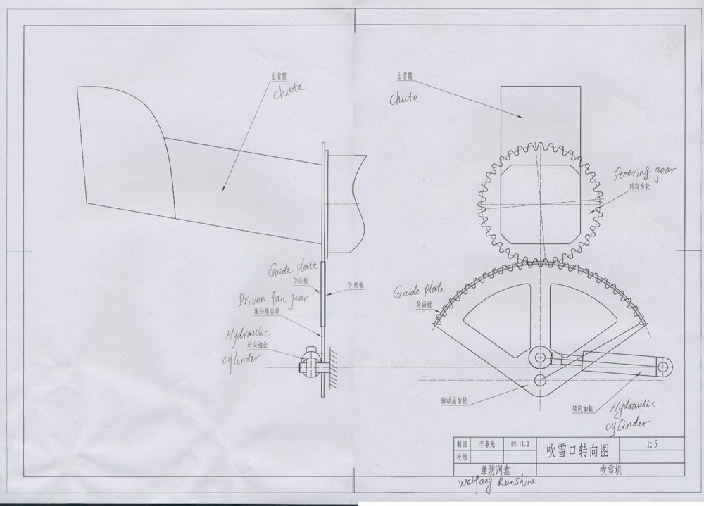

Adrian, that's a neat setup. Did you modify an existing blower or buy it like that? Tell us more :) Looks like your chute is a hand crank, any thoughts to adding an electric motor like from a windshield wiper or power windows motor?

Half the fun is building it. I had intentions of taking 2 lawn tractor type blowers, mounting them side by side on the front of my old Allis B and running a pto shaft to the front to power them. It would work on the back too. Then, I ran across a 5' Cub front mounted blower and mounted it all up, fired it up and found out the hard way that Cub pto's run backward of everybody else. Made a neat little snow sucker though. I never reversed the direction or built the dual blowers because I bought a 100 hp 4 wd massey with 7' rear blower that when time allows will be moved to the front.
about the chute adjustment,we now design a hydraulic motor or cylinder to rotate and adjust the chute and discharge part.:D
