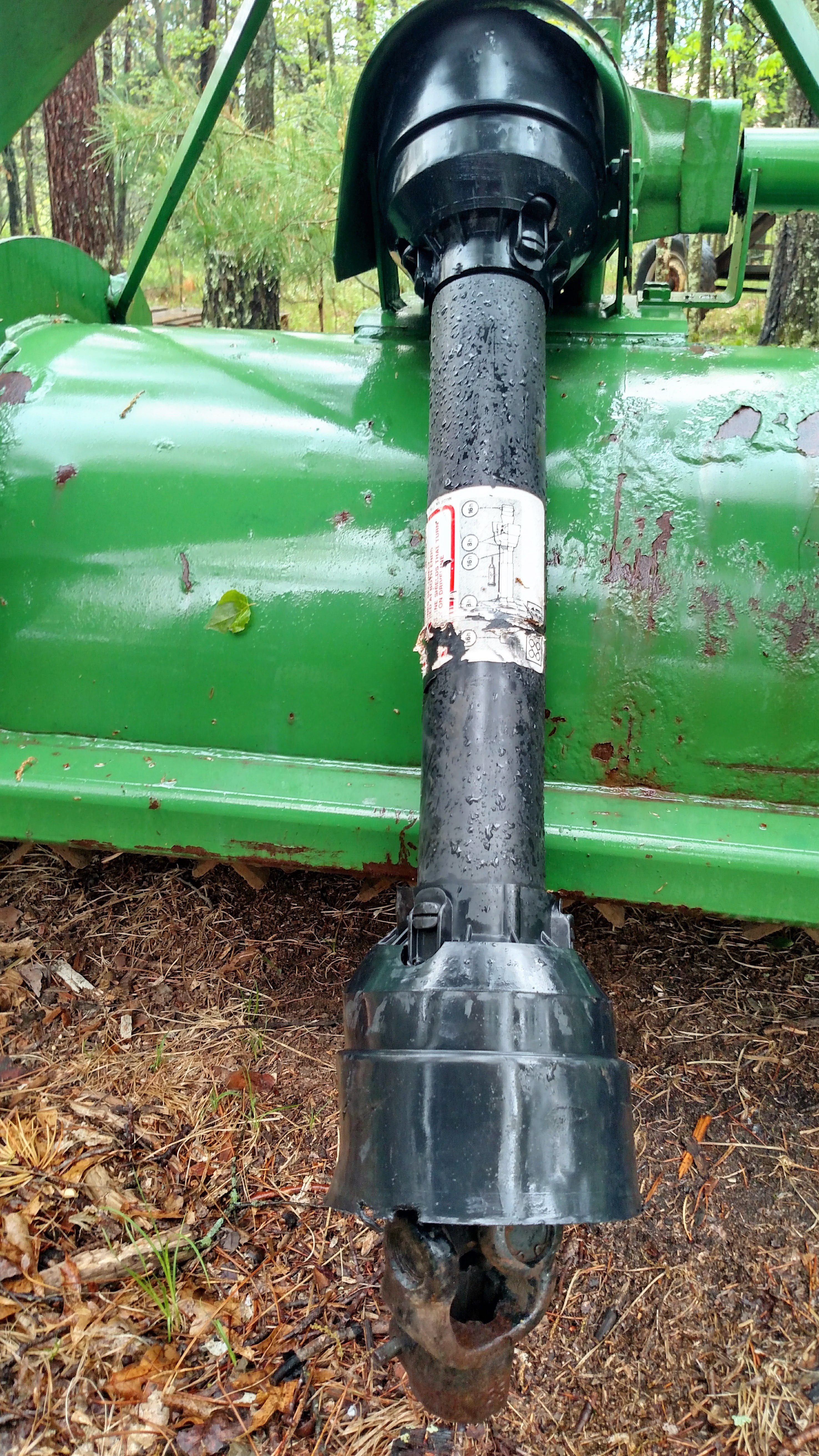

I belatedly picked up my flail mower. Last fall the seller put some grease on the PTO shaft and pushed the two halves together. So last week, I picked it up, and wanted to take the tractor half off so I wouldn't lose it in transport. We both pulled on it,and couldn't get it to budge. I hooked a strap on to the PTO and lifted the mower, but still no slide.
Any have any ideas on how I can free this up?
I don't think it is rusted together, I think the grease is making a very tight seal.

Heat it up. Secure the gearbox end & implement, get a few wraps of rope and a hitch on the free end, then use a comealong and a truck hitch/fixed point. Watch the tension and pull direction.

First thing I did was spray penetrating oil down into the connection. Next, I placed a scrap piece of wood against the yoke. Then, I applied light, repetitive taps of a hammer on the wood and got it moving and then off. Once apart I cleaned it, added grease and everything slid smoothly.
/ PTO Shaft won't slide
I've thought of and will try both approaches. The problem is the plastic guard pretty much obscures everything.

Wow--thats the most intact pto shaft I've seen for a while--no metal to be seen. Looks like you may actually be able to remove the plastic without damage. I'd dump a big pan of boiling water through it first if I wasn't keen on disassembly. I'm sure your grease hardened and pressure locked it together--soften it up and it should go. Had the same thing happen to an ancient sweeper I was lent--took an hour but has been fine since--it had no plastic remaining and rust in the mix...

Judging from the looks of the housing and the tractor end coupler, I think it's safe to assume there is probably rust involved.
Those plastic covers usually come off with a few screws, so there should be no need to destroy them.

I removed the PTO shaft from the flail mower. The plastic guards really obstructed the shaft, but I sprayed PB Blaster in the tiny gaps that existed and let the PTO shaft hang vertically overnight. I wrapped nylon tie down straps around the base of the yoke(s) and fed them up through the center (so it would pull straight and not pull on the universal joint). Then I chained it up between two large trees. I barely got tension on the come a long, and it slipped apart like butter.
Thanks for all the tips. I think what did it was
  • The PB Blaster
  • Having a Straight Pull
