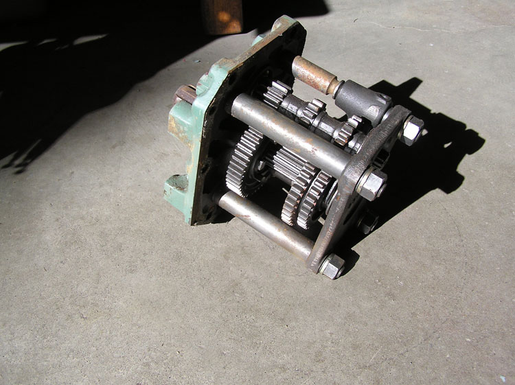

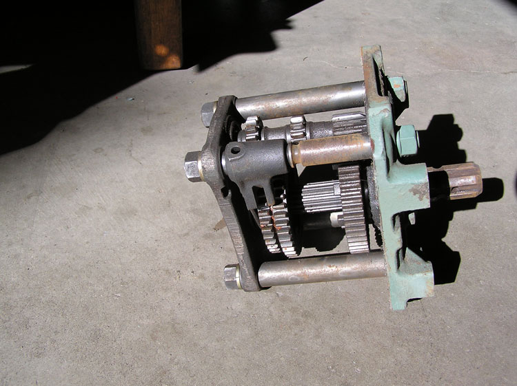

Hi..thought I'd post a follow up on repairing the pto on my 1610D.
I located a pto shaft (salvage) for 300.00 from one source. And the whole pto assembly (salvage) from tractor ernie for 429.00 I went with the assembly. It was in very good condition. I was able to clean it up with some parts cleaner, dress up the shifting arm shaft, an it was ready to go.
Pulling the pto assembly was super easy. Remove about 6 bolts from the plate. Then, remove a retainer bolt on the pto shift lever and pull it out about 3/8" to disengage from the shifting fork on the pto assembly and pull the pto assembly out. It's driven by a spline shaft about a foot long that uses spline couplers on both ends. one end couples to the transmission, the other to the pto. (sorry I didn't take pic's)
I couldn't get it to go back in the way it came out. I had every thing in neutral when I pulled it and the same on the reinstall but I could only get it to clear the shift lever and engage the fork properly with everything in the 540 position. It shifts into all speeds fine and runs smooth, no leaks. So..I'm back in biniss. a little poorer, a little wiser.

That is good to hear. Do you have a pic to post of the old broken one you replaced? Just for comparison. :)

Hi Bob
Im glad it worked out for you, I had that assembly sitting on the shelf for about 7 years, so I was happy to see it go.
Glad it all worked out in the end:thumbsup:
Ernie
