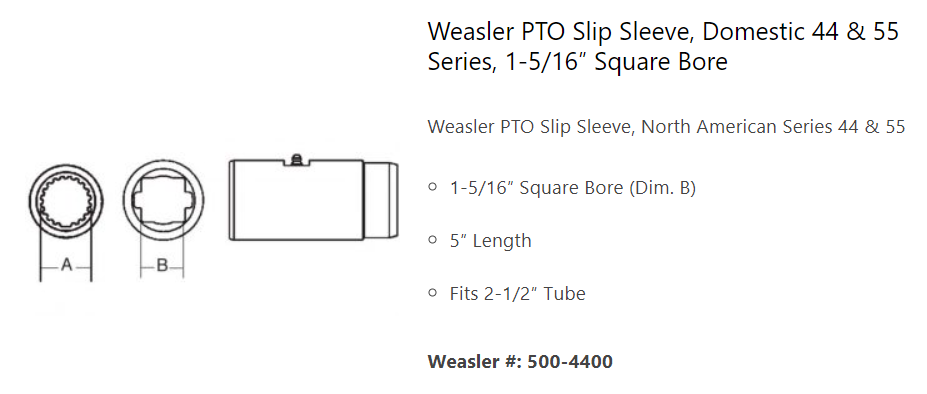

5'' slide into female shaft sleeve is sufficient as that 5'' is 100% of sleeve female internal length. Normally telescoping shaft length is maximum when tractor & Implement shafts are in a straight line. Exception is when crossing ditches & berms(terraces). Telescoping opposing u-joints are closer together in turns.
Changing tractor drawbar to a setting other than 14'' from end of tractor pto shaft(540 rpm) to center of tractor drawbar hole changes the symmetric relationship of the opposing u-joints telescoping driveline which can shorten expected lifespan of these u-joints. Incorrect tractor drawbar setting will cause undue vibration of telescoping shaft during short turns. If during 90% turn the opposing telescoping yokes don't bottom out but have slight clearances that the best one can do.
