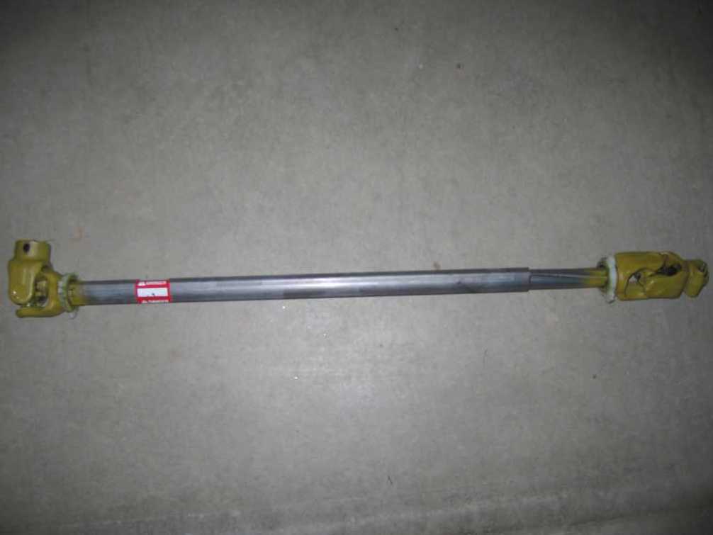

So I purchased a new PTO driveshaft for my 5' rotary cutter at a local dealer. I gave them my tractor HP, PTO HP, and implement specs. They recommended a Tisco P/N AB4111WY. You can see the details by entering that P/N at this link.
Tisco Parts Catalog
It is a 4 series PTO shaft, which is rated for 35 HP & 460 Nm (torque) at 540 RPM. You can see additional details at this link.

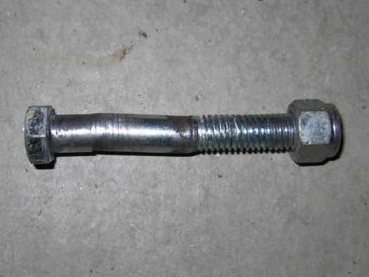

Despite the fact that Howse recommends a Grade 5 shear bolt, I was using Grade 2. However, they were popping way to easy and way too often. After I ran out of about 15 Grade 2 bolts (seriously), I decided to go with their Grade 5 recommendation. I have attached the results.

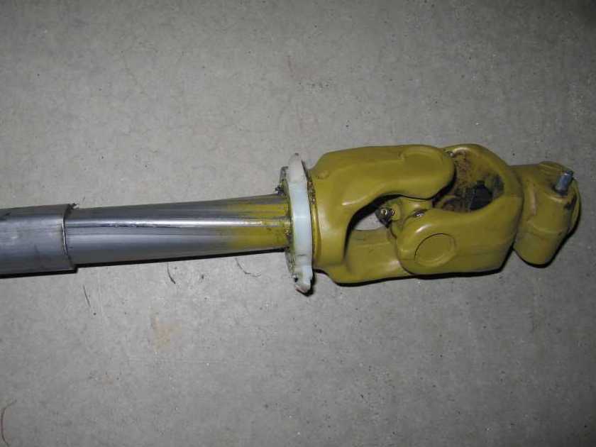

I noticed the problem when I went to collapse the PTO shaft and it would not collapse completely. I was hoping that it was a burr or dirt but I knew without looking that it was twisted. Removing the safety cover confirmed this.
I supposed it could have been worse. I could have damaged my RC gearbox or tractor PTO.
If my tractor is only 25 PTO HP, should a 35 HP PTO Shaft twist like this?
I was talking to someone about this and he said this is why you want to run at 540 RPM. He said that when running at lower RPMs, you are running at higher torques, which can damage things such as PTO shafts. Is this true?. It's a moot point though because I was running at 540 RPM the entire time.
I was reading online that typically a 5 series PTO shaft (48 HP & 620 Nm) is used for rotary cutting applications. Should I have purchased a 5 series instead of the 4 series? My dealer said that all his new Woods and Bush Hog rotary cutters are being supplied with 4 series drive shafts.

I still think that a shear bolt (Grade 2) is fine for field mowing. However, if you are mowing through thick brush like I am, then I think a slip clutch is a necessity.
Should I be using a Grade 5 or Grade 8 bolt on the slip clutch shaft holes?

What are you mowing? I've only seen a few PTO shafts twist like that. In ALL those cases, it was from way too much HP on way too small of a piece of equipment. OR.... Hitting a sawed off telephone pole sticking out of the ground about 8". ( I won't tell you how I know about THAT one.....:( )
That's why I always tend to favor slip clutches. Even with them, I tend to adjust the spring "stack height" just a hair on the loose side. I want mine to slip when I hit something. (Even if that means replacing the friction disc every so often.)
I'd start off with a grade 5 bolt in the slip clutch. See if it holds. If not, then try grade 8. I'd want all the protection I could muster after seeing that shaft.
When in "operating position", was that shaft extended (retracted) to about the position you show in your pictures? Or was it extended further?

I was mowing field and brush. I hit a few rocks but nothing noteworthy. The brush was 1-2" thick, maybe a little more in some areas. I did hit a couple of branch clusters that may have done this. The branches were only 1-2" thick but they converged to a stump that was thicker (maybe 4-6"). The tractor bogged down a little in a few cases but it never stalled out.
On level ground, the PTO shaft was completely overlapping with only an inch or two to spare on either side. Of course, I was mowing on some pretty uneven ground where I was backing up and down bankings, which is the only time the shaft could have been this exposed.
Do you think it is a faulty PTO shaft that isn't to specs?

Can't say for sure, but I'd venture a guess that shaft is at best MARGINAL to specs. Sometimes equipment like a bush hog will just "take a hit" that does things that can't be helped. You may hit the same rock 1000 times and that one magical moment may be the one time that breaks something. Again, that's why I like slip clutches adjusted to the least possible resistance. On mine, I adjust spring stack height 1/32nd" loose from manufacturers recomendation. It doesn't slip under normal loads, but will slip at the slightest "over-load situation". I bought an extra set of friction plates when I bought the mower, planning on them wearing out somewhat prematurely. (I do the same with bush hog blades. Buy an extra set when I buy a new mower) Spare parts are my hedge against breakage. In my years of experience, I rarely break anything if I have replacement parts on the workbench. It's always that "on back-order for 7 months" stuff I break.....:(

The more a shaft is extended, the more vunerable it is to twisting - the grade of the shear bolt won't help you here. Everything I've read by manufacturers clearly indicate that a properly-sized shaft should ahve more than 6" extension (of the inside shaft) when the driven equipment is in the working position. This 6" length is usually achieved after following their "How to cut your PTO shaft". They all start out recommending you lift the implement with the TPH until the tractor PTO spline and the implement transmission input shaft are perfectly parallel with each other. That's the point at which the shaft will be compressed to it's shortest length, and represents the baseline length from which you eventually make the final cut. Cut it too short, and the inside shaft will extend too far when the implement is on the ground. At that point, you lose more than 50% of the strength of the double wall.
If/when you have a shaft of the correct working length, and a slip clutch properly adjusted to match your tractor's PTO horsepower, the grade of bolt you use to secure the slip clutch to the implement input shaft should not matter. If everything else is done right, the clutch should slip before there's enough torque applied to snap that bolt. With a properly adjusted clutch, it's NOT a shear bolt any more, it's just another fastener.

I followed the instructions for cutting the shaft to length. As you can see from the picture, I have much more than 6" of overlap; it's at least 24" or more of overlap when the rotary cutter is on level ground. Also, when the rotary cutter is on the ground, the shaft is almost fully collapsed with only an inch or two of inner shaft showing.

But back when the shaft was originally cut to fit, the first measurement should have been with the implement lifted (by the TPH) so that the tractor's PTO spline and the implement transmission input shaft were on a horizontal plane. At that point, there need be no more than 1" of extension (of the inside shaft).
So. If you state there's only an inch or two when the implement is actually on the ground, your shaft may still be too long. The distance to the working position is at an angle, when you raise the implement the distance gets shorter. When the distance gets shorter, the shaft must collapse. When you run out of "collapse length", something's gotta give. As such, you may have bent it when lifting to - or past - horizontal. Whether or not that's related to the twisting I can't say. Either way, it's not good.
The bend in that shear bolt photo looks like it's moving around while rotating. That can be from it being the wrong diameter, or the wrong length. You say the holes aren't egged out, so make sure you're using a 1/2" bolt in a 1/2" hole. Too long, and it will move back and forth in the hole - bending at either end (which is what I see). Make sure that self-locking nut is snugged up all the way to the clutch housing, so that the bolt can't move back and forth in the holes.

In cutting the shaft, I followed the instructions as outlined in the Bush Hog Squealer manual as well as the instructions given my various members on this site.
Everything I have ever read has said there should be a minimum of 6" of overlap. This means that the inner shaft should extend at least 6" into the outer shaft, no less.
It seems to me that you would want as much overlap as possible, more inner tube within the outer tube, in order to gain the double wall stength that you are talking about. Less overlap = less double wall strength.
I had the implement spline and tractor spline on a horizontal plane when I measured for the cut (i.e., the shortest distance). With that said, I'm not sure this was the shortest distance. It almost seemed like the shortest distance was when the implement was raised beyond the horizontal plane where the implement comes closer to the tractor.
The difference between horizontal plane and implement ground level, in my case, is only an inch or two. I tested my implement through the full range of motions and it never fully collapses or binds up. That is, I can always see a little of the inner shaft so it's not too long.
The bolt is the exact size as specified by Howse and the nylock nut is tight. With the bend in it, I had a very difficult time getting it out of the hole.

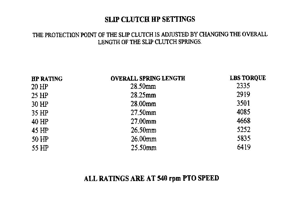

The new slip clutch should come with an instruction sheet, but that's not a given. If not, the chart I uploaded might help. Be careful though, these spring lengths only apply to the 55hp rated clutch. Confirm the PTO horsepower rating of your tractor, consult the chart, adjust the spring length accordingly.
LIke I said before, I purposefully select implements/clutches that have splined shafts and receivers. The type that just bolts to a smooth transmission input shaft needs a lot more attention. That is; at least semi-annual disassembly cleaning, spring adjustment. Cuz if/when a smoothbore slip clutch freezes up from neglect, you've automatically defaulted to a shear bolt configuration again.

Thanks for the chart! I will cross-reference it with my manual, if I get one.

Isn't this a good thing? At least it is falling back onto a Grade 5 shear bolt. With a spline shaft, you would have no additional protection in the case that the slip clutch seizes.

I don't consider it a good thing. Among other things it still leaves you vulnerable to bolt hole damage. Then there's also the chicken and egg question of which can/will take more torque - the clutch or the bolt? Conversely, which will give first? Remember I said that in the smoothbore type, all the torque is initially transferred to the bolt - which in turn transfers it to the section of shaft that's got a hole in it. In the spline type, torque is delivered directly along the entire mating surface of the input transmission shaft.

I just received my slip clutch from Agri-Supply.
The sticker on the slip clutch says to use "GRADE 8 BOLTS ONLY" on the gear box and driveline connections. I think I will use Grade 8 on the gear box side but I may still use a Grade 5 on the driveline side.
There was no manual or instructions included, which is odd. I'm still left wondering how to maintain it properly.

1, Wow.. now that's a twisted shaft...
2, I think I'd have rather popped another grade 2 bolt than bent the shaft.
3, I think i'd have chipped for a bigger shaft...

Just be careful when adjusting any slip clutch to know the CORRECT spring stack height for YOUR clutch. I bought a new Bush Hog 286 cutter last winter. The manual list's 2 different brands of clutches as possibilities to be installed on that model. In addition, one brand had 2 different designs available. And all that was for a specific HP rated clutch. The possibilities are endless as far as correct adjustments. (Stack height's varied as much as 1/4" between different brands to achieve same end results)

I didn't get a manual or any instructions with the slip clutch. I checked the manufacturers website but I couldn't find anything. I contacted Agri-Supply to see if they had anything but I have yet to hear from them.
I believe it is manufactured by Eurocardan but I'm not positive.

That spring length chart I uploaded is from Eurocardan. But again, it's for the 55hp splined shaft version - they actually make at least 7 variants. Consider that if/when you refer to it for adjusting your spring length to match tractor PTO hp
If it helps, there catalog is at http://www.eurocardan.it/documenti/Catalogo_prodotti.pdf. Slip clutches are in the section that starts about pg40. Having said that, they all appear to be splined on the female end. SpeeCo though, I don't think I've ever seen a slip clutch from them. Over-running clutches, yes. slip clutches, ??
