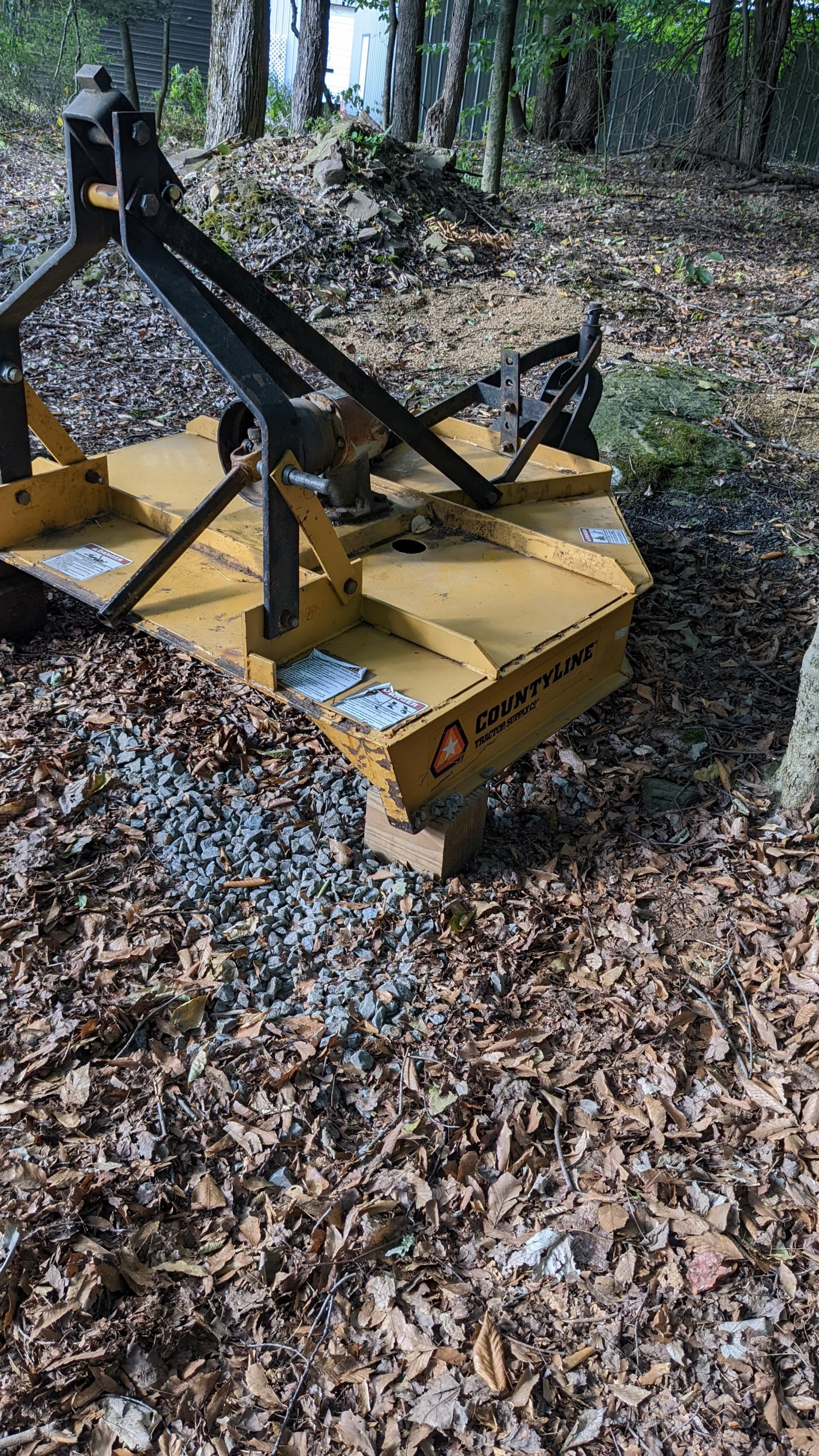

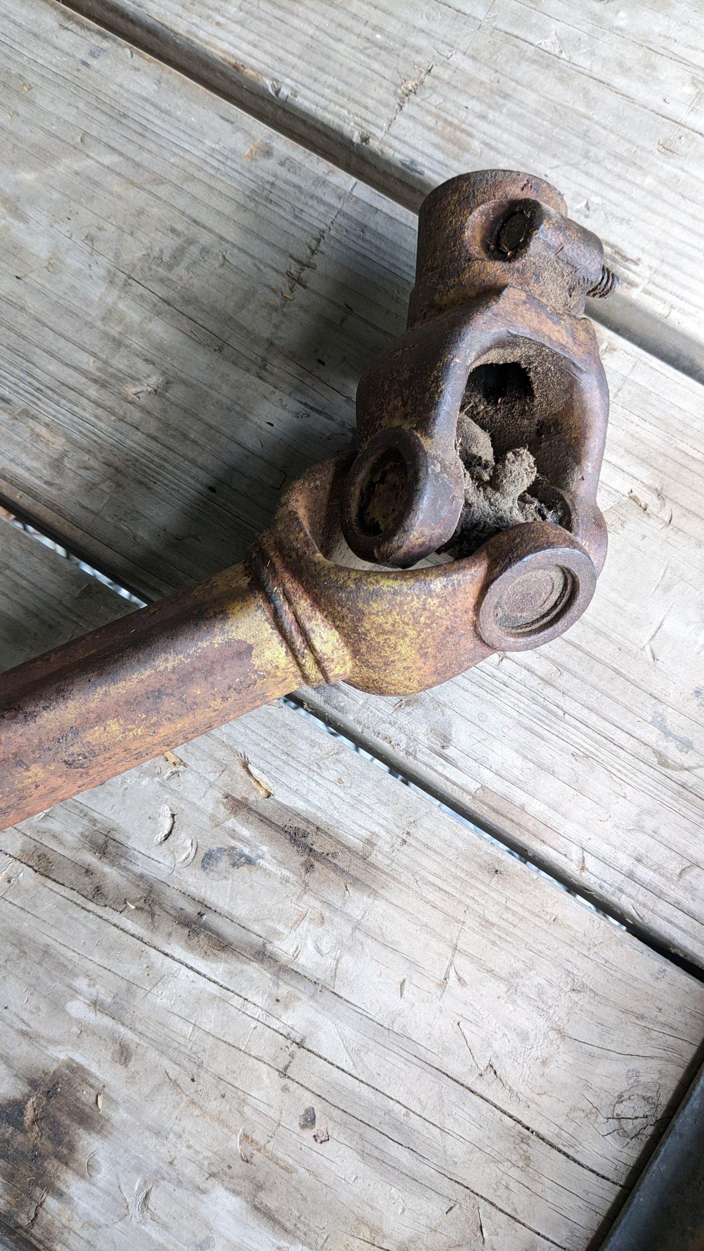

Hello there, I am relatively new to the tractor attachment PTO driveshaft game and could use some advice / help.
I recently picked up a used Countyline 4 foot rotary cutter for my New Holland Boomer 20. After I got it home I gave it a good once over to make sure it was good to go. One of the things I noticed when I was buying it is that there was no PTO shaft cover, just a bare metal shaft. I thought that was no big deal and I would just buy a universal shaft cover to put on. Unfortunately all of the aftermarket ones that I saw used a groove in the yoke for the guard bearing to sit in. As you can see from the pictures my shaft yokes have no grooves. Can someone advise how I could install a guard on this shaft or am I going to have to buy a whole new shaft?
Thanks in advance for any opinions

I was checking out the same problem one time. IIRC........the sales person told me that the parts were about as expensive as buying a whole new shaft. .. So, at that time, I just bought the whole new shaft. Today, I'd probably just run it without the guards.

Thanks guys, I just thought maybe I was missing something on a way to attach a guard. I am the only person running it and I shut the PTO off before I get off the machine so I will likely run it as is. The guy I bought it from said it was 7 or 8 years old so I have to assume that is not the shaft that came with it. I would have thought that new of a machine would have come with a "guarded PTO"
Thanks for the replies

In addition to the guard bear in mind that if the PTO shaft is not securely latched in place on the drive from the tractor it is possible to get the mower spinning and have the shaft slip off the drive. The mower will then keep it spinning with the shaft flopping all over. A cover will not prevent this but the flopping can damage the shaft to the point it will need replaced.
