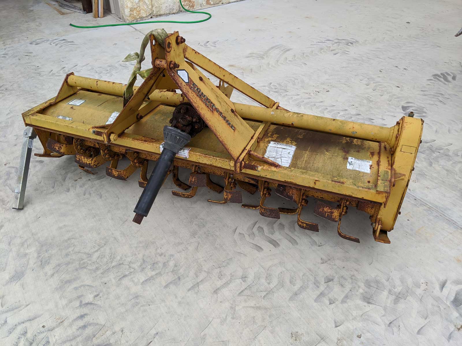

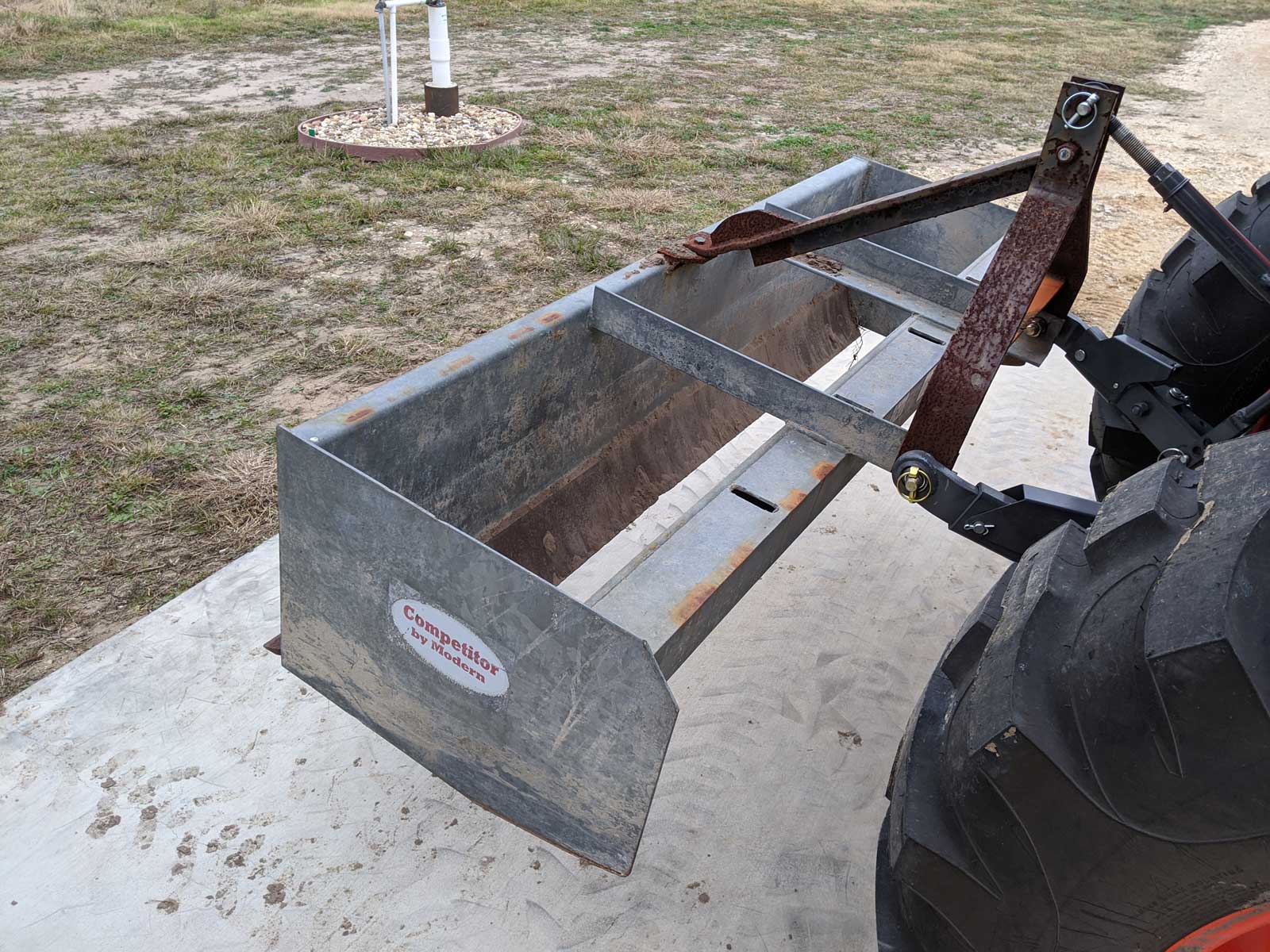

I purchased a used 6' County Line tiller and a used 6' box blade today. The tiller is missing the tractor portion of the PTO shaft. Looks like I can get one from TSC for around $120. Does anyone know of a better place to buy one? It is the triangular shaped shaft. I wasn't really planning on buying the tiller but he made me a deal on both that I felt was pretty good so... Box blade is on the light side, has no shanks with it and will not work with my QA, but better than no box blade I think.

It appears the slip clutch is already on the unit, you just need need the other half of the shaft. Don't forget to adjust the slip clutch before using it. Most are frozen from sitting.

My thought was to look for a used tractor side shaft that fits and then loosen up the current slip clutch and try to get it to break free. It is pretty rusty. If I can't find a used shaft and have to buy a new one I will probably just get a new clutch also. Just have not found anywhere in this area for used parts yet. Checked CL and fleabay with no luck.

Check Agri Supply. I bought one for the same type tiller with slip clutch a couple years ago. I think mine was a series 4 shaft. Make sure implement end of shaft matches gearbox(splined vs smooth). Less than $200.00 and comes with shields.

Checked local dealers today and they all wanted to sell me a $300 PTO or make the front half for $200. I called and talked to Brooks Ag Parts in Ohio and they were very helpful. What I need is coming and the cost was a bit over $100 with shipping. $300 would have been 1/2 what I paid for the whole tiller! $100 I can handle. Seems no one here fixes things they just throw money at it.
