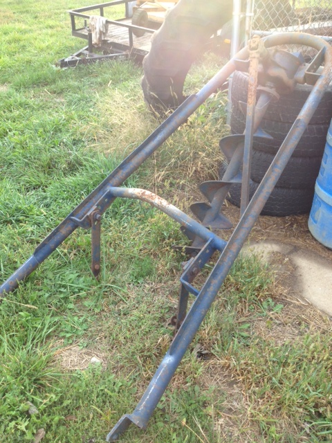

I have an old Twin-Draulics brand post hole digger which looks like it may have came off a older Ford tractor due to the blue paint. It has set spacing on the lower arms and has two bars that can pivot for I assume the top links on each side where the 3 pt. top link would normally go. My question is that the width of the lower arms are too wide for my compact tractor (Mitshbishi Bison 30 hp Diesel). Has anyone ever modified (cut out sections and shortened and welded) one like this to fit and convert to 3 point?
Or if anyone knows what tractor this would fit.
width of lower arms are 35 1/2" and top links are 23" apart.
Twin-Draulic model #ACF Serial # 558

Thanks to everyone for the info. looks like I can modify according to the YouTube one.
