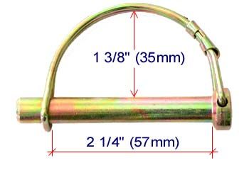

Unless Howse has a proprietary pin, I'm surprised your farm store didn't have one. Or doesn't yours look like this

no it doesn't look like that. It is a pin , Spring ands washer that is built into the PTO Female spline receiver. The shaft on my tractor doesnt have a hole through it so I have to have a pin that locks the PTO receiver into the spline shaft on the tractor.

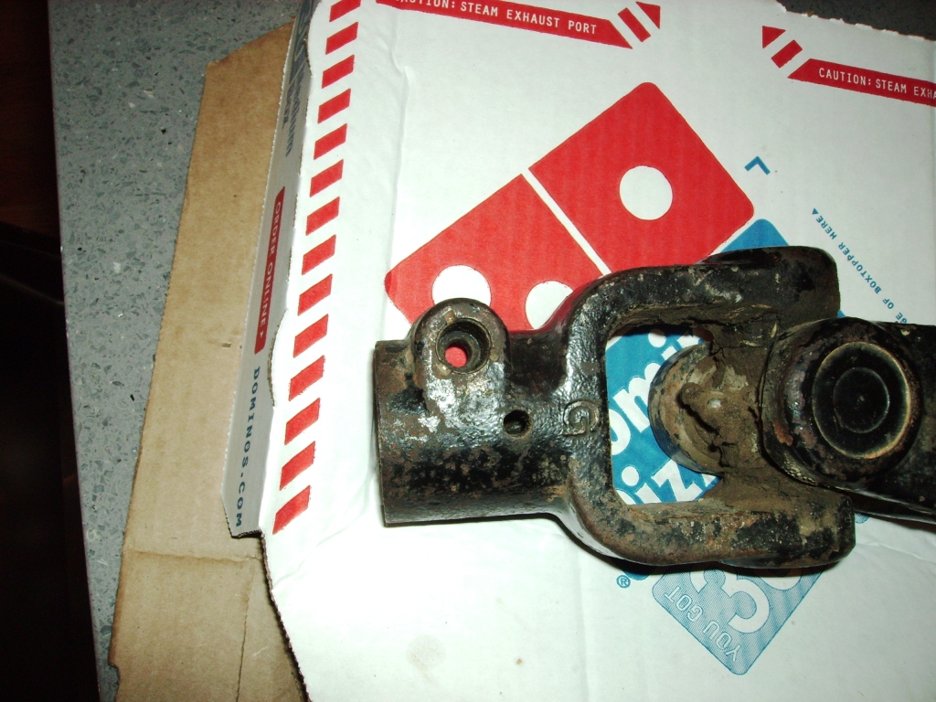

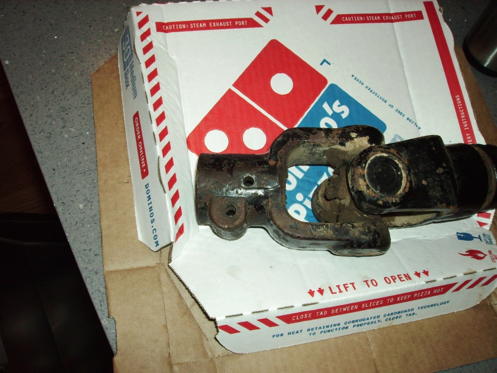

Enclosed is a picture of both side of the PTO shat where the pin goes In. As you can see one side is very small and the other side is quite large. If any one has some suggestions where I can get a pin kit for this thing let me Know. I will need the two sized pin , spring and the washer which needs to be inserted in the groove for it and have the cast punched to hold it in.

I'm gonna suggest that it might be easier just to replace that half of the yoke, rather than waste time and fuel looking for just the locking pin hardware. PTO driveline components (to include yokes) are available at most full service farm stores too.

just change the pto end that fits the pto splined end i had a howes finish mower that did the same thing was easyer to fix than looking for a repiar kit

TSC's website lists 6 different repair kits and they have a good selection of yokes. What they actually have in the store can be pretty hit or miss. I'd call them and ask them to check by SKU and if they don't have it ask them to order it. My store usually takes about 3 days.
