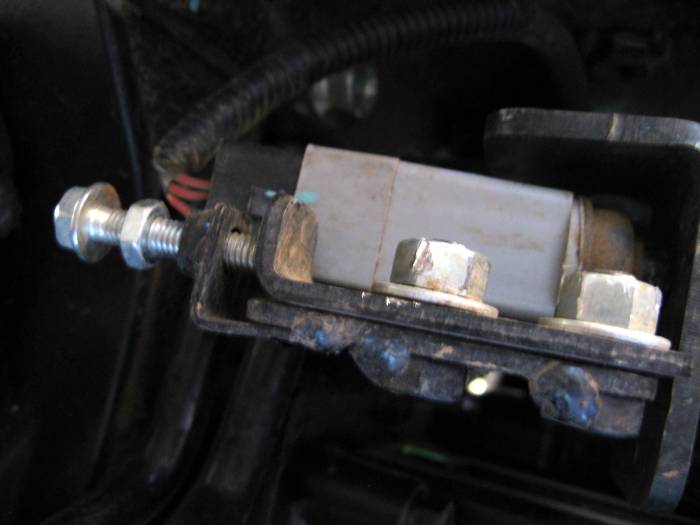

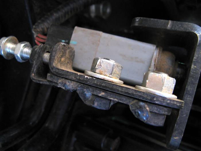

Problem solved; I think. Testing, it's okay now. PTO engages positively.
Attached are pictures of the RIO switch that was the problem. Thanks to all who pointed me to it. The adjustment bolt attachment on it had been bent, and the switch bolts had to be loosened to go towards the rear of the tractor; the bolts on it were very tight; cannot figure how the switch got moved. In the pictures, the little lock nut on the adjustment bolt isn't back in place. I screwed it back in place after the pictures.
With the switch all the way towards the front, the PTO switch would maybe go on, maybe not. The switch is physically located towards the right side of the 4wd shaft, as its actuator is the reverse lever on the forward/reverse pedals.
