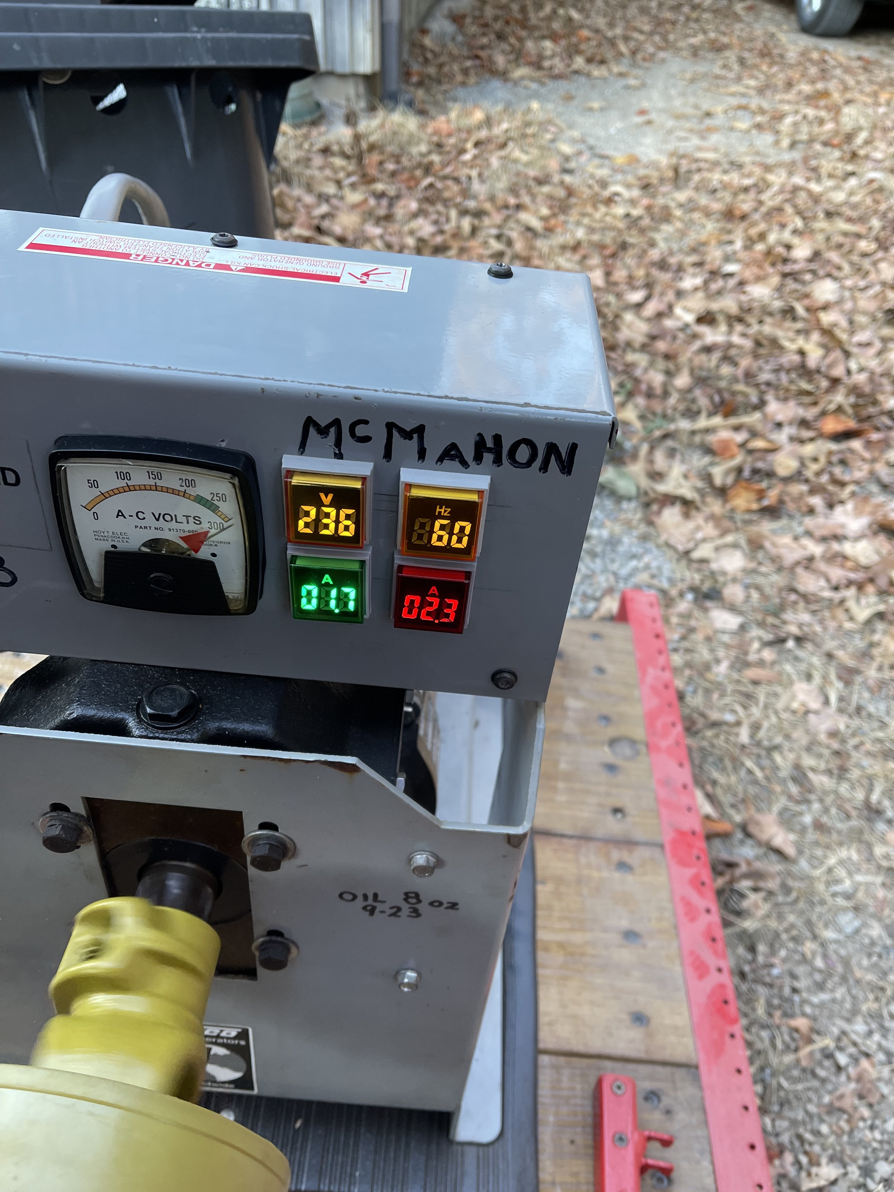

I have limited expertise with generators. Bought a used 10K Winco. Set up to use a found the OEM voltage gauge to be off. Reading higher than actual voltage. Hertz was low -58. Contacted Winco about problem. Technician said voltage gauge bad, no adjustment. New gauge >$100. Said hertz is as important to monitor as voltage. Opted to add additional gauges, volt, amps for each leg and hertz. Digital gauges are about $8ea and are within 1-2% of my Fluke multimeter.
Also made up a little box to read voltage and hertz indoors by the TV. Amps on the media circuit. Leave it connected with normal power 24/7 and is surprisingly steady.
Test runs once the generator is up and running at proper hertz and then connected to the house, the power is steady even with various loads switching on and off. Steady output even at rated capacity. Got the pto generator to especially run the 240v deep well pump.

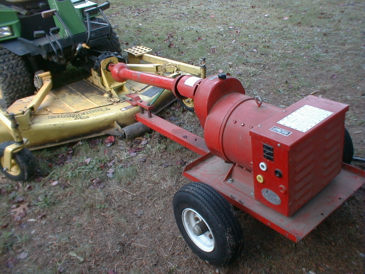

I run my 45kW Winpower off my 22hp (when new) JD F935 lawnmower. All I need is a Kill-O-Watt to show frequency and this establishes throttle position. Sure, the propeller heads will point out that the 22 hp is only good for 11kW. So what? I obviously am requiring less than 11kW to survive. BTW: Why do all the usual replies say "they might need their tractor for other things during an outage" ??? I don't run it full time. Maybe just every few hours as necessary for heat or water or refrigeration. Why do folks think it has to run 24/7 ? Good grief....
BTW: the gearbox I use to convert the 935's 2200 rpm pto to 540 reverses the 540 pto rotation direction. OMG !! This sounds like blasphemy...
