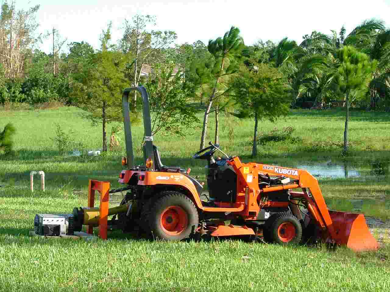

I like PTO gen. I use it 24/7 during last hurricanes. /forums/images/graemlins/smile.gif

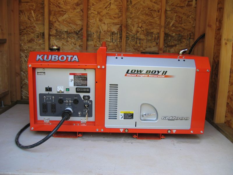

At our house in the California Sierra Nevada mountains, we have three to four power outages per year, usually one of which lasts more than 6 hours. I chose to throw the whole house onto standby power rather than have some things work and some not.
I decided that a Diesel was right for me. When I had my shop put in I hired an electrical firm that specialized in stand-by gensets wire in a Zenith-GE automatic transfer switch that I had bought on-line.
The genset I selected and installed was a Kubota GL-11000, 11KW. More Kubota genset info here.
This guy here on eBay at EngineCom sells these at a fairly good price. I found my local Kubota dealer would come very close in price and chose to buy locally. But Enginecom is a good barometer for generator prices.

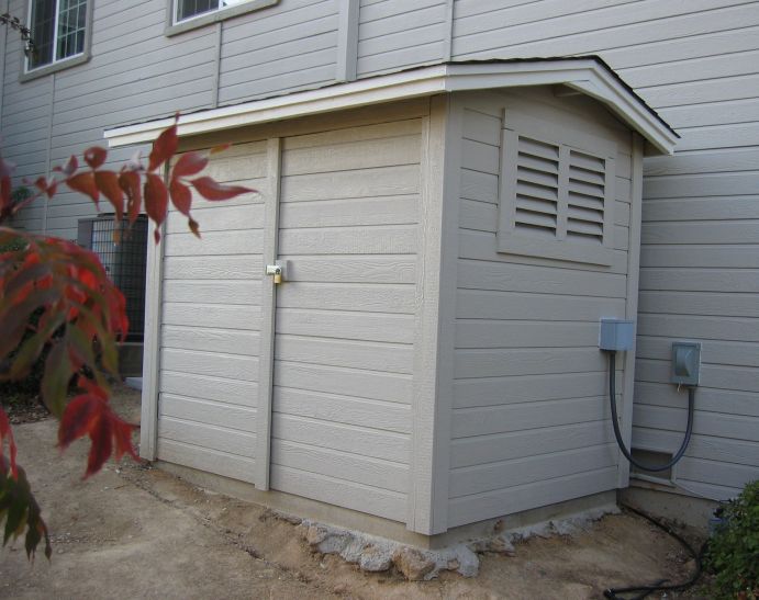

I built a shed to enclose the Generator set and quiet it down even more. Not shown here is the insulation I installed after the picture was taken.
Waste heat was a problem and I installed two attic fans blowing the heat out of the shed. I simply plugged the fan motors into the genset. No complicated switches or thermostats, they come on when the generator starts putting out power.
This wasn't an inexpensive solution. But, it is reliable. I'm on the road a lot with my job and the system has worked perfectly for my wife several times now.
Here is a picture of the Genset.

Here is a shot of the closed generator shed. There are equal size inlet grates down low on the opposite side of the shed.
