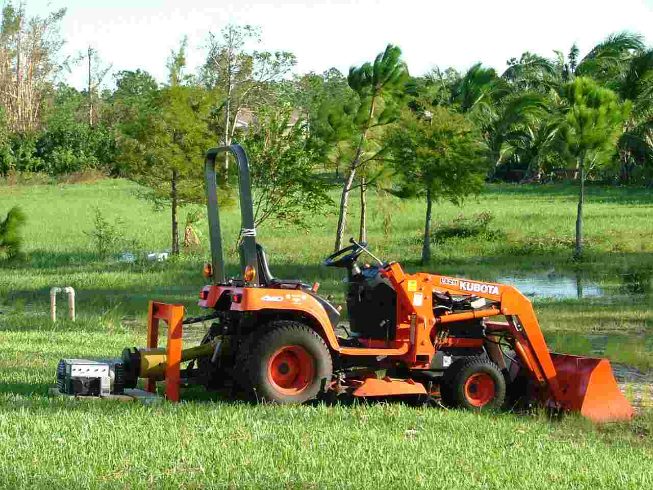

Is the Northern Tool 13kw generator the way to go or is there something better or cheaper I should look at? I'm also wondering how good the waveforms are that come out of these. Any issues running computer equipment? Thanks.
/ PTO Generator Suggestions #2
That is the one I used, very good unit.
