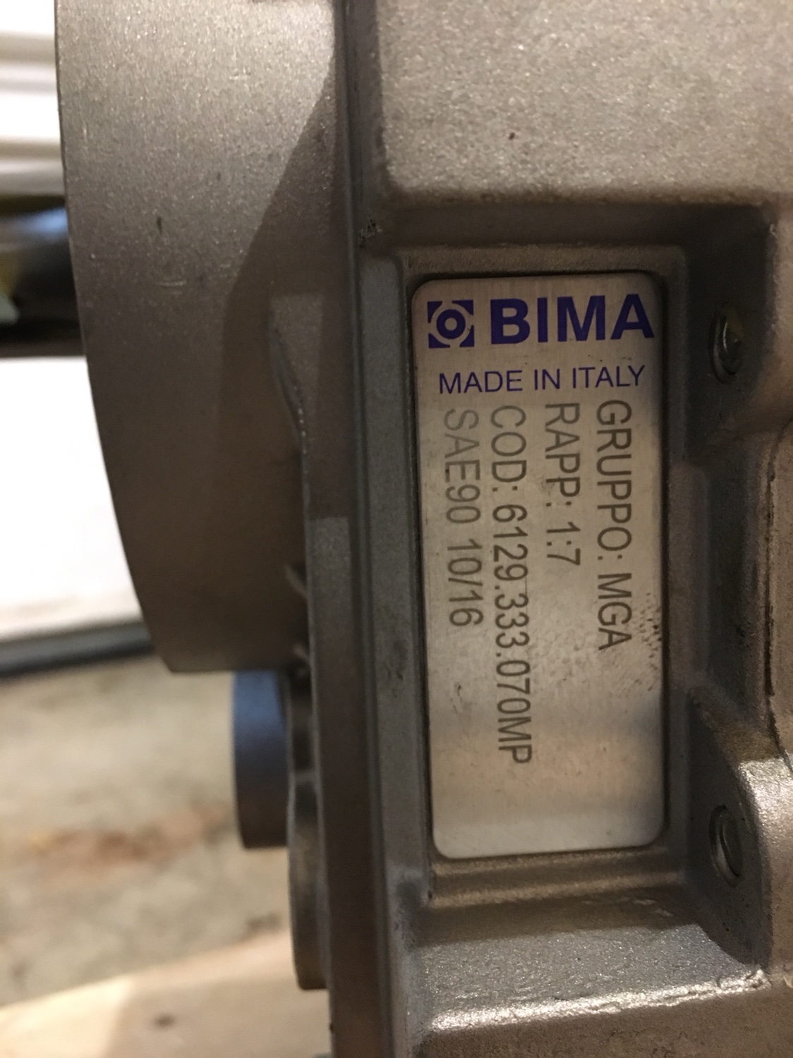

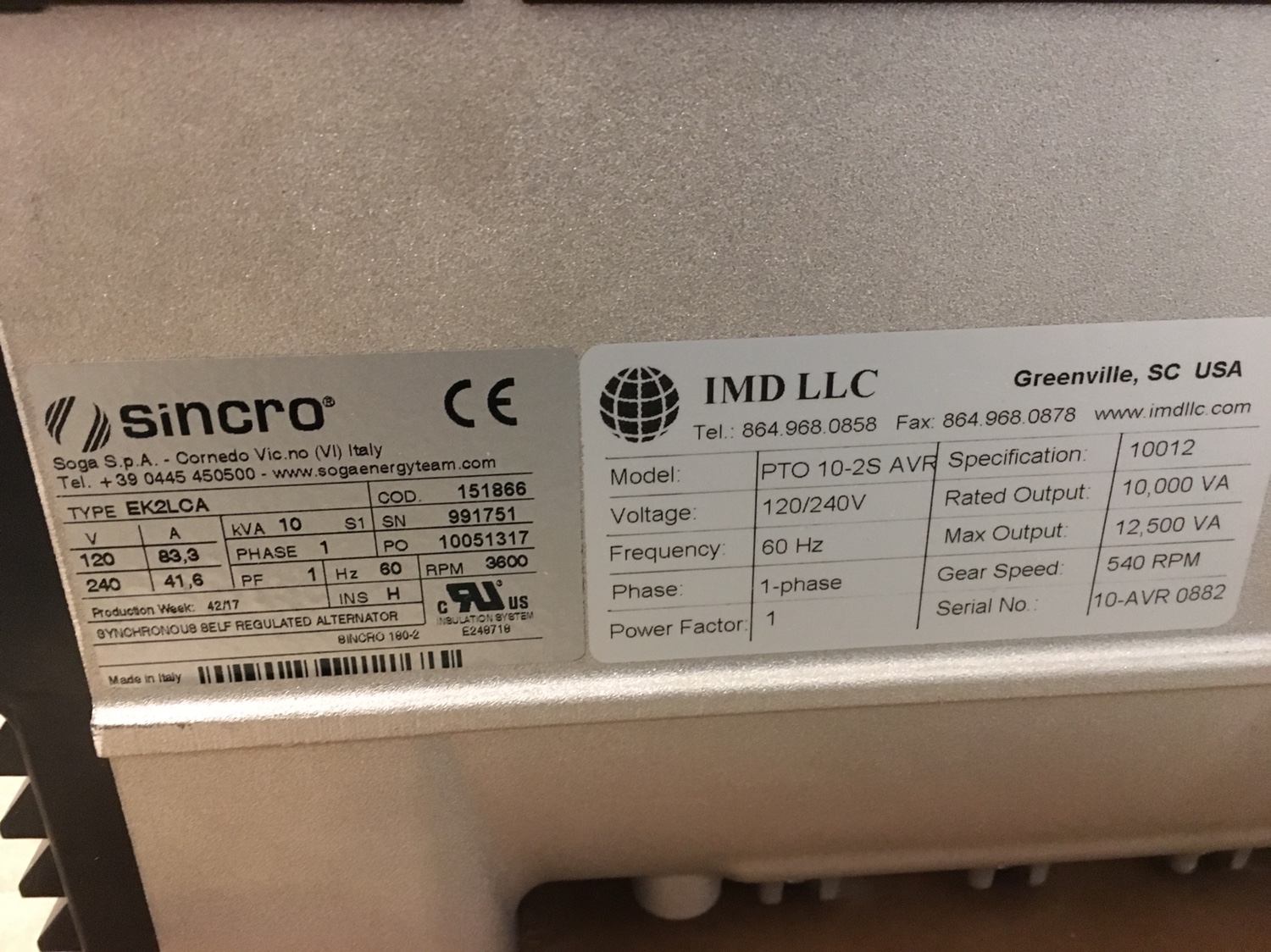

I won’t get it setup until later this month. Planning on mounting it in a hitch plate and it will mount on my 3 point hitch receiver. I will build legs on the hitch plate.
Read a lot of info and decided on the IMD brand (which is all sourced from Italian made hardware). 10kw rated, with substantial ability for spikes (my geo heat pump).
Will update once I get it up and tested! IMG_3772.JPGIMG_3774.JPGIMG_3773.JPG

That is a nice looking generator. How's the unit itself mount, can't see any lugs or feet to mount a frame to...........Mike
/ PTO Generator arrived today
they are integrated into the frame, you can see it easier in this stock photo. The 3 point mount was an extra $350. I have enough steel bits to weld my own up for about free, except I'm going to make it fit into my 3 point hitch receiver. (Easier to explain once my mind gets it welded together)15kw.jpg

Was seriously interested in upgrading my emergency power capability and this thread gave me reason to enquire so, I sent an email to IMD and asked. This is the response I got.
Ron,******
*************** Thank you for your interest in our products.
We generally recommend that you have 2 PTO horsepower for every 1 KW. So you would not be able to fully compensate for the power draw of our 10KW. You could pull about 7 KW out of any PTO generator but you could run into the issue pulling more than your tractor could handle. This could cause a drop in Hz and offset your voltage output. So it is possible to run but there is risk involved.

Pretty much confirms what I had previously discovered. Settles the issue. My Ford 1210 only has 13.5 PTO horse power. Not sufficient to safely power a 10k generator. Guess I'll stick with my Onan 4500 and be satisfied with it till the power comes back on.
