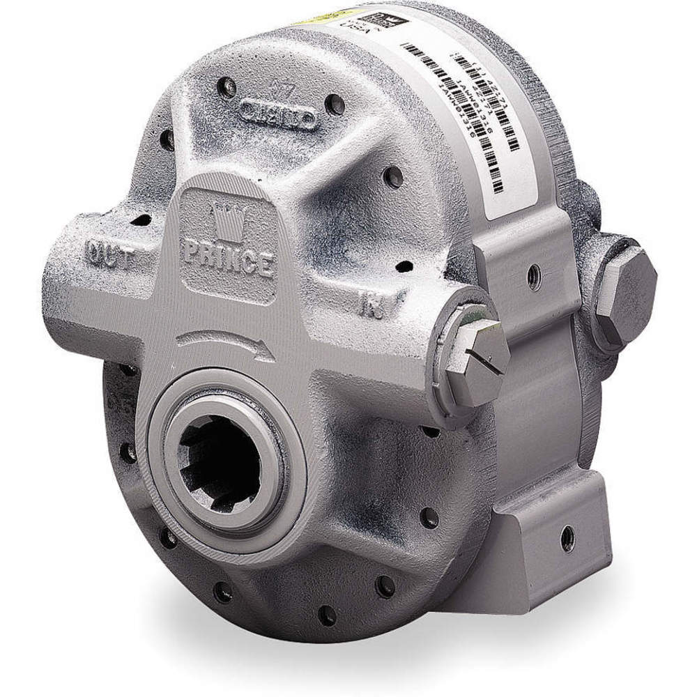

Hello ALL,
I have a rookie question. I have a Prince PTO mounted hydraulic pump for a 3pt backhoe and was wondering if this needs to be positioned upright while on the PTO shaft?
I am trying to make a torque arm setup because it didn't come with one. There was no paper work or information on the backhoe when I acquired it earlier this summer. Seems to me it wouldn't make a difference but wanted to check with some experts.

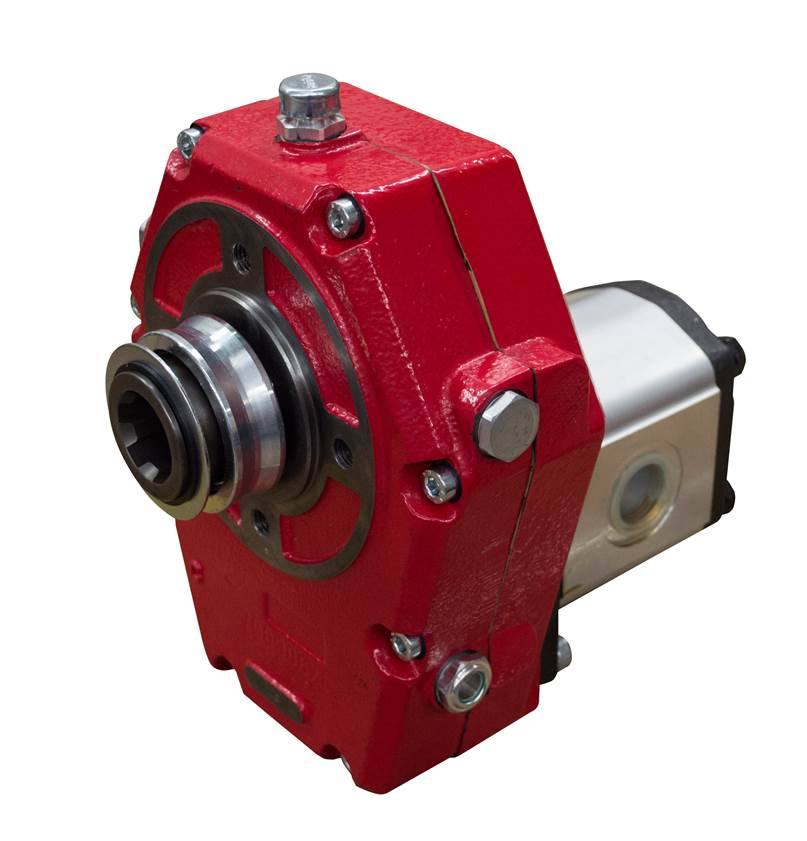

It's just a gear pump. There are no vents on pumps. As long as it's spinning the right way, it won't care if it's up or down.
Now if it was a setup like on the picture below, that would matter but you could also change the vent on the speed increaser as needed.
/ PTO gear pump mounting question #7
On the gearbox, not the pump. That is a vent on top of the gearbox and that is what needs to be at the top. Thanks for illustrating my point! That was the general question of mounting it as the pump is integral with the gearbox.
The site glass and/or plug on the side of the gearbox can be traded for the vent as well. Sorry that I was generalizing "PTO pump vent"

I believe and accordingly to the picture on the first post, the OP is using this style of PTO pump (image below) without the gearbox. The entire thing is the pump itself.
/ PTO gear pump mounting question #9
Not your question but be sure you have a good heavy arm to hold the pump from turning. Much more torque on it than a sprayer pump. No comparison on the pressure between the two.
/ PTO gear pump mounting question #10
Indeed, I believe you are right. Hard to tell from picture, but he did say it was a Prince. Your picture though does have the vent. Anyway, this pump can be mounted any position.

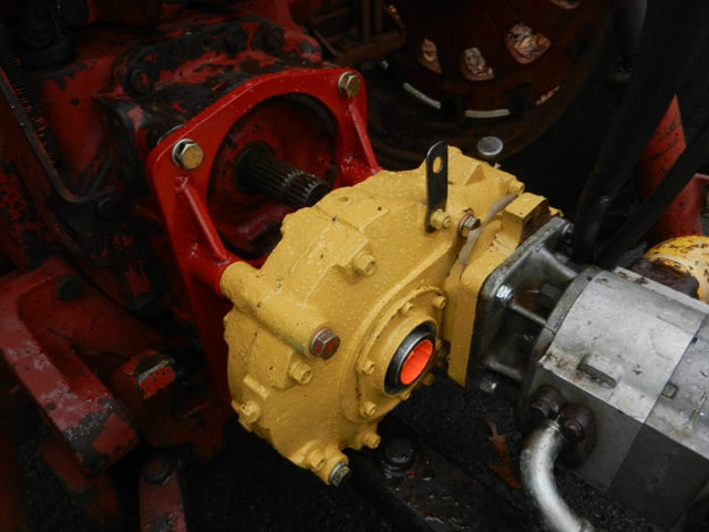

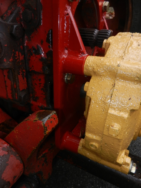

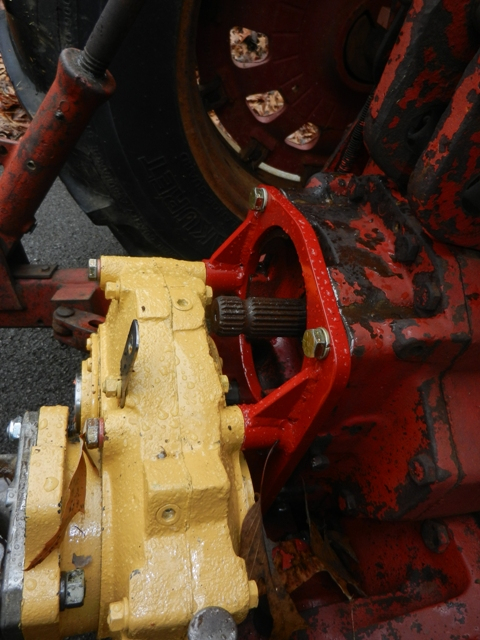

I had some bracketry made for mine. It has available, a plate that interfaces between the increaser and the tractor. I had a local friend fabricate it. 'my' increaser has a vent but, the vent as has been said, can be moved to the side by swapping the vent/plug.
(powers 15' hydraulic flexwing mower)

Does your setup (tractor) have two PTO output shafts?
