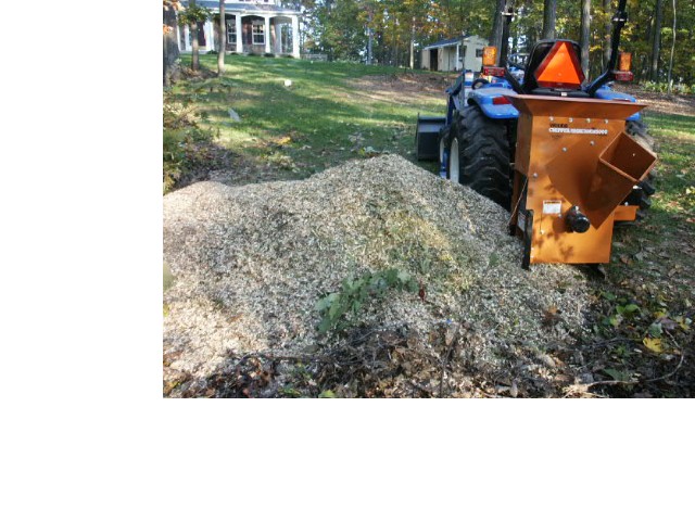

Dave,
I guess I'm a little late to the thread, but congrats. I have a Woods chipper and I am quite pleased. I have used it much more that I initially planned. My only complaint about the unit is the lack of a chute, since the chips due accumulate. Have fun, but be safe.
