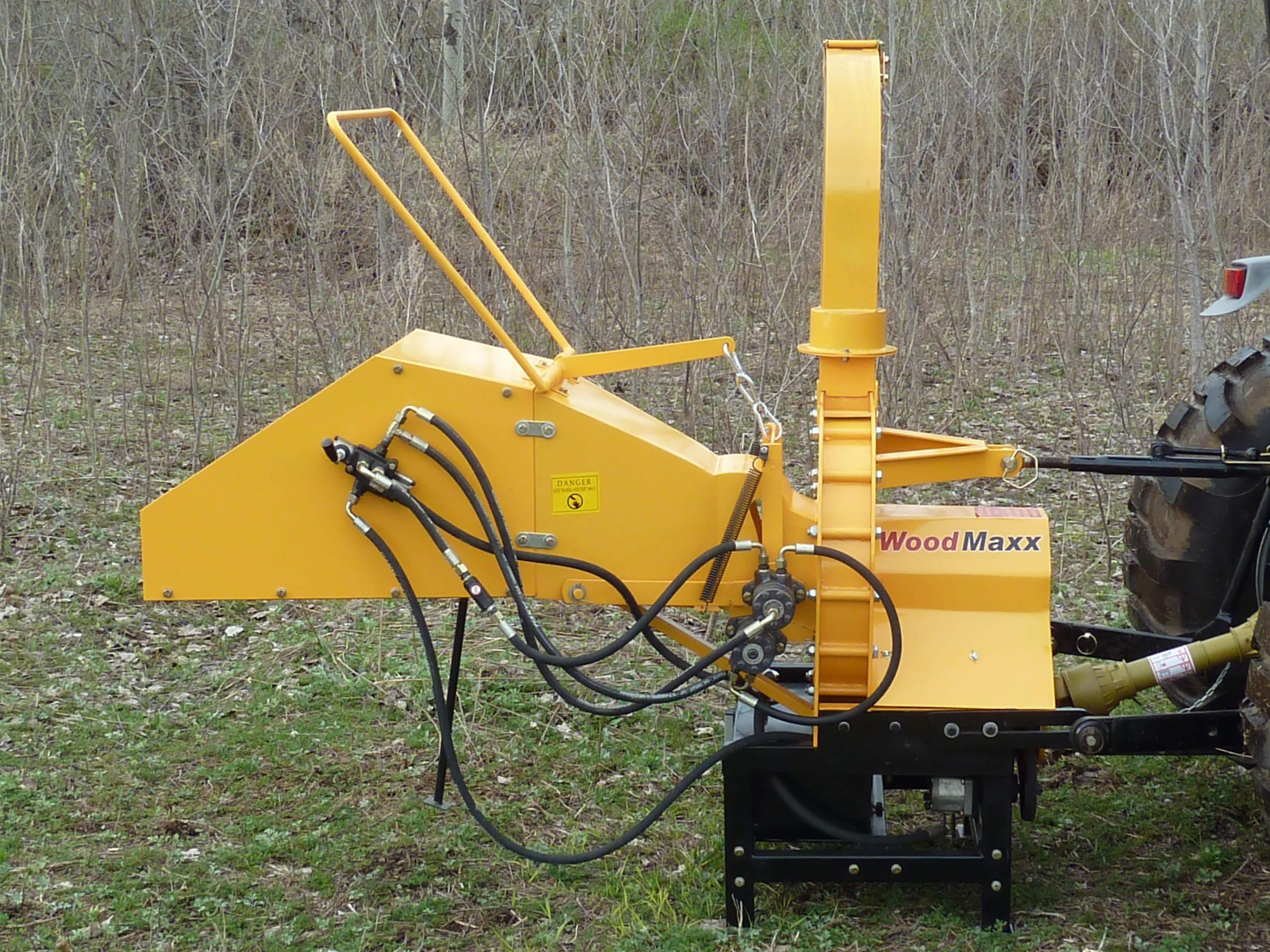

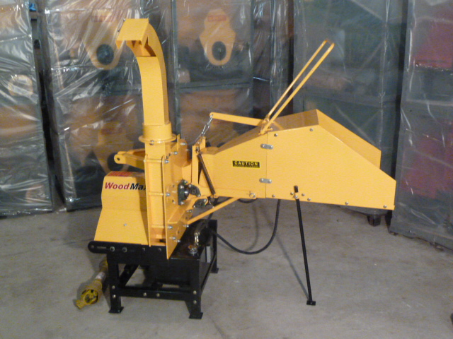

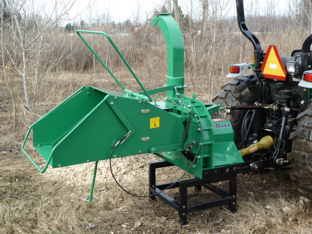

I would take your time doing the research when buying attachments. After doing your homework - you can make an educated decision. In any event - here are some pictures of the WoodMaxx Chippers, I would say price wise they are in the same range as Jinma and Liberty - but I would question the statement that this is just another "canned" machine that's imported.

The WoodMaxx WM-8H (Hydraulic Auto-Feed Chipper) still operates at 540 RPM, but with the built in hydraulic tank and pump, allows the operator to control the speed of the feed rollers from 0-28 ft/min while maintaining the constant flow of power. Also, this model allows the feed rollers to move un forward & reverse, so if you have material that gets caught up on the feed bin (ie. side branches), you can just reverse the feed rollers and then run the material right back through.
